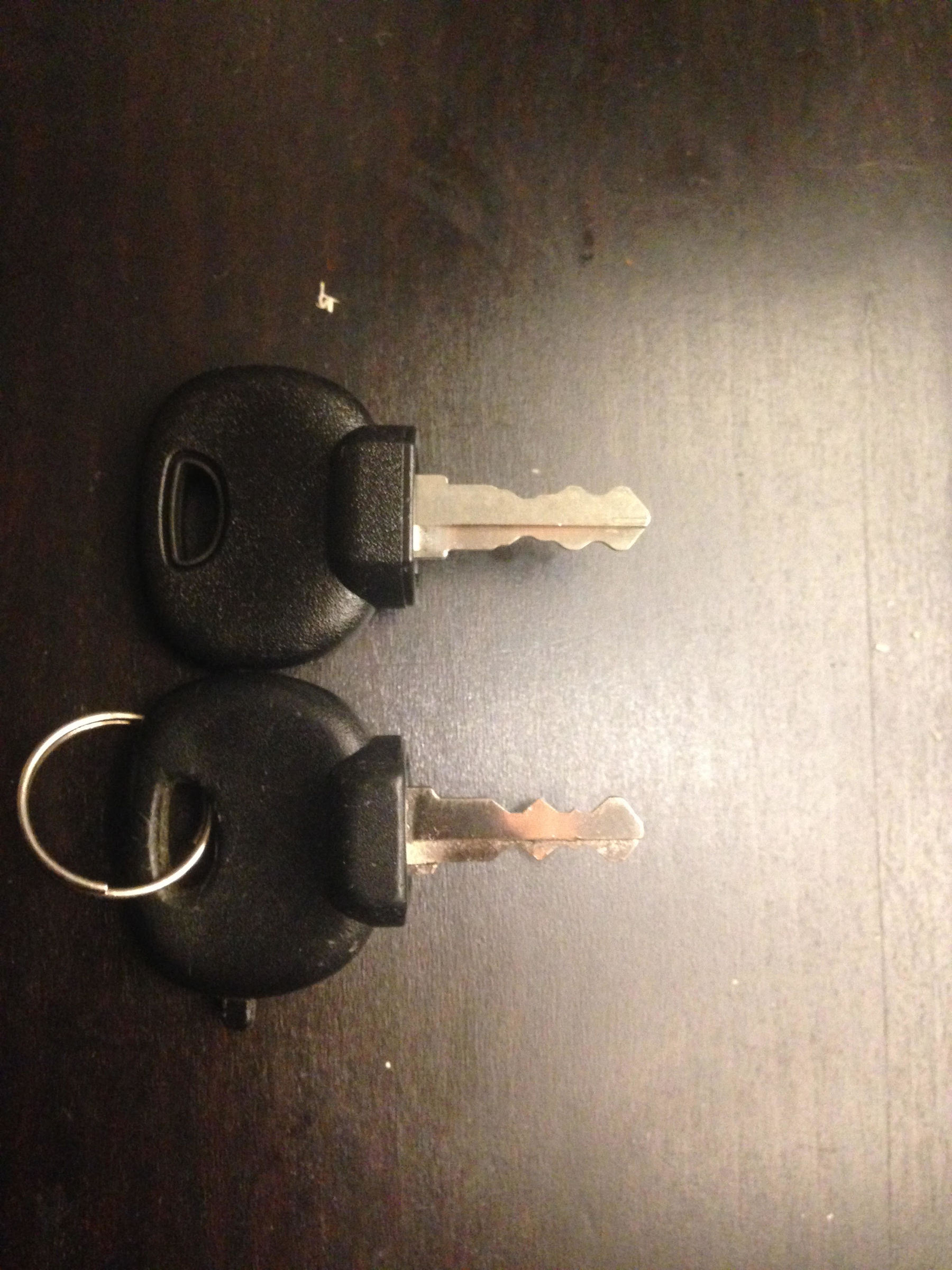

We have only one engine key, so I'm trying to get a spare incase we lose it. It's an Isuzu 35, from around 2003/4.
I bought a new Isuzu engine key from enginesplus a few weeks ago, only to find it goes in fine but doesn't turn at all. The shape is completely different to our existing one - I've attached a photo.
If you have an Isuzu, I'd be curious to know if it matches my shape or the new one which doesn't work. My key is the lower one with the split ring.

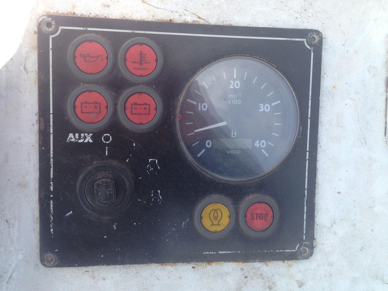

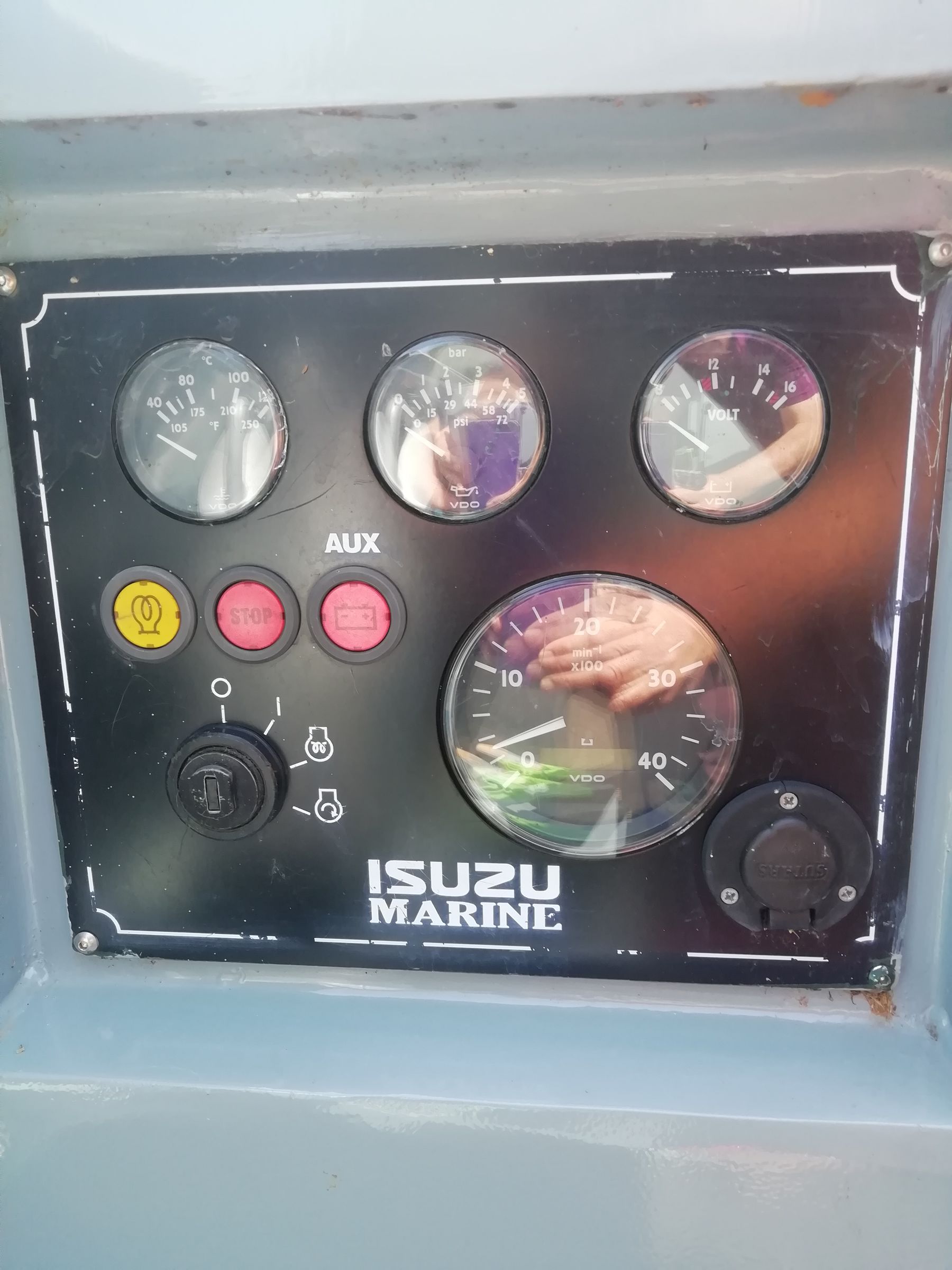

Has your boat got an Isuzu board or something else?
My Isuzu 2008 build is identical to the top key in your picture.

I hadn't thought about that!
It may not be, the logo/indicator labels are pretty worn off...
Any ideas? Photo attached of mine. It looks like (a very worn version of) this one: http://jhalfie.blogspot.com/2012/11/engine-reluctant-to-start-after-few.html

I have an Isuzu probably of 2004 or 5 vintage, and have a key like the top one in your post.  I was able to get a spare by searching for "JCB key" on ebay - there seems to be more than one type there so you may find what you are after.  Both keys pictured appear to be based on the same blank but like you I was unable to find one in local shops .

Try looking for a number where the metal of the key goes into the fob under the shroud, I've not described that very well but hopefully you understand.
My engine is a beta 38 of similar vintage to your engine and the key is stamped - 14607 which brings up this -
https://www.ebay.co.uk/itm/14607-Key-fits-JCB-Lancer-Boss-Jungheinrich-Bomag-Terex-Volvo/123989373150?hash=item1cde57b0de:g:N-4AAOSwHZhbPb6e
you can just about see the number in the photo and it looks just like the top key in your pic. If you can find your key number then you will have half a chance of finding the right one.

Good idea, I do have a code on my working key. It is '54'. Haha, doesn't help narrow the search very much but I'll keep trying!
I have now got a blank on order from Timpsons, which they think will fit, so we will see and I'll update here.

I finally got a spare key cut at Timpson's.
It isn't perfect, as I have to feel around a bit to get it in just the right place before it turns in the barrel, but it will be fine for a spare.
For anyone who is in the same situation, the blank they cut is a ERREBI MRT 1R.
