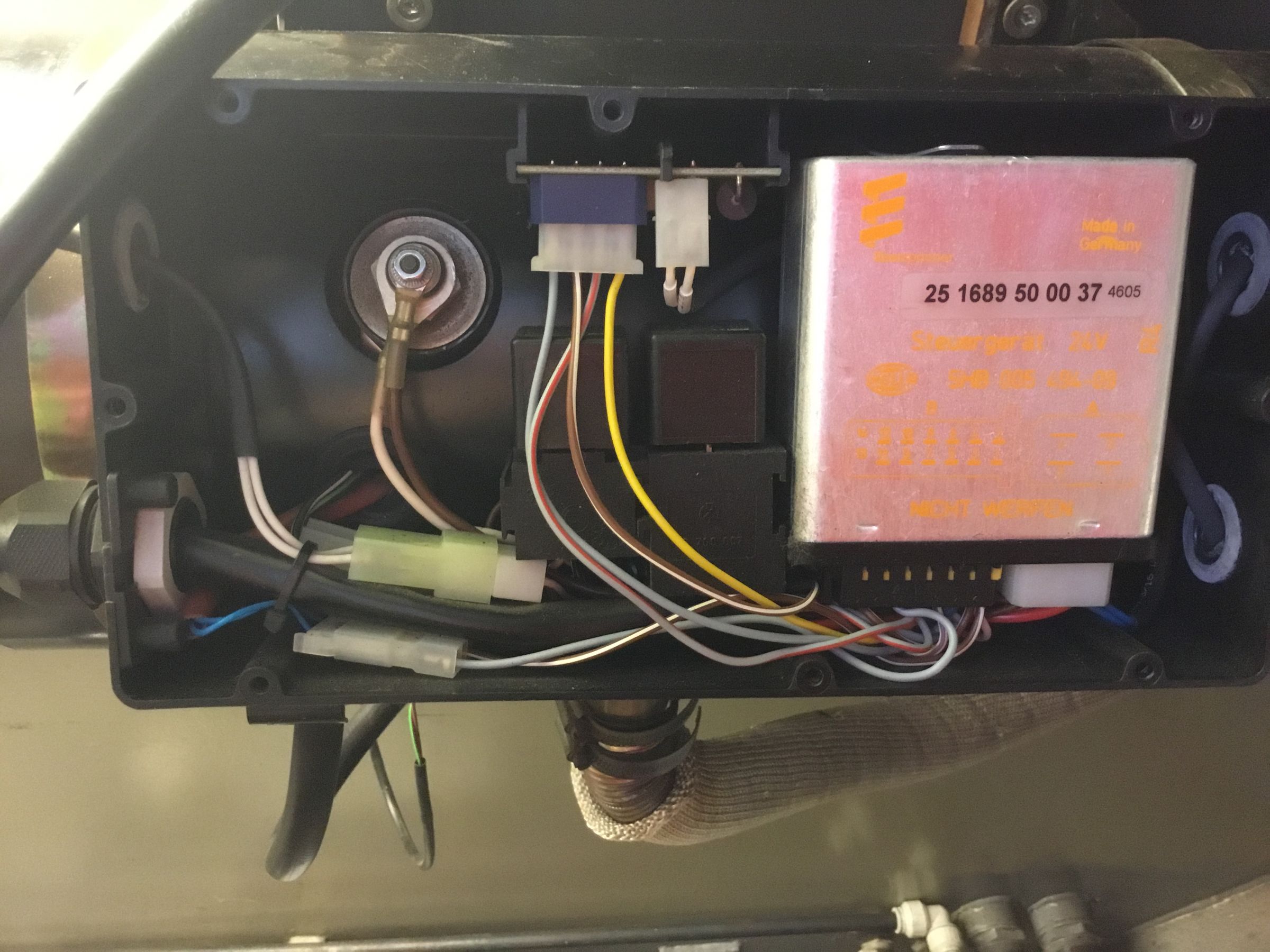

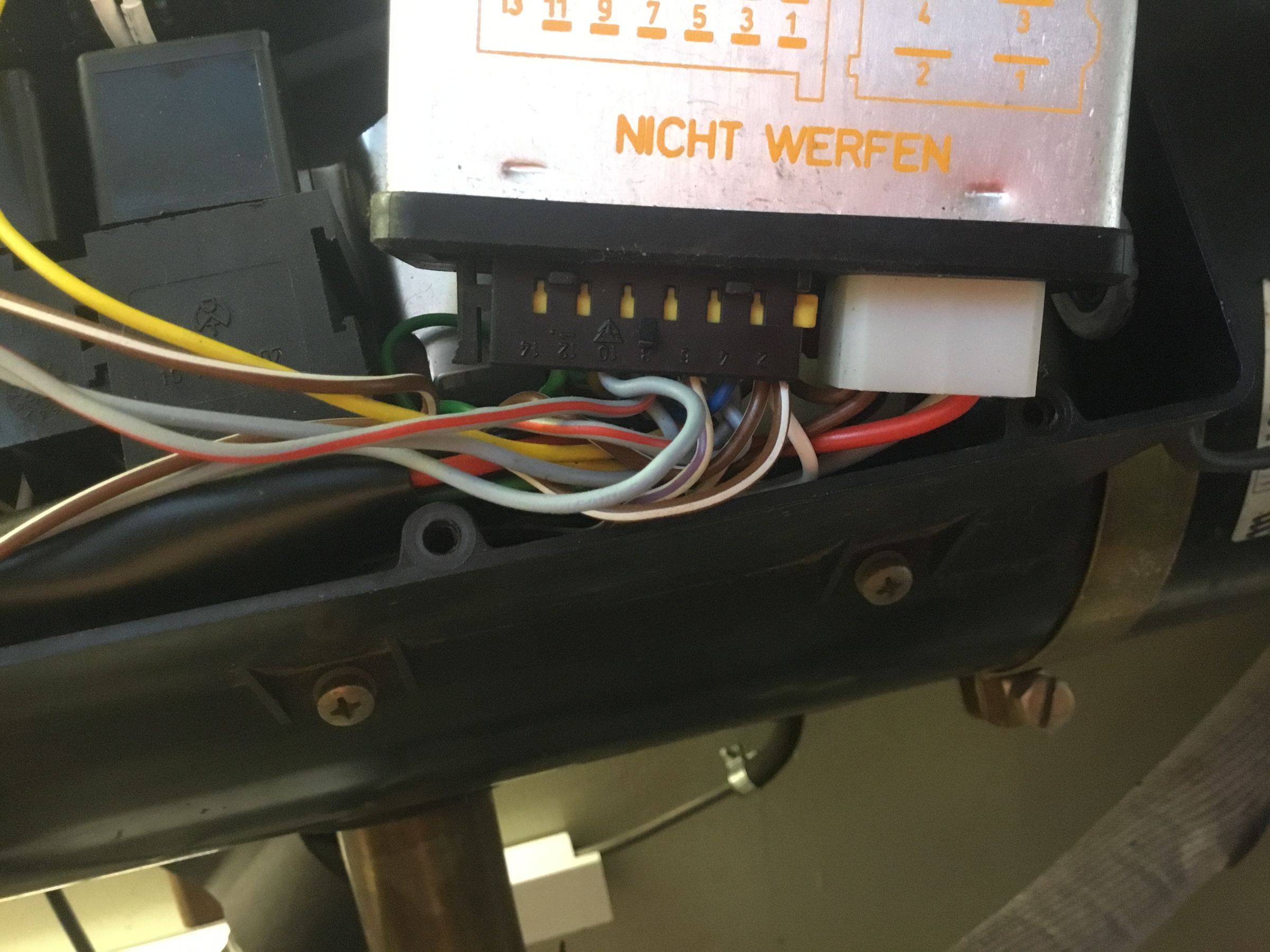

been down to see the heater again
1) showing the plug lead
others removing control box
realising how old, knackered, and how my eye site has deteriorated due to detached retina.
trying to find these jumper terminals lol
Edited by bigcol

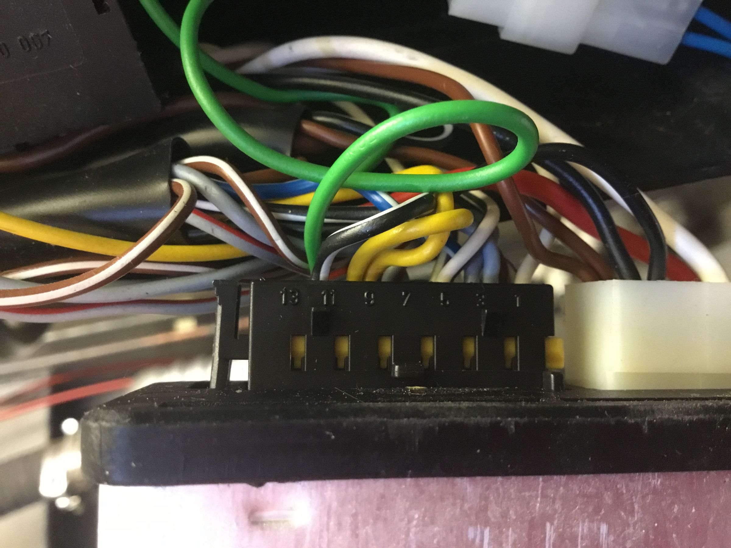

Is this what you want?
It is normal practice to poke something metallic down into the plastic moulding beside the terminal that is on the end of the cable and inside the moulding. Then connect the jump lead to the two bits of metal. Maybe strip the jump cable ends and solder them so they are stiff enough to go down the hole make contact.

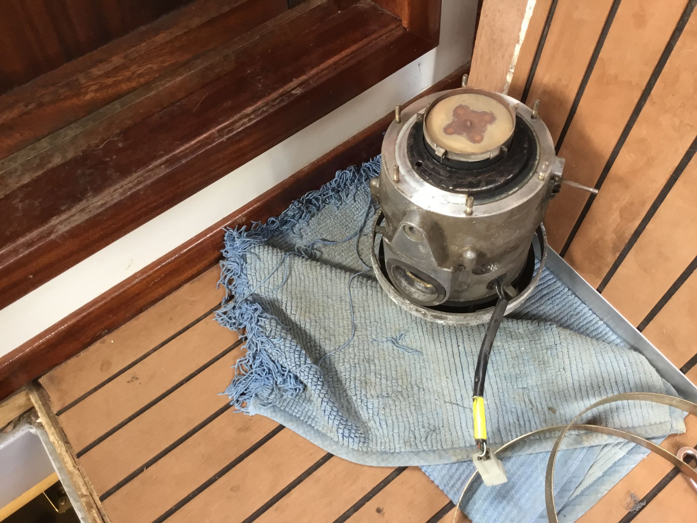

You can use that lead to test the glow plug. Simply unplug it and apply 24V to the two terminals in the plug on the end of the cable.
I have a feeling that plug on the "other end" of the cable may be a latching type with something to press, pull, or lever to allow it to be pulled out. Possibly that red band has something to do with it. Col, have a very good inspection if the plug won't just pull out. If  you can't see how it is unlocked I am afraid you will need someone who knows those connectors to tell you.
OkaY
glow plug works, seen it red and works on and off unit.

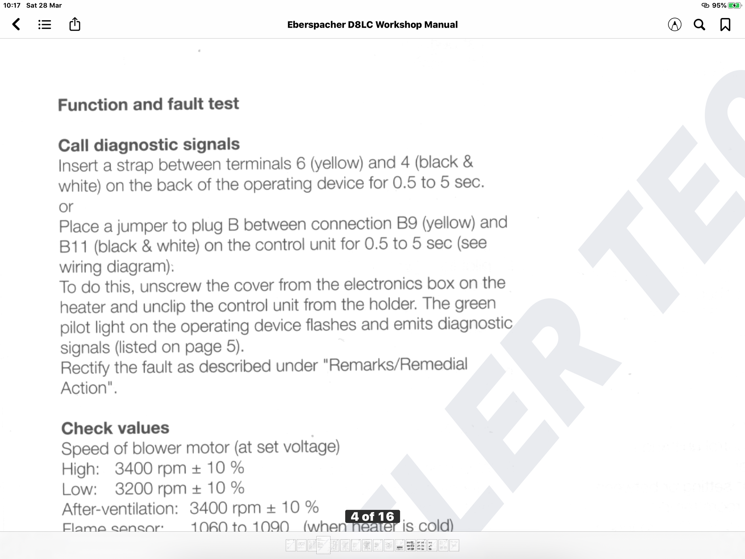

tried all ways to get diagnostics to work, done as per Tony’s photo just can’t get it to work???

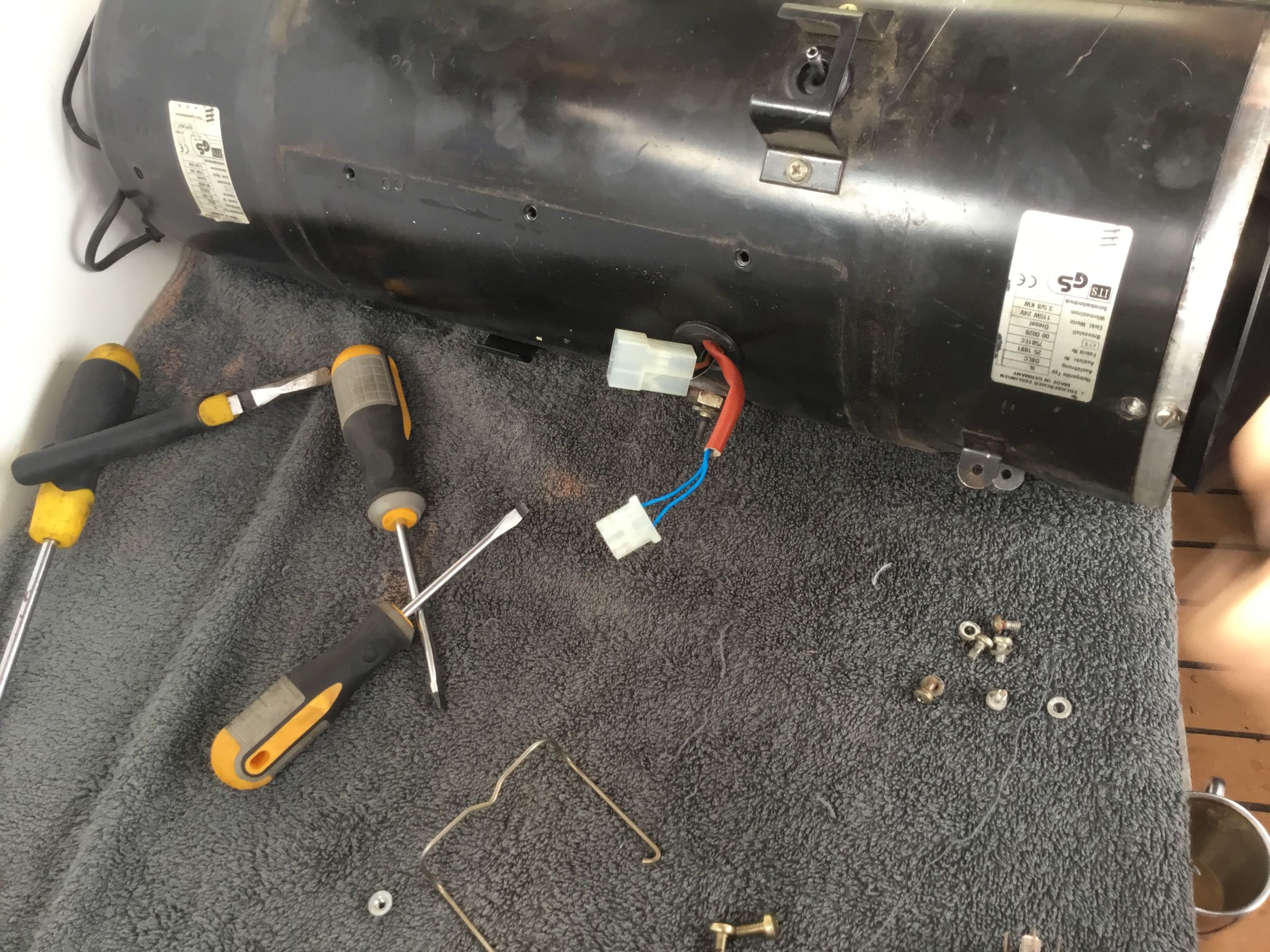

knowing that the glow plug works, tested pump  all okay.

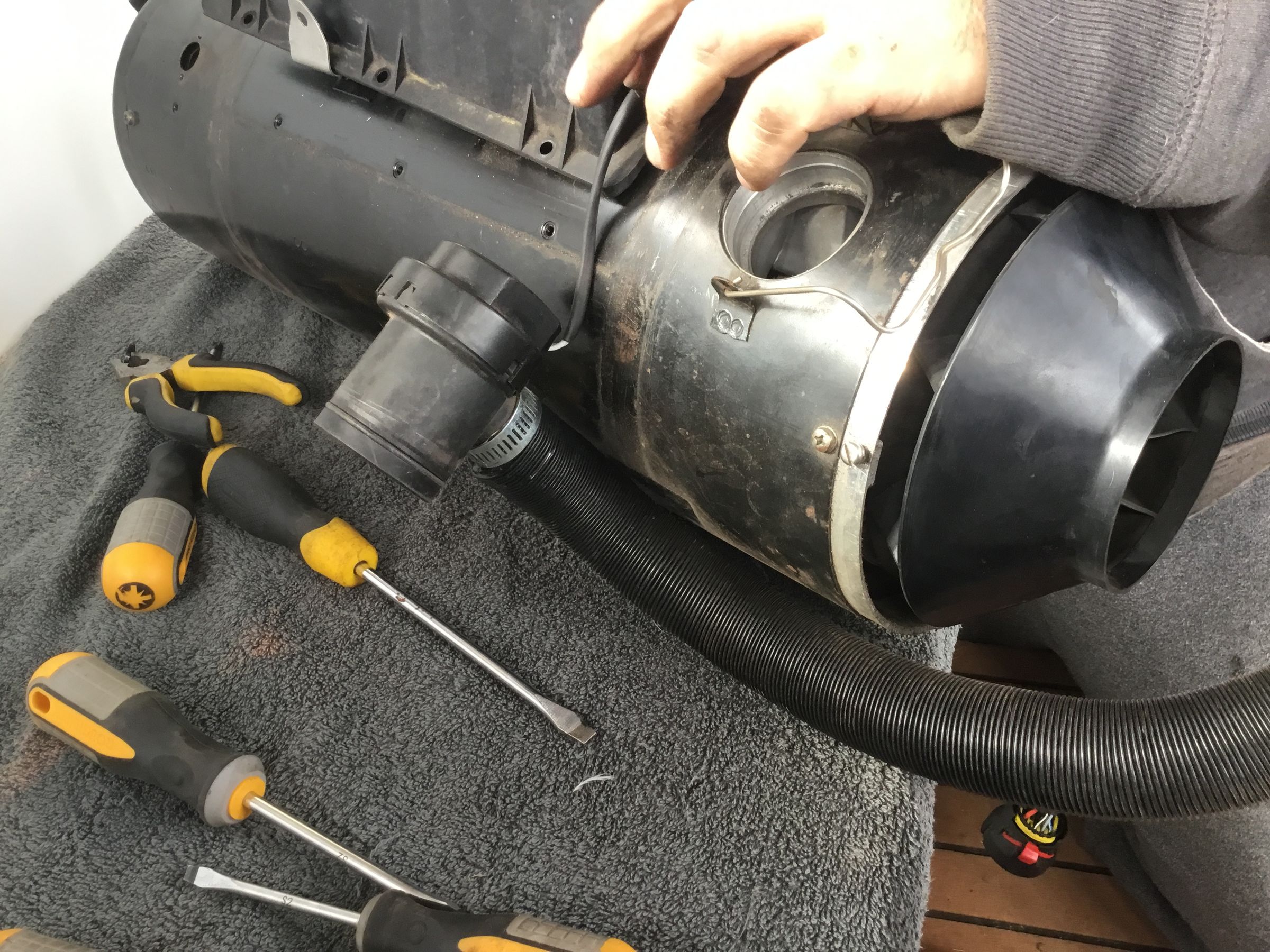

dismantled spare one, too fan motor out, just plug in the spare one and the difference , fan run big time like normal
i have the heater in bits I’m sure it’s fan motor

Just to say, a big Thankyou to all who gave me the guidance, and collective knowledge of this forum.
Including the fault finding manual.

the heater problem has still not gone away, I’ve got a spare old unit minus the blower chamber as I’ve wrecked that trying to get to the fan motor inside.
