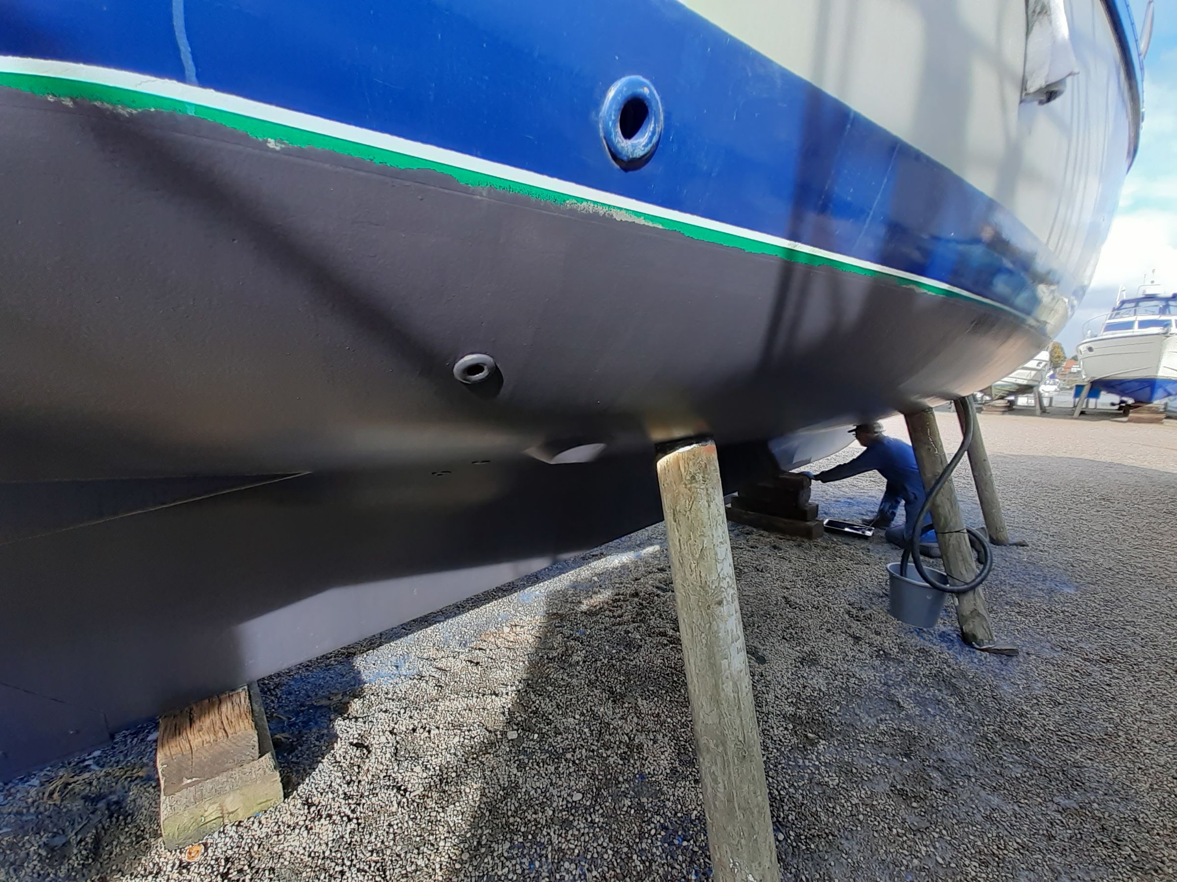

We had ours twin-pack epoxy anti-fouled in October.
Do what you can then move the supports and do the 'uncoated spots'
In your case place the supports where you can get to work on the fins.
9 minutes ago, tree monkey said:
Are supports like that normal?
To my untutored eye they look a bit optimistic
All the weight is taken in the base of the hull.
The struts at the sides just stop the boat from tipping over.
I sort of see that but it was the tipping over I was thinking about, it just doesn't look very robust
Every time I go to a lumpy water boatyard and see how the boats are propped up I wince....beer barrels & dodgy props look to be the norm...I know the boats are fibreglass but I still think the boat would win if it fell on you!!
You wouldn't believe how hard they are 'hammered in' (using a 28lb hammer). No it doesn't crack the fibreglass - fibreglass is tough stuff.
My hull is 1" thick (2"+ around the keel) and weighs 10 tonnes exactly - probably heavier than a 36 foot NB with ballast.
I have never yet seen one fall over - I guess the marinas don't want to get a reputation or an insurance history of letting boats fall over.

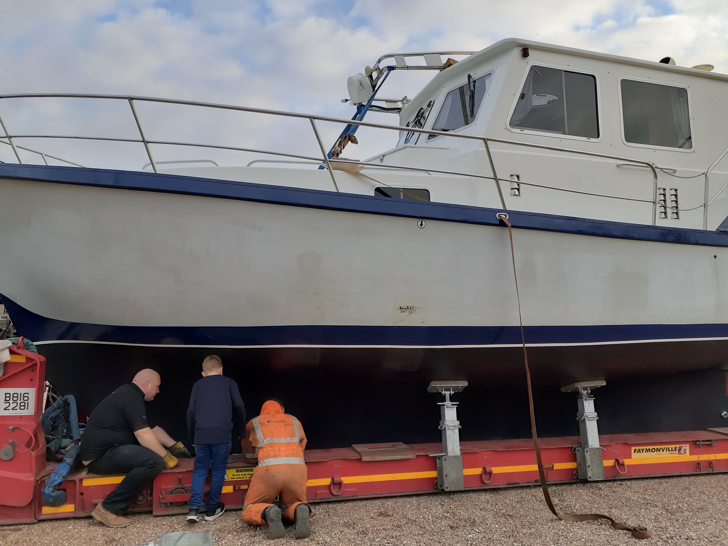

Its very similar when on the truck - it does look awfully top-heavy.
At least there looks to be some engineering involved there :)
