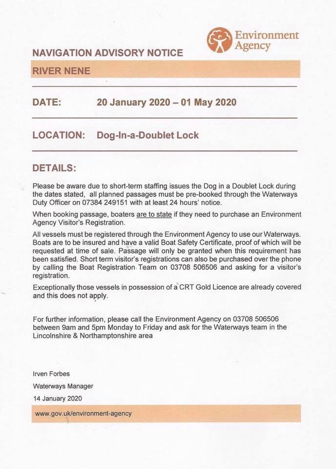

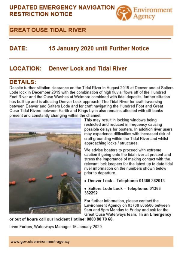

A couple of relevant EA notices - Denver and Dog.
 81689773_164906968161374_8152860320319143936_n.jpg.5a5883d7e0582e49d5d2c1882342f7f7.jpg82290688_10162971167380375_4786410450579357696_n.jpg.972a3761c7988625ea9e78c0597b84c7.jpg
I wonder if there is an hydro engineering solution to this recurring problem
