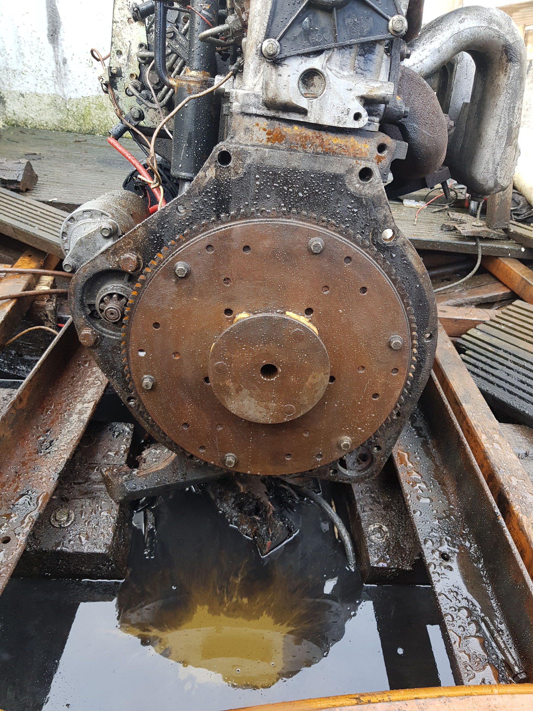

remon Posted February 8, 2019 Report Posted February 8, 2019 Hello to all the members, I am new to boats with not much experience, last summer 2018 I bought a wooden boat 25 ft with 1.5 bmc inboard but unfortunately after a few month the engine let me down a few times and I was lucky to avoid disaster not the boat is out of the water and I am in the middle of changing the engine. I manage to get hold of a good running Perkins Prima M50 now I have the problem of fitting the new engine to the current gearbox. The gear box is Newage PRM Delta20, the problem the housing on the gear box is designed for the bmc with the starter motor on the right and the Perkins starter on the left. I am updloading a few photos and any advice will help. Thanks in advance
Kingdom Isambard Brunel Posted February 9, 2019 Report Posted February 9, 2019 Delta box will not fit the Perkins, the BMC flywheel housing is part of the gearbox assembly. What's wrong with the BMC? They are easy to repair, it will be simpler than re-engineering your boat mountings to fit another engine.
john.k Posted February 9, 2019 Report Posted February 9, 2019 Its a pity you ve wasted money on a prima........find a proper Perkins like a 3/152D or a 4/203D,with a round #3 SAE housing,and a gearbox will be easily fitted.

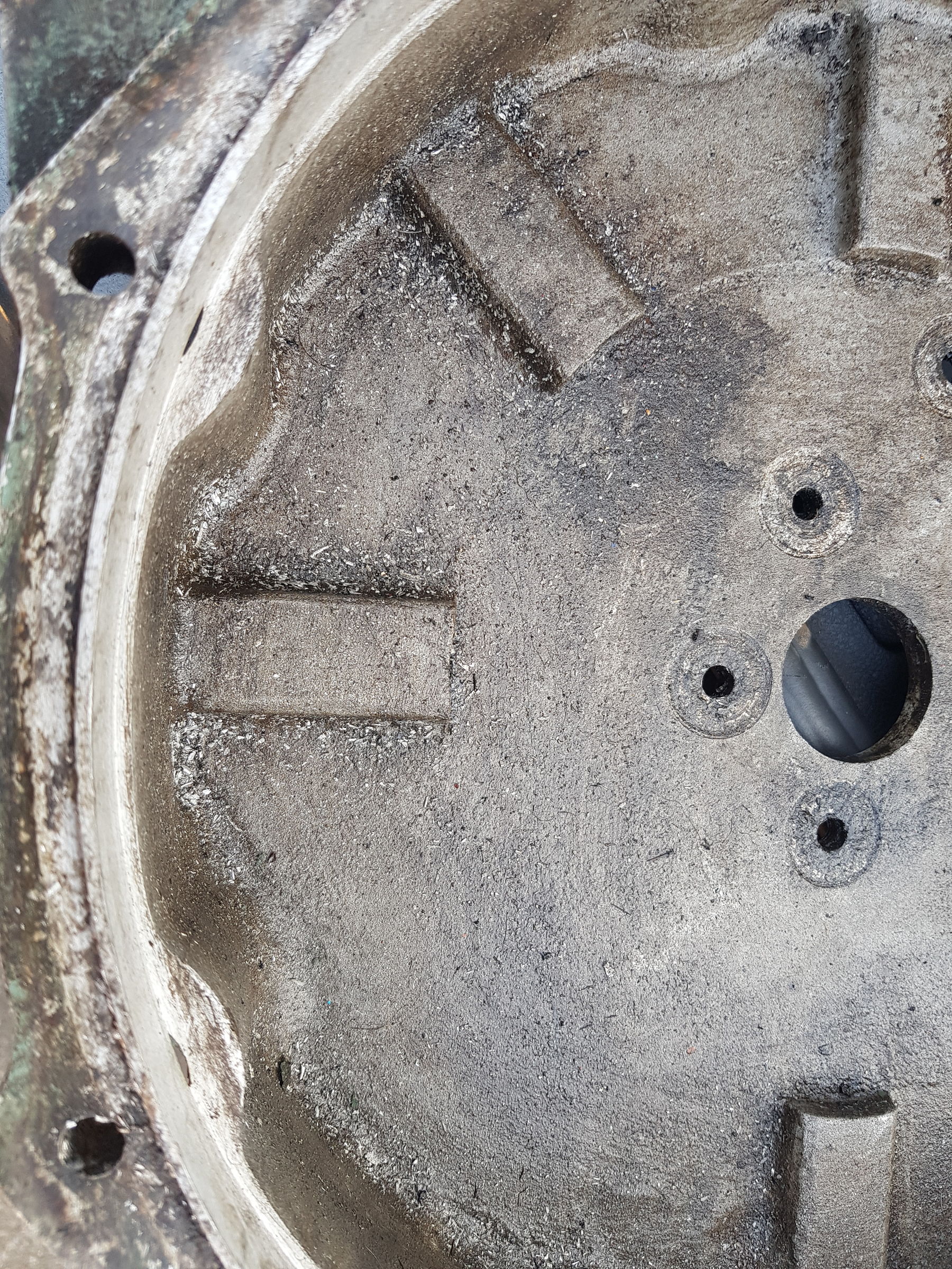

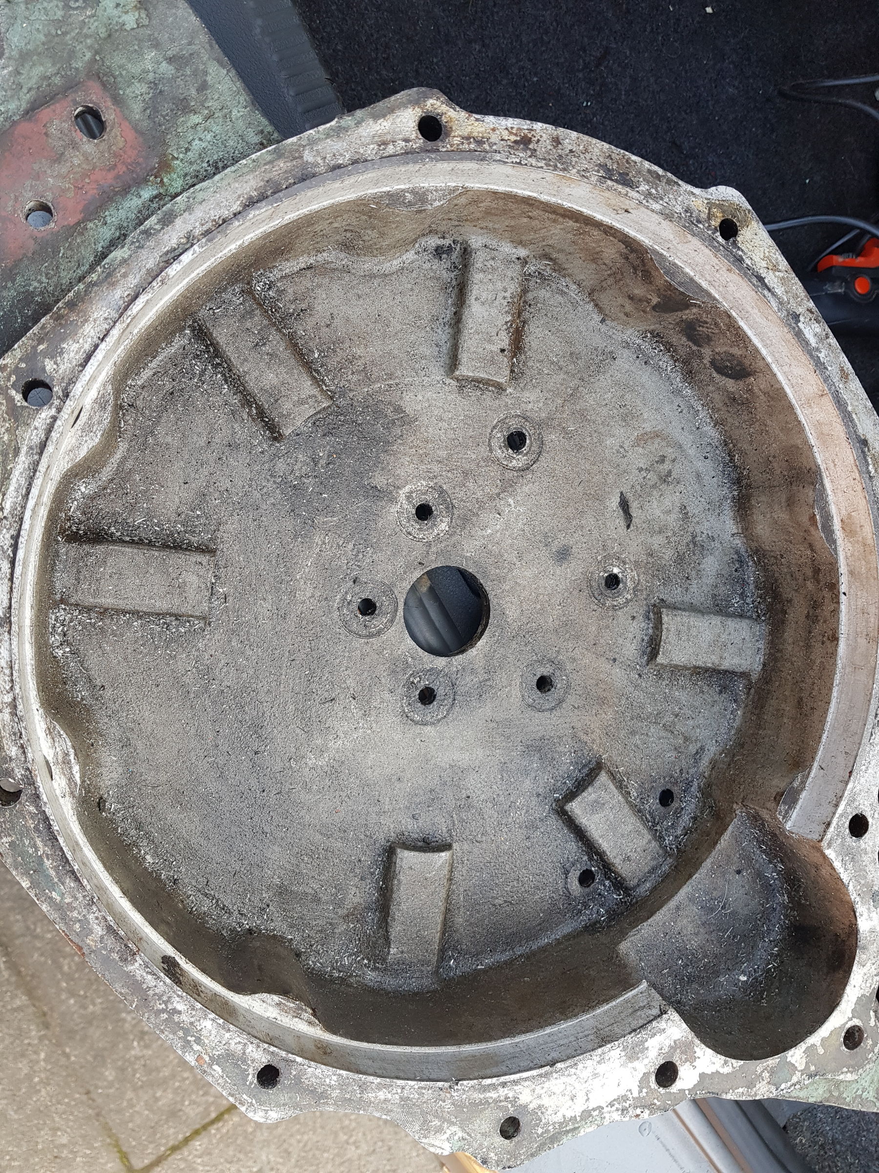

Kingdom Isambard Brunel Posted February 27, 2019 Report Posted February 27, 2019 (edited) There is still plenty of meat left in that casting, it will be fine bolted back up to the engine. The little holes matter not a damn. Now find out what the knock is in the BMC, take the sump off and check all the bearings. DO NOT mix up the caps and mark them so they go back in the same place and the same way round. Lets see the bearing journal surfaces on the crank, all 9 of them. Where is this boat located, could someone come and help you? Edited February 27, 2019 by Boater Sam added more

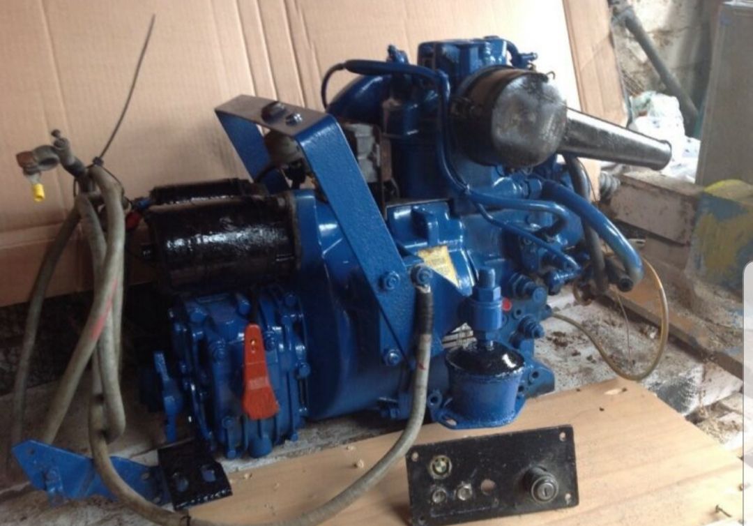

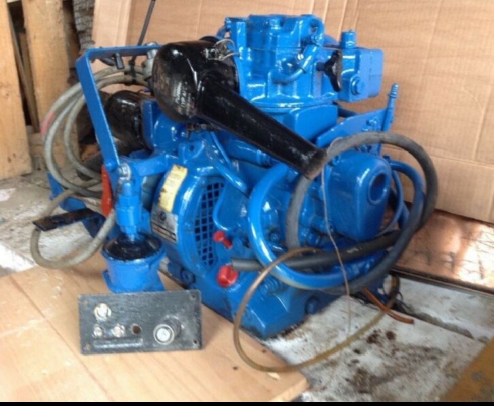

remon Posted March 21, 2019 Author Report Posted March 21, 2019 On 15/03/2019 at 14:05, billybobbooth said: as above like for like is easy as the engine bed is already setup, at 25foot most small engines around 10hp would be plenty, an 11-14 will easily move a fully loaded working boat I tried to sort another 1.5 bmc but no luck, I found this engine locally but it looks like it would be small for the boat. The guy advertise it as a BMW 7hp
Kingdom Isambard Brunel Posted March 21, 2019 Report Posted March 21, 2019 1 hour ago, remon said: I tried to sort another 1.5 bmc but no luck, I found this engine locally but it looks like it would be small for the boat. The guy advertise it as a BMW 7hp There is a BMC 1.5 with 100 hours on it after a complete rebuild on ebay. The starter and alternator will recondition at minimal cost, why are you wasting time and money buying totally unsuitable engines that would cost you a fortune to fit in your boat? Do you not understand that everything in the boat is made to fit around a specific engine and gearbox? That's cooling system, engine bearers, prop shaft the works. Its not like dropping a 1600cc engine in a 1300 Cortina.
Kingdom Isambard Brunel Posted March 21, 2019 Report Posted March 21, 2019 Look, its here, he has rebuilt it. https://www.ebay.co.uk/itm/Marine-diesel-Bmc-1-5-narrowboat-Engine/123602480713?hash=item1cc7482e49:g:7FoAAOSwdaVcQzIQ
Sea Dog Posted March 21, 2019 Report Posted March 21, 2019 5 minutes ago, Boater Sam said: Its not like dropping a 1600cc Cortina engine in a 1300 Cortina. Adjusted that for you! You're right, of course. That BMW 7hp motor makes it more like trying to fit a Morris Marina engine in a Cortina - someone might be able to do it, but a. Why? and b. What a faff for.. what?
carlt Posted March 21, 2019 Report Posted March 21, 2019 5 minutes ago, Sea Dog said: Adjusted that for you! You're right, of course. That BMW 7hp motor makes it more like trying to fit a Morris Marina engine in a Cortina - someone might be able to do it, but a. Why? and b. What a faff for.. what? It's a 25 foot clinker boat. It is a Mini not a Cortina or even a Marina. A 7hp lump would be a much nicer fit than a BMC though I'd go for a classic single or twin thumper than a modern BMW.
Kingdom Isambard Brunel Posted March 21, 2019 Report Posted March 21, 2019 16 minutes ago, carlt said: It's a 25 foot clinker boat. It is a Mini not a Cortina or even a Marina. A 7hp lump would be a much nicer fit than a BMC though I'd go for a classic single or twin thumper than a modern BMW. All perfectly correct but its a long way from just dropping in another engine and on the OPs admission he has not got a clue. How is he going to cope with building and welding engine beds in the correct place in a clinker boat? Does he understand about lining the drive and prop shafts up?
carlt Posted March 21, 2019 Report Posted March 21, 2019 6 minutes ago, Boater Sam said: All perfectly correct but its a long way from just dropping in another engine and on the OPs admission he has not got a clue. How is he going to cope with building and welding engine beds in the correct place in a clinker boat? Does he understand about lining the drive and prop shafts up? Indeed but it isn't as complicated as a metal boat and if he has no clue he will be employing someone to do the engine swap anyway. He may even save money by switching to a more appropriate engine if selling on a BMC needing work as they are usually a lot cheaper than a bigger lump, more economical to run and maintain and so much gentler on the soul.
