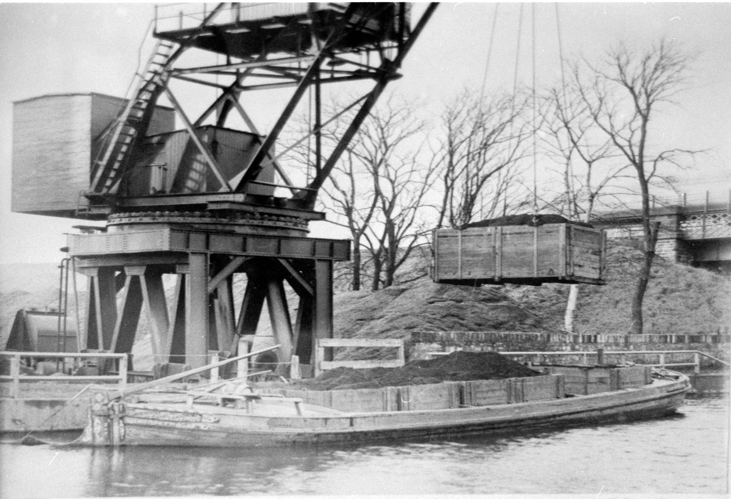

  7. Whitebirk Power Station tried boxes for coal from Wigan ion the 1930s, but gave it up as the boxes reduced the weight of coal which could be carried.

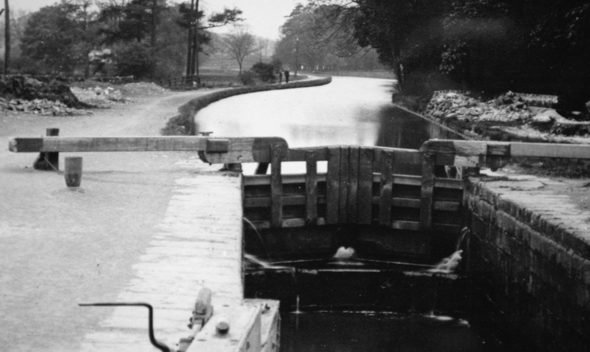

  9. The upper gates in 1977.

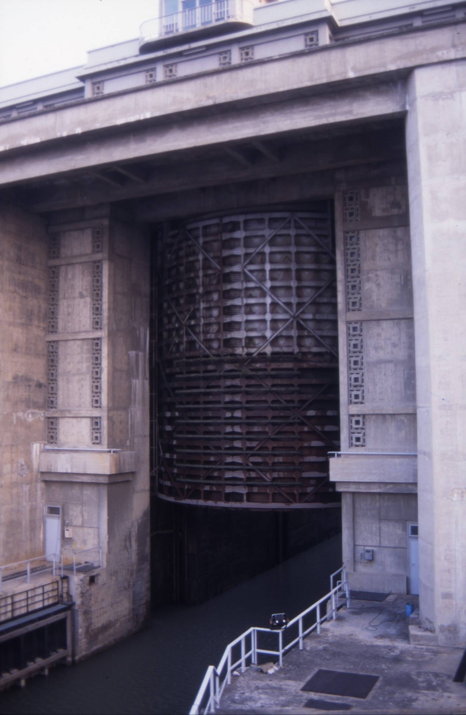

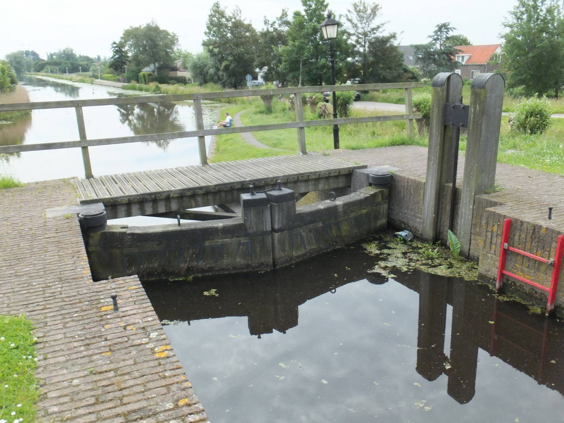

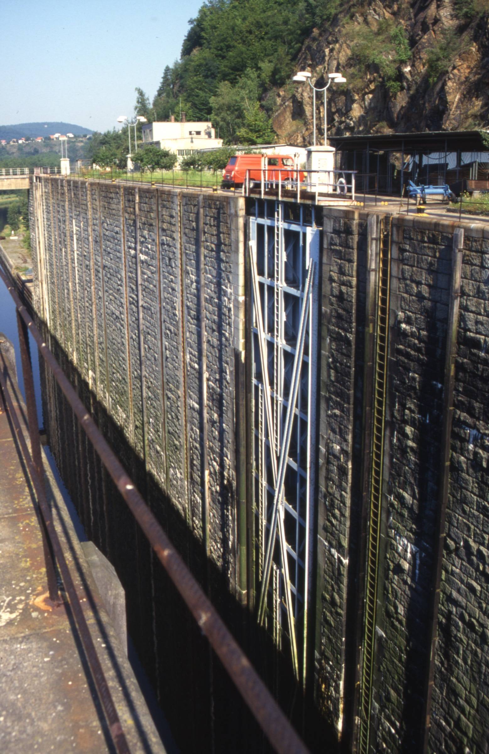

  11. It is proposed to build an incline at Slapy. Downstream, at Štěchovice, the lock at the hydro-electric station, with conventional mitre gates, overcomes 19.10 metres. Although not the deepest in The Netherlands, this lock at Berkel en Rodenrijs must be one of the deepest small locks in the country. The shallow mitre angle probably developed from locks used for flood relief and tidal barriers. The Bolléne Lock on the Rhone used to be Europe's deepest at 22m. The lock at Carrapatelo on the Douro is now the deepest, at 35m.

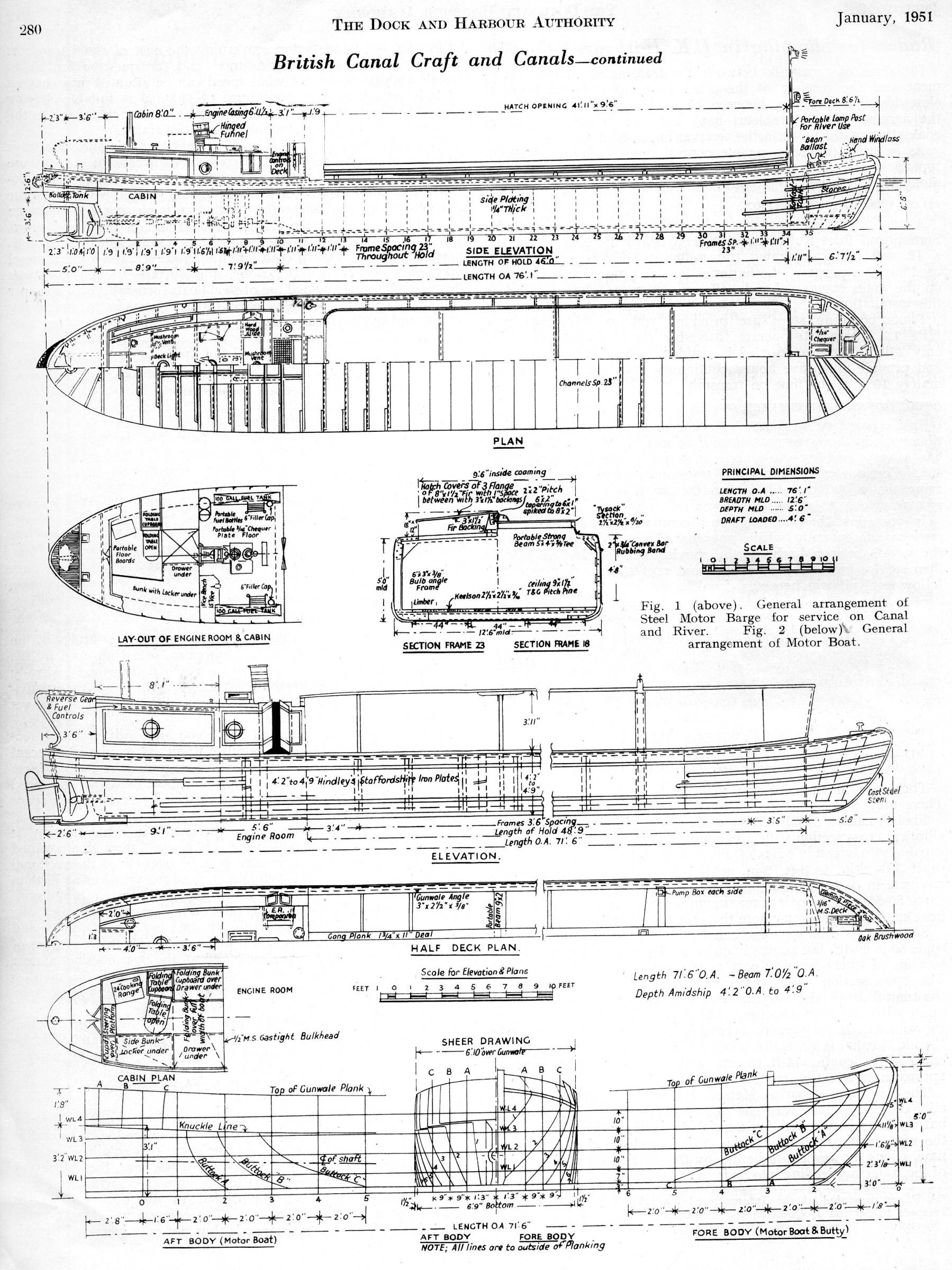

  18. Not sure if this is well known by many, but it came from a 1951 'Dock and Harbour Authority', where a paper on inland waterways given at the PIANC meeting was published. The top drawing is for a wide GU-type motor boat, with the standard narrow boat being illustrated below.

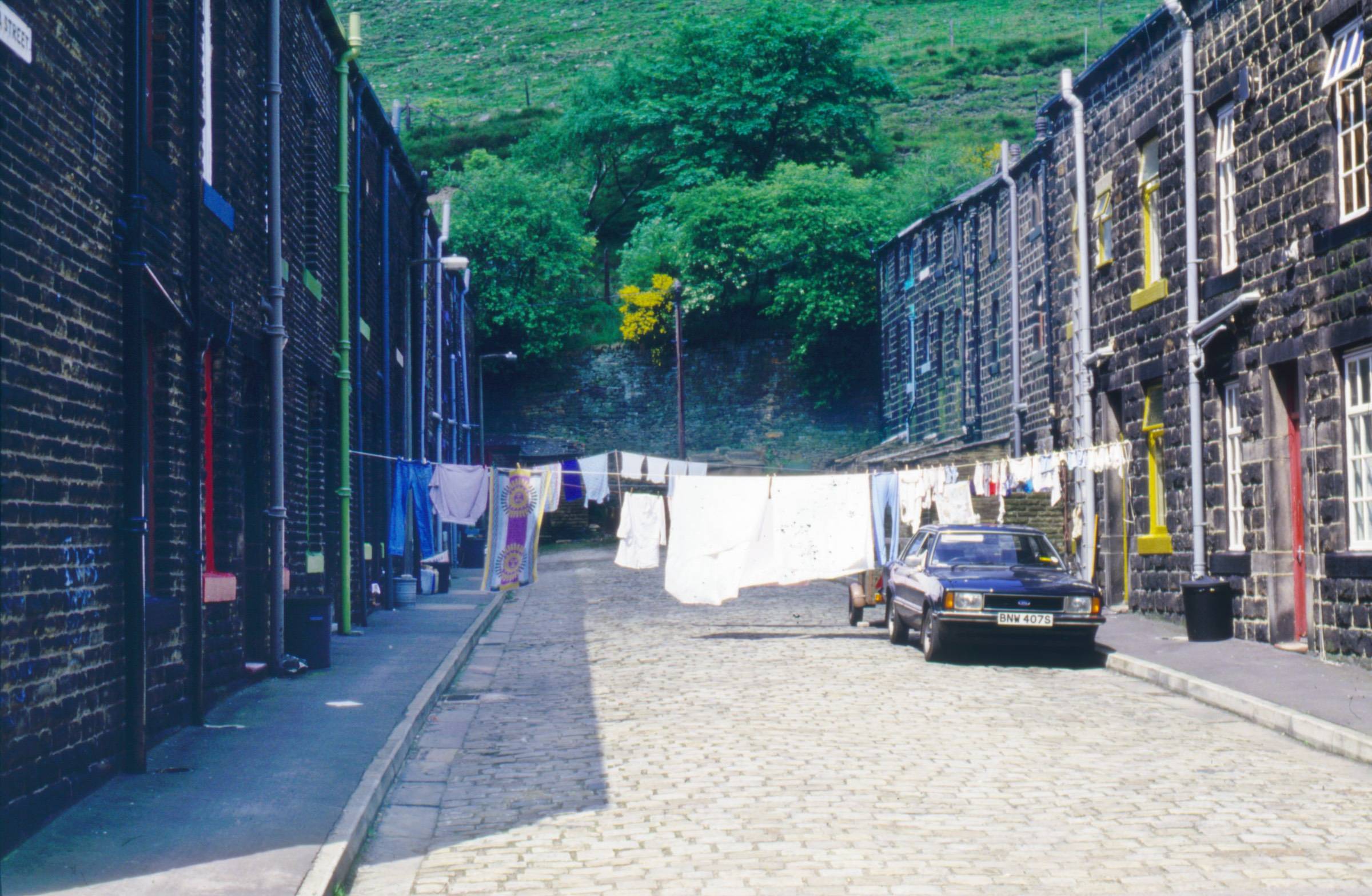

  22. There is a picture of me on my boat at 7-20, and possibly I am leaning out from by the kitchen at 5-58 when I was working on Lapwing with Charlie Atkins.

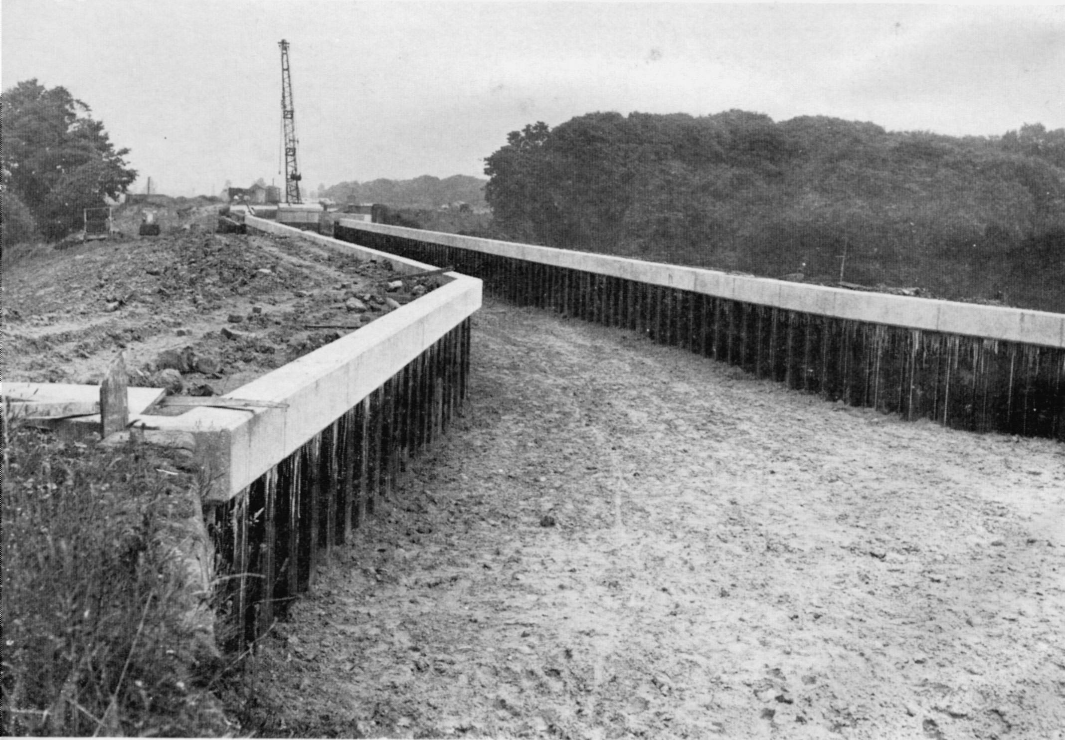

  24. The following was taken, I think, from the 1973 MSC/Bridgewater guide. Not sure what £190,000 is in modern terms. BRIDGEWATER CANAL Note on collapsed embankment crossing the River Rollin near Altrincham, August 2nd 1971, andthe major reconstruction of the canal to restore navigation. On 2nd August 1971 at about 07.20 hours the Altrincham Police received a report from two eleven year old boys thatthere was a leak from the Bridgewater Canal near the BoIlin Aqueduct. At 07.50 hours the first stop logs were inserted atAgden and by 11.30 hours stop log dams on each side of the breach had been installed and the remainder of the canalwas safe. The canal in Manchester had dropped 14 inches which was made good with water from the River Medlock by3rd August. The canal crosses the River Bollin at the site of the breach on the largest Bridgewater Canal embankment; thedifference in height between the canal and river level being thirty-four feet. The canal had washed a hole in the embankment 90 feet wide and some 20,000 cubic yards of material had been deposited in the river bed. The cause ofthe disaster will never definitely be established, but detailed discussions with the Engineering Staff of BritishWaterways Board and circumstantial evidence, leads us to believe that the cause was a complicated leachingprocess of fine sand particles from the bed of the canal which had continued over the two hundred year life of theembankment. There have been several other very similar failures of high canal embankment where the canals hadcrossed rivers. The failure no doubt resulted from slight seepage at canal bed level and special precautions have been taken to seal the canal bed of the new embankment and also to check the canal bed where the Bridgewater crosses the River Mersey. The design and reconstruction of the aqueduct and canal embankment was under the direction of Mr. Blyth the ChiefEngineer. A detailed survey and cross sections were immediately taken to establish the magnitude of the task. Indealing with an old structure it is always a problem to decide where to draw the line between repair and renewal anddifficult decisions had to be made. The Company are as yet however bearing the full cost of repairing the breach which together with the associatedcost of rebuilding Woodhouse Lane aqueduct is likely to amount to nearly £190,000. The Inland Waterways Association representing the pleasure boat owners, and other amenity interests, were veryactive in organising support for the restoration. They held a rally of seven hundred boats at Lymm in August 1972,which in spite of atrocious weather was very well attended. They hope to be able to contribute to the restorationwork. The contractors were Messrs. Harry Fairclough & Co. Ltd., of Warrington, for the main restoration and WoodhouseLane aqueduct, and Messrs. A. Monk & Co. Ltd., of Warrington rebuilt the wing wall of the Bollin aqueduct. The canal will be reopened in September, and the Company would like to place on record their appreciation of theefforts made by the contractors and the understanding shown by the canal users.
