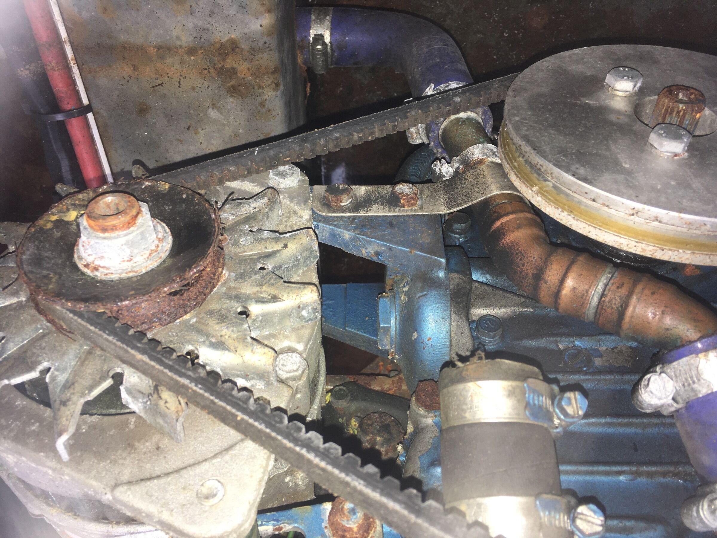

I have retained the original 50amp ND alternator on my Mitsubishi, very difficult to keep in line when adjusting the belt. Often see other engines where the front face of the boss on the engine worn to a taper; no hope of alignment once that happens. Thorneycroft and Barrus had the right idea and bolted a fabricated mount to the pto flanges.
A thick steel washer under the head of the through bolt will also help stabilise things. The legs on the alternator are thick enough in their normal use, but a bit on the thin size for this type of arrangement, hence the note on leaving the through bolt fairly tight during belt adjustment. You don't want to be trying to pull the alternator back into line using the through bolt after tensioning the belt.
Have a look at this extract from the Vetus parts manual for their Mitsubishi engine range. The front leg of the alternator is clamped directly to the front of the mounting lug on the engine by the action of the sliding bush in the rear leg acting on the spacer (3). The front leg is clamped to the engine, and the rear leg is supported by the sliding bush. The bush is roughly the shape and size of a cotton reel, and needs to be long enough to prevent the sliding bush from falling out of the rear mounting leg when the bolt is tightened. The alignment must be adjusted after the alternator is in position, adding or removing washers from behind the pulley. When tensioning the belt you need to leave the through (2) bolt just loose enough to move (with some effort) the alternator, minimising the chances of the alternator twisting on the mounting.
I'm curious, did you source an A127 with the same single bolt (pivot) mounting; or is this an improvised mounting using the far more common two bolt mounting A127? The question is of course to do with the belt and pulley alignment. A second, less common issue can caused by running a very tight belt on the usual two piece pressed metal pulley. The pulley can flex and widen whilst running and cause accelerated wear. One piece machined pulleys are available.
