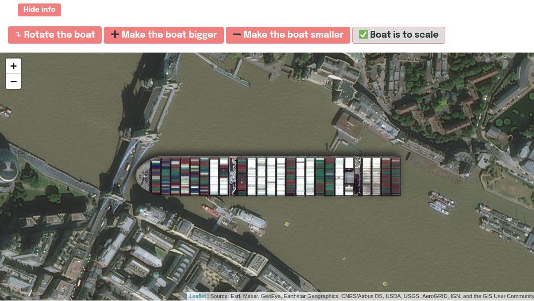

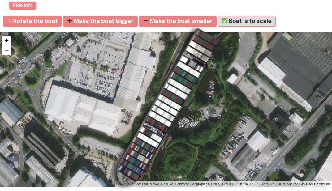

  21. There is now a web site where you can virtually get the Ever Given stuck wherever you wish. https://evergiven-everywhere.glitch.me/ Here it is failing to get through Tower Bridge. Helps to get an appreciation of its size. And stuck beside my boat!
