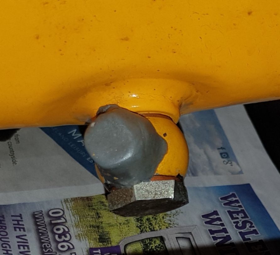

I thought of that, but I suspect the bit that fits within the banjo itself is not threaded - so it would run out of thread without making a seal. I will update when I fit a plug. Same on Amazon ... I am tempted by the magnetic version. I will definitely update with the outcome, but not until the next oil change (probably August). -

Thank you both for your very helpful responses. The current fitting is original and never removed, so the thread is fine. I will buy an M14x1.5 with copper washer and all should be good. -
Last trip we had a major oil loss, caused by the extended dipstick tube fracturing just above the banjo joint. Some metal epoxy putty from RCR and new oil/filter sent us on our way, but I need a permanent fix. Does anyone know the thread size of a normal sump plug for a Vetus 3.28? A plug from a motor factor (I'm thinking Mitsubishi?) will be much cheaper and easier to obtain than a yellow one. And I can't remove the banjo joint plug to measure it, as the next oil change is 75 hours away. I have a second dipstick, so no issues about losing one.

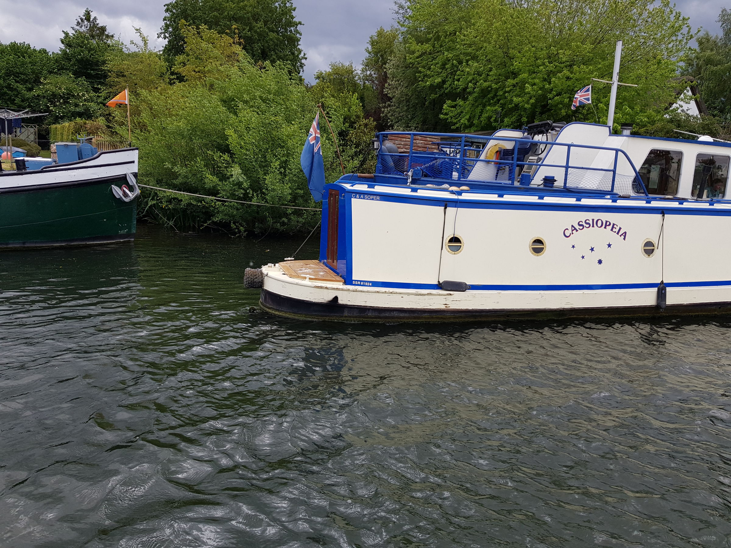

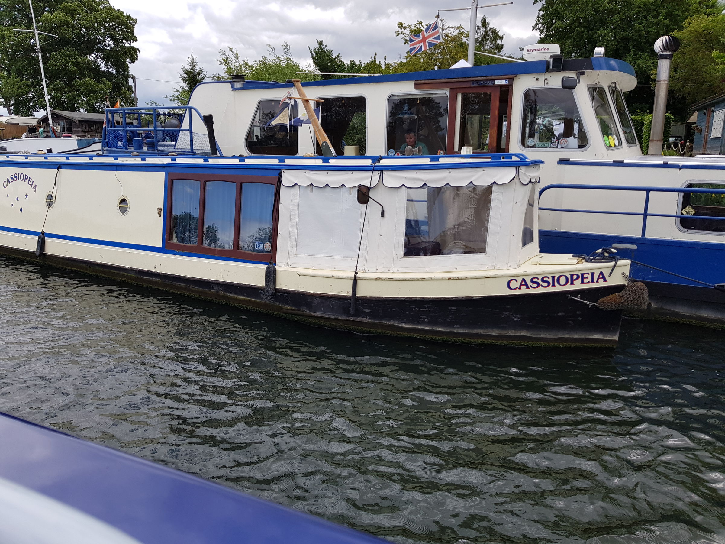

We have seen such a boat on the Thames; it is steered from the very front with a nice comfy chair. Its mooring is at Bourne End on the south bank; it is dark red and cream.
