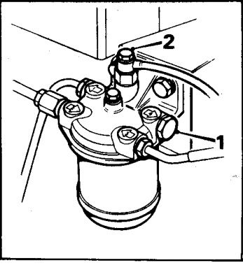

  6. You wrote "If one of these filters is between the tank" - there is only one filter. It's a standard fuel filter exactly as described in the manual provided by Calcutt, with the 2 bleed points as on this pic from the manual
  7. Reviving an old topic, but I presume there are still plenty of BMC engines around and people doing filter changes who might be reading this for reference. I was a bit scared of doing the fuel filter change from what I'd read, but it was all a lot more straightforward than I expected. I successfully bled the system without any difficulty (twice! I only found the new o rings in the bottom of the box after I'd bled it the first time ?). Two filter points as suggested above - that's two points on the one filter, I'm not sure if Tony misunderstood. Didn't need to touch anything on the pump. Didn't find a manual pump lever either and did it by cranking the engine (with the cutoff pulled out). Engine started first time afterwards, which I presume is a good sign (in any case it's now done about 10 hours running since and running as well as it ever has). If it makes any difference mine is a Calcutt conversion on a 1988 boat.
