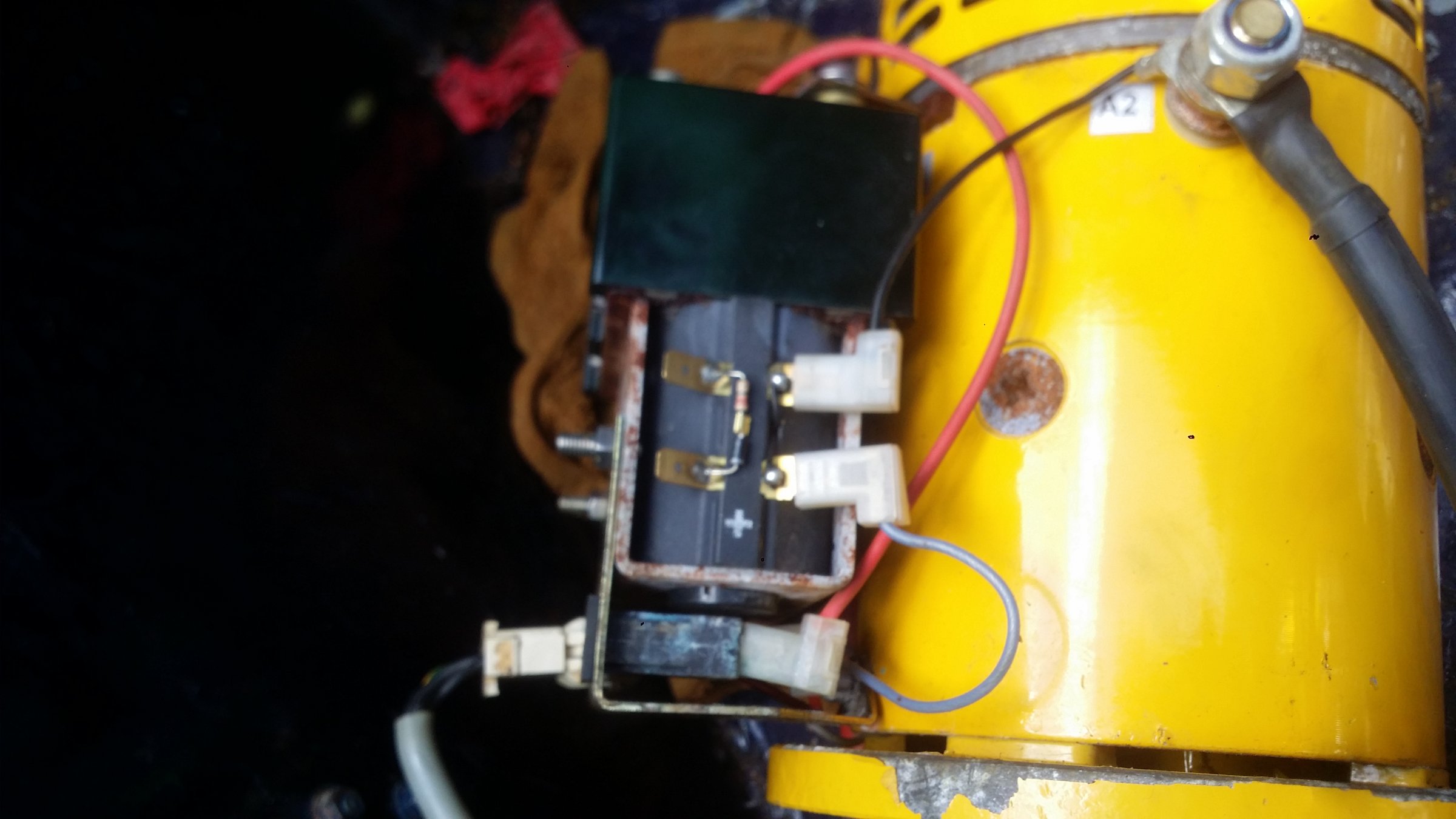

markmiller Posted June 1, 2017 Report Posted June 1, 2017 (edited) Is this black thing the contact ? Thruster wasnt working so took it to be seviced....had corroded in places. Refitted it and still didnt work . Cleaned and checked all connections...checked battery all good. Did work once for a brief push then stopped. FEW days later both sides worked but now stopped again ! Took it apart for the 100 th time....checked all brushes and cables....still not working.When i push the control panel i get a buzz and a click from the thruste but now action .....any clues to what i can do next anyone ? Oh and checked the propeler through inspection hatch....something i wouldnt do again in a hurry....got nipped by a crayfish. ANY HELP much appreciated Thanks Mark Edited June 1, 2017 by markmiller
blackrose Posted June 4, 2017 Report Posted June 4, 2017 (edited) On 2017-6-1 at 14:36, markmiller said: Took it apart for the 100 th time....checked all brushes and cables....still not working.When i push the control panel i get a buzz and a click from the thruste but now action .....any clues to what i can do next anyone ? What voltage are you getting from your BT batteries (at rest with no charge or discharge). You need to be seeing between about 12.2v - 13.6v. If they're below 12v they're not charged adequately. These are very general voltages so someone with more electrical knowledge may wish to correct me. Where are the BT batteries located? They should be close to the motor. Are they wet-lead/acid and if so have you checked the water levels recently? What sort of length and cross-section are the cables from the batteries to the motor. Mine are are 70mm2 and less than a metre long. Edited June 4, 2017 by blackrose
Murflynn Posted June 4, 2017 Report Posted June 4, 2017 Mike is correct. In my case I found the contactor couldn't hold the contact because the volts under load were inadequate. The contacts 'chattered' and burnt the mating surfaces so there was then no ability to conduct the big (400A) current required. the volts were inadequate because I didn't have a dedicated battery adjacent to the thruster. new Allbright contacts, additional battery, never looked back.
WotEver Posted June 4, 2017 Report Posted June 4, 2017 2 hours ago, blackrose said: What voltage are you getting from your BT batteries (at rest with no charge or discharge). And what voltage are you seeing across the BT batteries when the button is pressed? (obviously this will require two of you)
