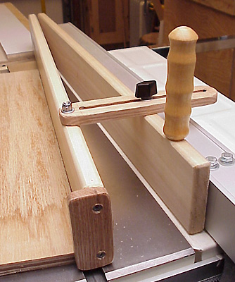

You need a taper jig for the table saw:
Once you know the angle, you can keep it set and easily rip all your planks

Scotty - that looks brilliant and may be just what I need. Of course the angle will be different for each plank, but no matter - that would do the job a treat. I'll Google that.

It's not as pretty as Scotty's but here's some plans for one:
Clicky
Oh that's clever. Probably a bit much work for a dozen planks though. Still, gonna bookmark that link as that could come in handy in future.
