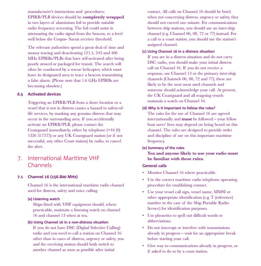

Alan,
I did my RYA SRC course in June 2016.  And you have only quoted half the RNLI statement. The full quote from the RNLI site - (http://completeguide.rnli.org/vhf-radios.htm - is as follows (I have highlighted the relevant wording:
A VHF radio will enable you to summon help by calling the Coastguard and alerting other vessels. Up until recently this was done with a mayday call on Ch16. However, the Global Maritime Distress and Safety System (GMDSS) has changed. There is no longer a legal requirement for any ship or coast station to maintain a manual watch on Ch16. The UK Coastguard and Irish Coast Guard have ceased a dedicated Ch16 headset watch and now monitor this via a wall-mounted loudspeaker. Please check with other countries if going abroad.
Instead, commercial ships and the Coastguard now monitor a special digital channel with DSC radios. To transmit a distress message on this channel you will need a DSC radio.

Alan,
Having done the course so recently I am sure it will have been explained what the phrase 'wall mounted loudspeaker monitored' means.
From the MCA :
"...a 24 hour 'loudspeaker' watch is kept by selected Coastguard co-ordination centres."
A 'loudspeaker watch' also means that a call on C16 could be missed as the operators will have their ear-phones on monitoring other radio traffic. It relies on someone else being in the room, on watch, and hearing the call. It is not guaranteed that the CG will respond.
Edited by Alan de Enfield
Alan, Please elucidate. Sounds self explanatory to me?
