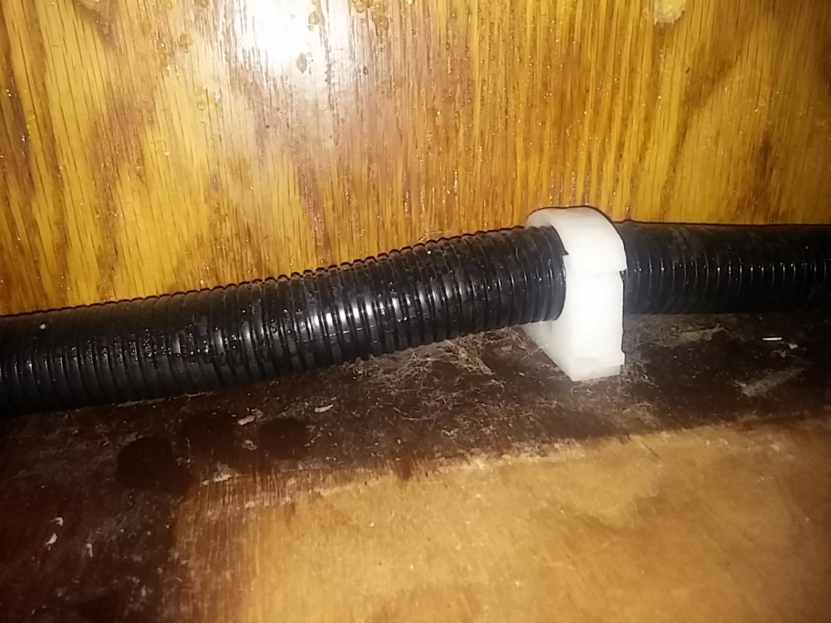

That's bow thruster cables running along the floor with dampness underneath. The wall is also wet at the bottom but isn't as noticeable in the picture above.

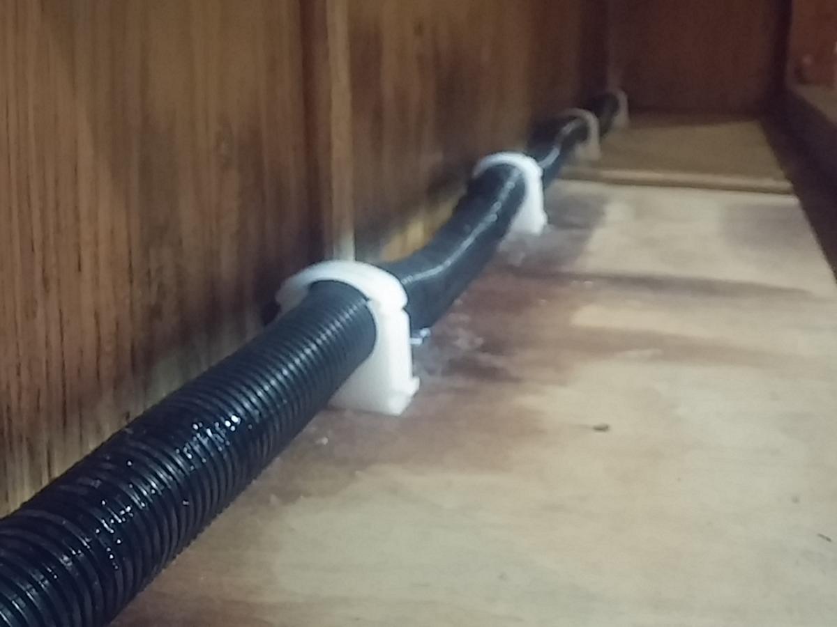

Here's another one.

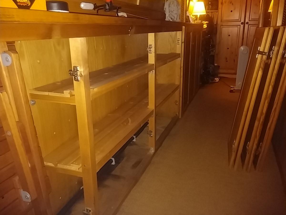

I've taken all the doors off and will let it dry out over the next few days. It's just wet at the bottom of the cupboards. Completely dry further up the walls. I guess the bottom is where it gets cold + lack of ventilation because they were stuffed full of gear + warm air from the stove = condensation which I hadn't noticed because the cupboards are used for storage rather than stuff that gets regularly used.
In future I'll just use the cupboard shelves and leave the bottom clear so at least any condensation can dry out on its own.

A long shot, but that moisture looks as if it could be coming from the trunking. The worst of the dampness seems to be coming from an area just below where the trunking sags down slightly as shown in the second picture. This would create a sump where water could collect. Is there any possibility that water is finding its way into the trunking?
Blackrose, the problem to me looking at the picture is, doors sealed to the floor = no air flow, I think that's your problem.
Yes, that's it. With the doors off it's drying out already. I've just been down on the floor looking at it and I can feel really good low level airflow along the corridor, so I need to ventilate the doors.
The moisture may be finding its way into the trunking, but it's not coming from the trunking. How could that be?
Edit: Just checked - there is no moisture inside the trunking.
The trunking could be stopping what little ventilation their is from flowing over the area.
