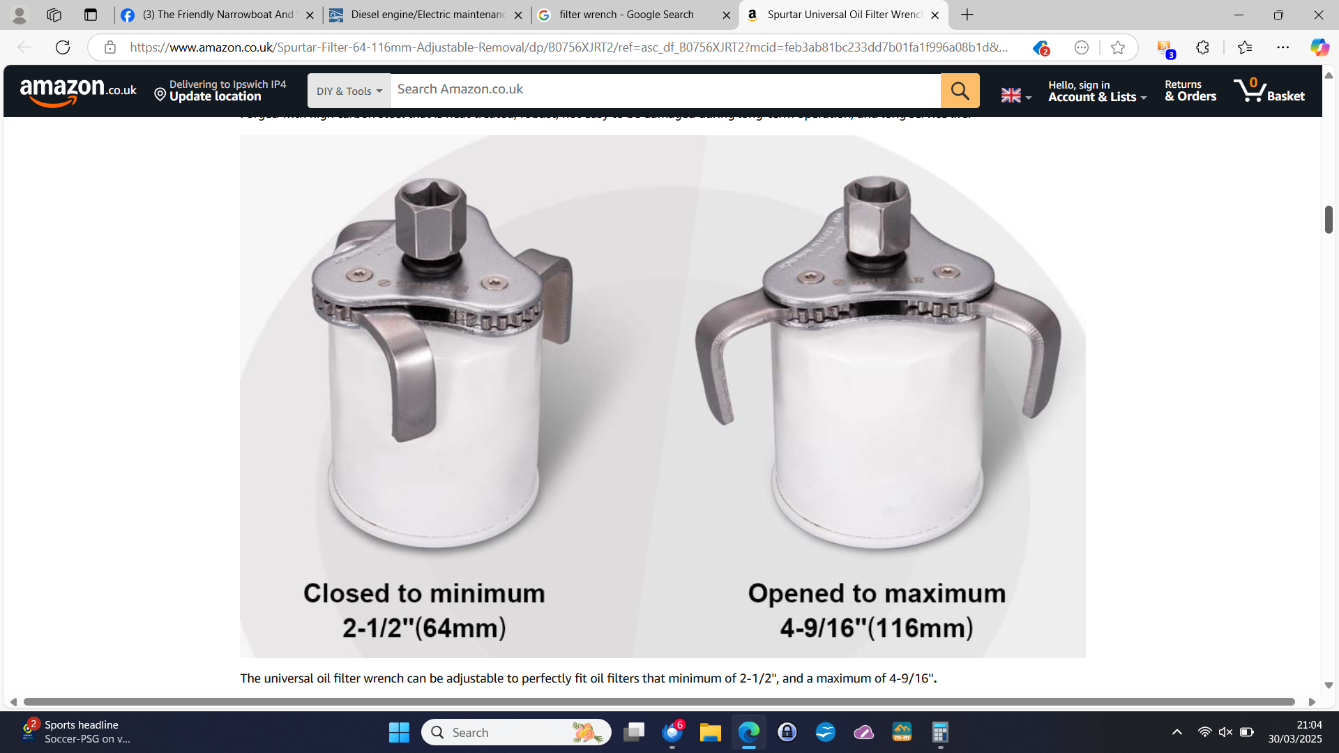

So what have you been trying to change with the claw wrench
That would be the fuel filter!

I find the strap wrenches like the metal one linked to in the topic tend to be the most versatile and easiest to use, as long as you put it around the part of the filter canister that is shaped, either grooved or formed into a hexagon. Usually at the bottom of the filter.
