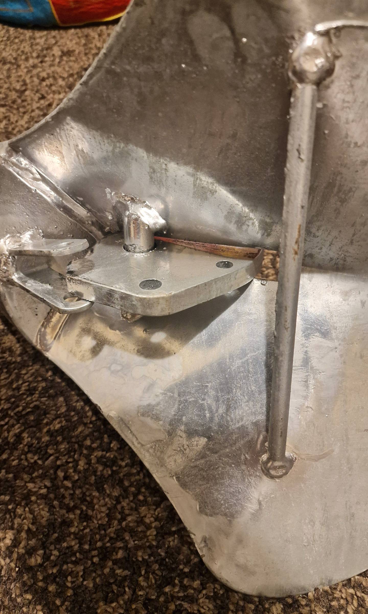

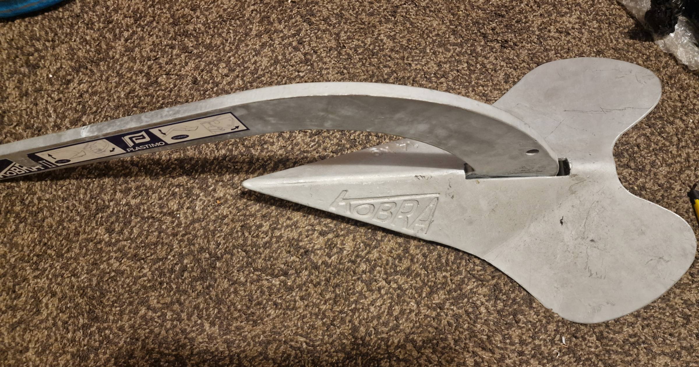

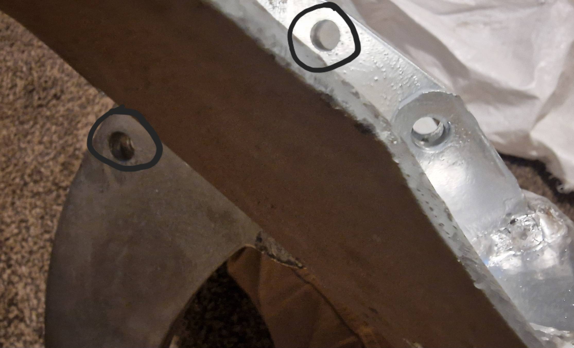

NapoleonDynamite Posted January 10 Report Posted January 10 Bought a Kobra II 14 kg anchor for a 60' narrowboat, it hasn't come with the shank bolt, is that usual, am I supposed to source something suitable? Also the photo above showing the welds on the underside, is that normal? Cheers all. Also, theres 3 holes in the anchor, I've lined the one up that the bolt goes through, what are the other 2 for?
LadyG Posted January 10 Report Posted January 10 Best have a look on their website, is it second hand?
Alan de Enfield Posted January 10 Report Posted January 10 (edited) The different bolt holes are to alter the setting angle to make it suitable for different 'bottoms' (sand, gravel, rock, weed etc etc) The hole above the anchor is to attach the trip-line, From memory one adjustment is 30 degees and the other 45 degrees. There is a lot of good info online - look at the manufacturers website or chandlery website. The folding version was altered and only available on the under 10kg anchors as testing showed the Kobra adjustability was found to be a weakness with heavier boats. The folding version : My Kobra II (note the II on the stock) My kedge anchor is a Bugel, and the spare anchor a Bruce. In a boat magazine anchor test the Kobra gave the second best performance of all types tested, and was given the 'best value' anchor tested. Edited January 10 by Alan de Enfield
NapoleonDynamite Posted January 10 Author Report Posted January 10 33 minutes ago, Alan de Enfield said: The different bolt holes are to alter the setting angle to make it suitable for different 'bottoms' (sand, gravel, rock, weed etc etc) The hole above the anchor is to attach the trip-line, From memory one adjustment is 30 degees and the other 45 degrees. There is a lot of good info online - look at the manufacturers website or chandlery website. Hmm, It's in the shed now, I'll check tomorrow, but it only seemed possible to line up the one hole. The plastimo site doesn't really give much info, says the shank must be bolted before use, but doesn't say if that bolt is included with the anchor. As it's strength is a fairly important part of the things make up, I'd have thought they'd have supplied or stipulated something specific? 57 minutes ago, LadyG said: Best have a look on their website, is it second hand? No, it's new
Alan de Enfield Posted January 10 Report Posted January 10 2 minutes ago, NapoleonDynamite said: Hmm, It's in the shed now, I'll check tomorrow, but it only seemed possible to line up the one hole. The plastimo site doesn't really give much info, says the shank must be bolted before use, but doesn't say if that bolt is included with the anchor. As it's strength is a fairly important part of the things make up, I'd have thought they'd have supplied or stipulated something specific? I'm struggling to remember if mine has that long cross-bar (welded onto the two flukes) If you look at the picture of the folding Kobra I'm wondering if your was a 'folder' originally that has had the folding mechansim removed. I'm 200 miles away from the boat and won't be going before mid-March, if you haven't got it sorted I'll get mine apart and photo'd.
NapoleonDynamite Posted January 10 Author Report Posted January 10 (edited) Don't think it's been modified, better not have been! It's got all the Kobra II stickers on it, the welds just looked more untidy than I'd expect. My main issue is the missing bolt, or not? Bought online from a chandlery in Liverpool, which is the other side of the country and they're closed until Monday, guess I'll try them then. Thanks. Edited January 10 by NapoleonDynamite
magnetman Posted January 10 Report Posted January 10 It looks like its made of aluminium. Must be the camera effect. I know it is galvanised steel but usually this shows up on pictures. Welds look a bit crap.

magnetman Posted January 10 Report Posted January 10 Also the one Alan de E pictured seems to have a weighted end on the fluke.
Peanut Posted January 11 Report Posted January 11 2 hours ago, magnetman said: Also the one Alan de E pictured seems to have a weighted end on the fluke. Mine has a weighted end to the fluke. I don't like the look of that one, but it is a bit cold and dark outside to take a photo, maybe I will in the morning and post it.
