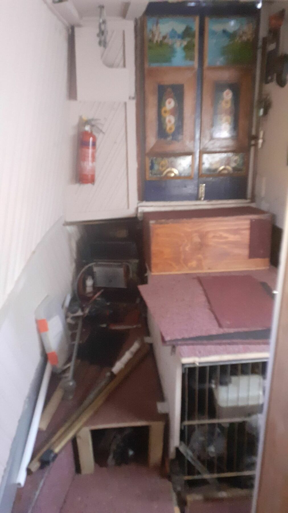

James_P Posted August 19, 2023 Author Report Posted August 19, 2023 Sorry if I was not clear, Basically how to protect the bare metal. So out side of the hull, under the gunnel, IE liable to be in the canal, what would you do beneath the blacking, prep, other stuff like red oxide, etc. Above the gunnels the prep before painting in a nice colour, and any recomendation for painting you swear by. Inside, it's a trad so the inside of the stern, the last owner never finished it an I will probably need put some bracketry in to support the engin enclosure.
robtheplod Posted August 19, 2023 Report Posted August 19, 2023 4 hours ago, James_P said: Sorry if I was not clear, Basically how to protect the bare metal. So out side of the hull, under the gunnel, IE liable to be in the canal, what would you do beneath the blacking, prep, other stuff like red oxide, etc. Above the gunnels the prep before painting in a nice colour, and any recomendation for painting you swear by. Inside, it's a trad so the inside of the stern, the last owner never finished it an I will probably need put some bracketry in to support the engin enclosure. is that the same camera used for taking pics of UFO's? 1
