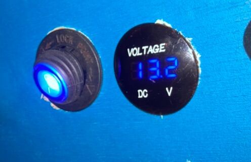

2. I have a very simple voltage reader mounted in the wall (pic attached)
That's probably a passable volt meter but to really track and understand the battery state of charge, you need an ammeter (current meter) too. Something like a Victron BMV712.
 A Victron BMV712, along with a long day spent reading and inwardly digesting the battery primer I linked to above. It explains batteries beautifully and clearly, in proper depth but not so much depth as to be overwhelming.

right now the voltage is 12.58
