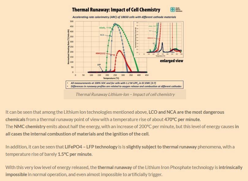

For LFP the risk of fire is very low, they're really no more dangerous than LA when overcharged (but a lot more expensive to replace) -- NMC are a different matter entirely, LCO and NCA are even worse, which is why insurance for boats using these chemistries is almost impossible to get -- assuming the insurers ask the question, but even if they don't they're unlikely to pay out in the event of a battery fire because you failed to inform them of material information (battery type).
There's some useful information (and videos) here:
https://www.powertechsystems.eu/home/tech-corner/safety-of-lithium-ion-batteries/
Edited by IanD
