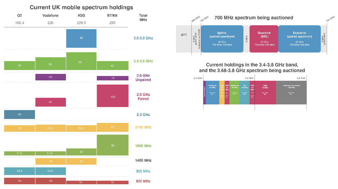

Speaking of frequencies, can someone help me understand the UK frequency bands. Most networks operate 5G on 3.4GHz (with the exception of Three which operate on "3.6 to 4GHz" - implying that they bought all those bands??).
However it seems like no 5G devices support 3400MHz, and when looking at the WiFi bands, 3.4GHz doesn't even seem to feature as a name: https://en.wikipedia.org/wiki/5G_NR_frequency_bands
What gives here, what should I be looking for when trying to find a supported device? What limits a device from supporting say n78 = 3.5GHz and not 3.4GHz, is it the physical size of the antenna or a software limitation or something else?

Don't confuse 3G/4G/5G cellular bands with Wi-Fi (or Bluetooth), they're not at all the same -- Wi-Fi and Bluetooth use unlicensed bands where anything goes (routers, PCs, posh appliances...), cellular bands have strict controls where not all bands are lecensed in all countries and subsections of each licensed band are sold off to different operators.
https://kenstechtips.com/index.php/uk-network-frequency-bands
https://awtg.co.uk/5g-spectrum-uk
Some devices may not physically have the antennas/filters to support some bands (hardware limitation), but it's more common that the bands are restricted by software according to which country this is licensed for, because "licensing" means you're only allower to transmit in bands allowwed in thet country. On top of this if devices are locked to particular networks they may also be restricted to the bands used by that network operator.
It might be possible to confirm exactly which bands the hardware will support by digging into device specifications, but unless you buy something with UK-specific software it's often difficult to tell whether this will support the UK bands you want to use.
Yeah I realise they're very different. What's very frustrating is that most WiFi access points operate on two bands - 2.4GHz and 5GHz, the second of which - annoyingly - is often abbreviated to "5G" which collides with the other abbreviation for 5th generation cellular technology.
All the network operators in the UK operate 5G(eneration) at 3.4G(igahertz), except Three which lists it as 3.6-4GHz. I hear that they are also rolling out "sort of 5G" at 700MHz which has higher penetration and better distance.
However 3.4GHz doesn't have a "name" like "n78" or "B20" that are listed as the supported bands, which makes me think that either no manufacturers are making equipment for the UK's fledgling network yet, OR what the networks call "3.4GHz" is actually n77 = "3.3-3.8GHz" or something, unfortunately I don't understand what this really means so I don't know how to judge. All I know is that I haven't found a 5G modem that lists "3.4GHz" as a supported frequency.

In the future in 5G a new feature called "distributed-MIMO" may be rolled out where one handset can use links to more than one basestation at the same time to get higher data rates and better reliability, but this needs so-called "NR" (New Radio) basestations which are not built yet in the UK -- and almost certainly new mobiles which support this feature. It still won't be possible for one mobile to talk directly to another one.
