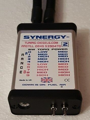

hi there everyone new user, just looking into the possibility of adding an ecu or electronic tuning box/equiptment for my boat engine bmc 2.2 , i have experience with some landrover tdi tuning boxes, not a full ecu or remap but it gives you some options on effecting fuel effeciency and engine output.
i was wondering if there was anything like this for the bmc engines, obviously being a vintage engine i know my options will be minimal and i would have to fit a number of sensors myself, iam just curious if there are any enthusiast engine management systems out there that you guys know off.

Presuming your engine doesn’t have a turbo and has mechanical injection, I can’t really see what there is to “tune”. These boxes work with vehicles that already have an ECU, turbo, electronic fuel injection and various modern emission reducing devices like an EGR. In a boat whose engine is operating mostly at a steady rpm, I can’t see what could be done with or what could be improved by an electronic tuning box. Unless you plan to replace the mechanical fuel injection system with an electronic one, again I can’t see what an ECU could control.

Unless it has a Pietzo clamp for no. 1 injector pipe, I can't see where you will connect it on a 2.2 or any other BMC diesel. I also can't see the timing strobe that would be required to "see" the injection mark on the flywheel - even if you have suitable access with the flywheel housing in position.
On all the BMC diesel with DPA pumps you use a timing gauge to take the backlash out of the drive and then set a pointer that is aligned to a line scribed on the pump flange. On the inline 2.2s you use a swan neck and do spill timing.
I have no idea how you think an electronic device can alter the mechanical adjustments on a DPA or inline injector pump to alter the fuel delivery. You need a large pump test and setup machine to do that, and all the adjustments for fuel delivery are inside the pump itself.
If you have an inline 2.2 then it's a pneumatically controlled injector pump and you will be doing well to stop it surging on idle.
You may like to read the FIE notes on my website that may help you understand these old injection systems:  http://www.tb-training.co.uk/CIsys.htm
