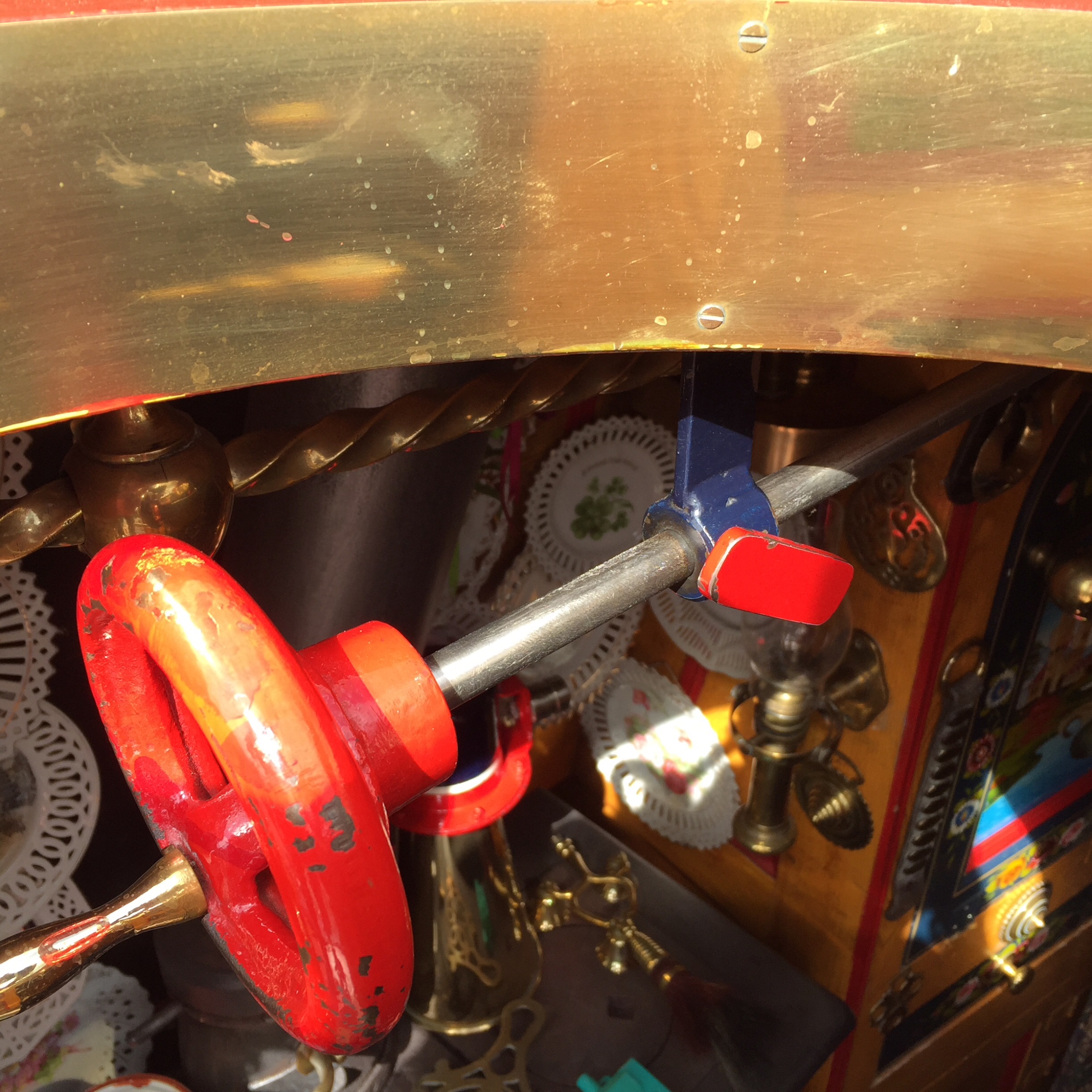

On 02/05/2021 at 13:20, NB Alnwick said:
One of the peculiarities of the Kelvin gearbox is that the propeller shaft, as well as rotating, is also required to move ahead and astern slightly for the respective cone shaped clutches to engage/disengage. When running at cruising RPM the thrust on the propeller (in either direction) is sufficient to keep the clutches engaged. Unfortunately there is a tendency for the clutches to disengage at the slowest canal speeds - an issue that we have addressed by hanging a 7lb weight on the gearwheel to keep it engaged at slow speeds. The amount of movement on the prop. shaft is only about an inch but it does add a little more wear and tear to the stern gland packing.
Having said all that, our stern gland is good and was not dripping at all with the boat stationary. The float switch is also working OK now but was probably stuck before I cleaned all the old grease and muck out of the wet bilge. We live and learn and the secret of happy boating is regular maintenance!

I would love to see the drawings of this arrangement but we are quite happy with the standard Kelvin transmission as fitted to the K series. The only problem is that at slower speeds it does have a tendency to work itself out of gear - effectively settling in a neutral state where there is no power transmitted to the prop. As previously stated, we overcame this problem by hanging a 7lb weight on the gear wheel when it is in gear. The only disadvantage of the Kelvin control is that it takes half a dozen or so complete turns of the wheel to get from the ahead to astern so it isn't a rapid process for executing an emergency stop.
Another solution to the disengagement issue is to drill and tap the side of the support column, adding a bolt which pinches the gear rod. I used to hang weights on our J3, this was a neater and more effective alternative.
A very neat and, now that I have seen it, a very obvious solution.
Have a look at your cones.  They may need relining. The gearbox to block gasket may also be thicker than original.
With new linings (ex factory) there  should be about 1 turn from ahead to astern.  With new,  modern, slightly thicker than the imperial originals, linings there is no more than a quarter turn either way from neutral to in gear.
My J arrangement is chain reduced by about 2:1 from the gear wheel to the thrust box.  It goes in and out nicely with about  one turn either way from neutral and will stay in gear at tick over for at least the length of the Golden Nook moorings on  the Shroppie ( a distance normally measured in astronomical units?.)
N
I am sure that Alnwick's cones are long overdue for re-facing or re-lining - I haven't opened up the gearbox in sixteen years of ownership and I doubt the previous owner did.
Apart from setting valve clearances, injection timing and regular oil changes the engine and gearbox has needed no attention and the only breakdowns have been ancillary items such as the starter motor and injection pump. Being of the mindset that "if it isn't broken don't fix it" - I am happy to keep it as is but no doubt it will need heavy repairs one day!
Our gear control wheel has a quite small chain sprocket so the reduction ratio with the larger 'K' box is probably closer to 4:1 - I will check this by counting the chain teeth on the respective sprockets when I return to the boat.

On re-checking the gear control wheel more thoroughly - I can see that I significantly exaggerated the number of turns necessary to move the shaft from ahead to astern. It is roughly two and a half full turns of our control wheel and the gearing is nearer to 3 to 1. This means that there is about one whole turn of the gearbox sprocket to go from one direction to the other. Having said that, in an emergency it seems like a lot more than just 2½ full turns of the wheel!
