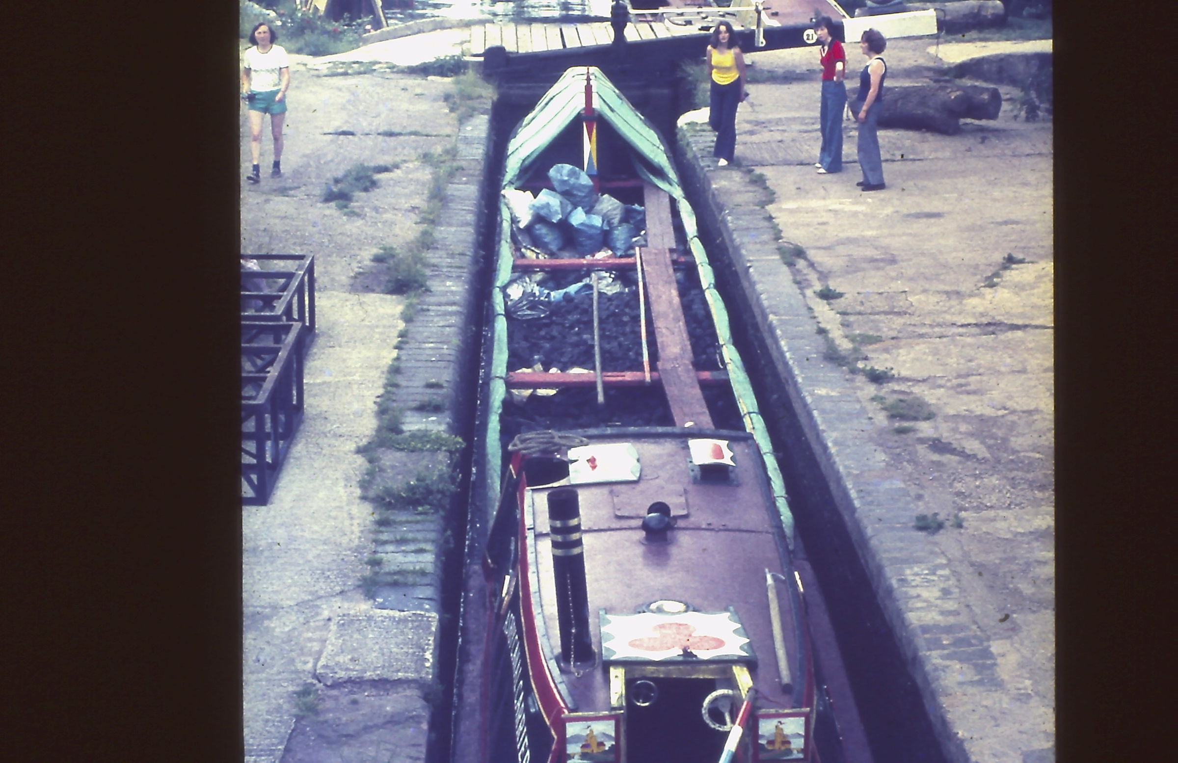

The Petter pd2 had a parsons gearbox and it was operated by a wheel from the cabin. I can’t remember how this arrangement moved the lever at the gearbox but someone will probably be able to explain it or have a photo.
its the big white wheel on the right the other being the speed wheel.
