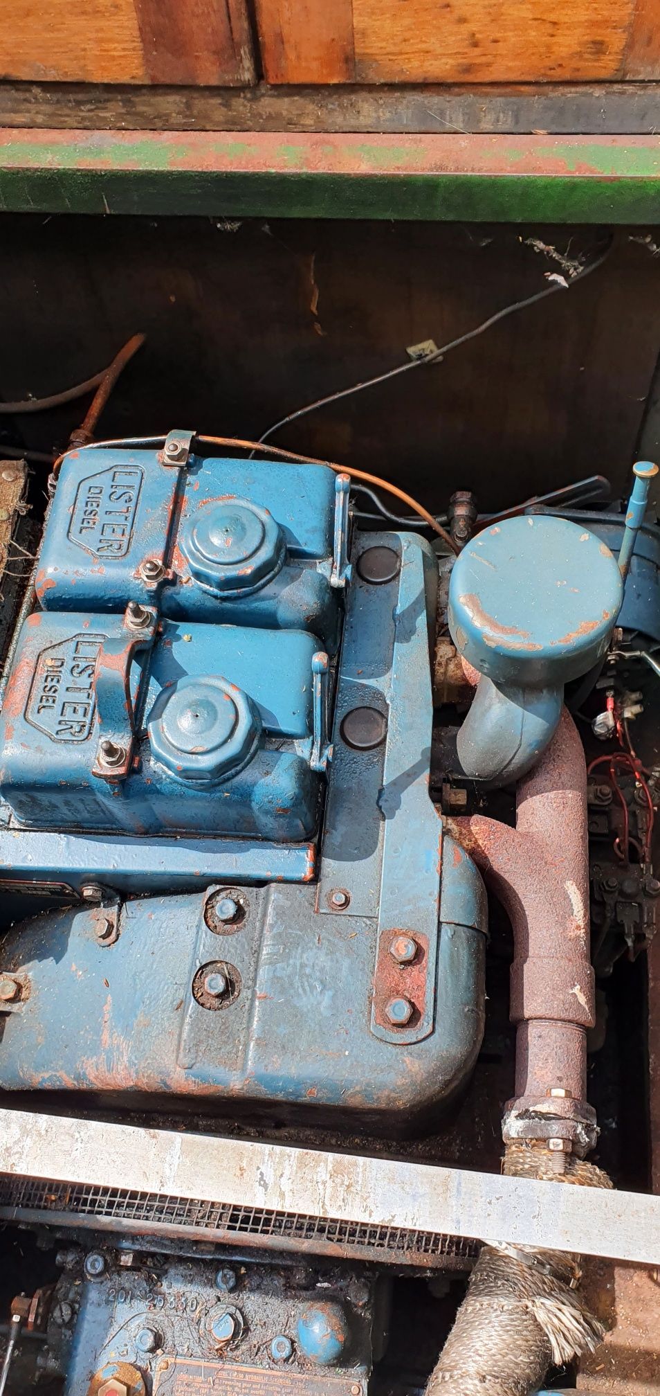

PhilR Posted July 29, 2020 Report Posted July 29, 2020 37 minutes ago, Tony Brooks said: I know of a hire boat on the Thames that had a 1.5 running without an inlet manifold. I agree something to keep rubbish and dropped nuts & bolts. bodies out of the engine. Most of the marine versions of the SR2 didn't have an air filter. Here is a photo of the inlet manifold and cover. There is no filter under that cover.
Tony Brooks Posted July 29, 2020 Report Posted July 29, 2020 1 hour ago, PhilR said: Most of the marine versions of the SR2 didn't have an air filter. Here is a photo of the inlet manifold and cover. There is no filter under that cover. Just like many Vetus and the Perkins with flame plugs.
PhilR Posted July 29, 2020 Report Posted July 29, 2020 21 minutes ago, Tony Brooks said: Just like many Vetus and the Perkins with flame plugs. I had forgotten that. My previous boat had a Perkins 4/107. My starting procedure was to turn on the heating element until there was a puff of smoke from the inlet manifold, then engage the starter motor. It never failed to start first time. My SR2 has no starting aids, but in warm weather it starts within 1 or 2 seconds (assuming the battery is good). I presume the manufacturers' logic in having no air filter is that a marine engine would not normally be operating in dusty conditions?
