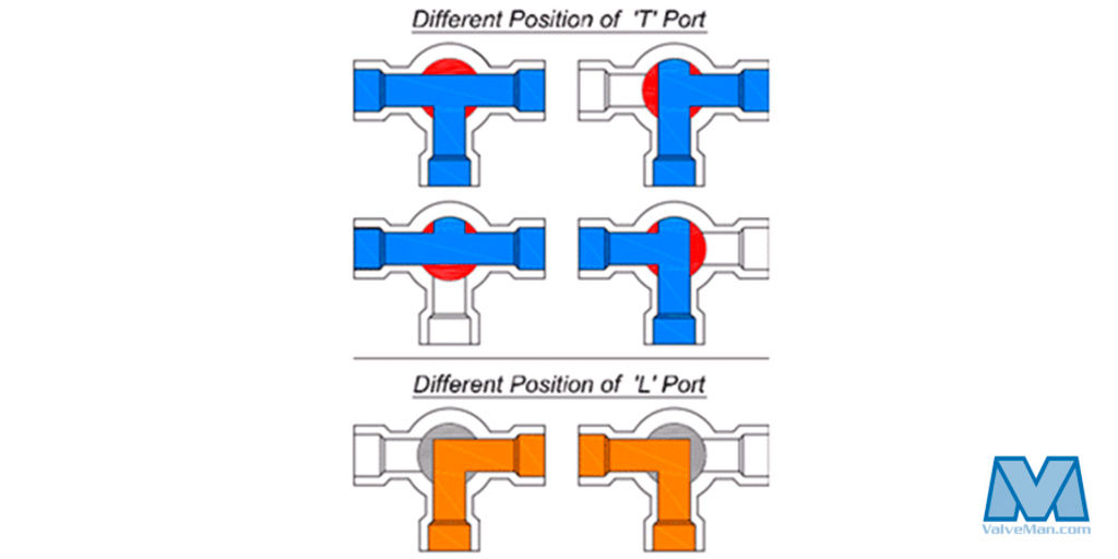

How many sources of hot water supply are we talking about here and how many c/h & hot water systems are we connecting them to? If it's just two supplies to one system then isn't an L-port valve required rather than a T-port valve? Sorry I'm a bit confused about what you're trying to do?
On the diagrams below with the L-port valve you'd have both supplies coming in from left and right feeding one c/h & hot water system in the centre and the two supplies can't be connected.
