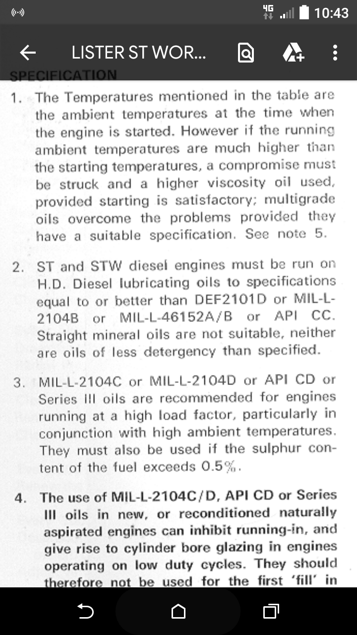

Canal321 Posted June 10, 2020 Author Report Posted June 10, 2020 Reading the manual it says straight mineral oils are not to be used. Does that mean it has to be fully/semi synthetic?
Tony Brooks Posted June 11, 2020 Report Posted June 11, 2020 10 hours ago, Canal321 said: Reading the manual it says straight mineral oils are not to be used. Does that mean it has to be fully/semi synthetic? I think that you may have misread the manual. Probably says synthetic shoudl not be used. A straight mineral oil is one that is not a multi-grade so like the one David shows and when the basic engine was designed those were the only ones available. I have dug out my SR manual and it shows both straight and multi-grade oils. For the UK climate SAE20W20 but I have never seen such an oil. Remember this is for an SR, not an ST so until contradicted I am sticking to what I said earlier.

Tony Brooks Posted June 11, 2020 Report Posted June 11, 2020 (edited) OK, not your fault but a lack of clarity on the part of Lister. Personally I think you will struggle to get what they call a straight mineral oil because its an oil with no additives in it. That phrase is about 50 years out of date. All oils you can buy today will have additives so they are not straight mineral oils as per the manual. You do not want synthetic oil. The "magic" part of the specification is where it says API CC. This is an oil suitable for diesel engines but with a limited amount of additives when compared with modern oils. Note it says API CD may inhibit running in but once run it they will be fine. Put is all together and for the UK, in and engine bay, we are back to SAE 15W40 in API CC or CD as I said in my original answer You can use the mono-grade oil David showed as long a sit meets the API CC CD specification but I would use the multi-grade because on really hot days with lots of hard running it should maintain its viscosity (runnyness) better. Have a search for 15W40 in API CC or CD. Its unlikely to be in Halfords and such like but a motor factors may stock it as may agricultural merchants and oil specialists. Edited June 11, 2020 by Tony Brooks 1

Canal321 Posted June 11, 2020 Author Report Posted June 11, 2020 (edited) Thank you both, I just wanted to understand it all a little better. 1 hour ago, Tony Brooks said: OK, not your fault but a lack of clarity on the part of Lister. Personally I think you will struggle to get what they call a straight mineral oil because its an oil with no additives in it. That phrase is about 50 years out of date. All oils you can buy today will have additives so they are not straight mineral oils as per the manual. You do not want synthetic oil. The "magic" part of the specification is where it says API CC. This is an oil suitable for diesel engines but with a limited amount of additives when compared with modern oils. Note it says API CD may inhibit running in but once run it they will be fine. Put is all together and for the UK, in and engine bay, we are back to SAE 15W40 in API CC or CD as I said in my original answer You can use the mono-grade oil David showed as long a sit meets the API CC CD specification but I would use the multi-grade because on really hot days with lots of hard running it should maintain its viscosity (runnyness) better. Have a search for 15W40 in API CC or CD. Its unlikely to be in Halfords and such like but a motor factors may stock it as may agricultural merchants and oil specialists. This was very helpful thanks Edited June 11, 2020 by Canal321
