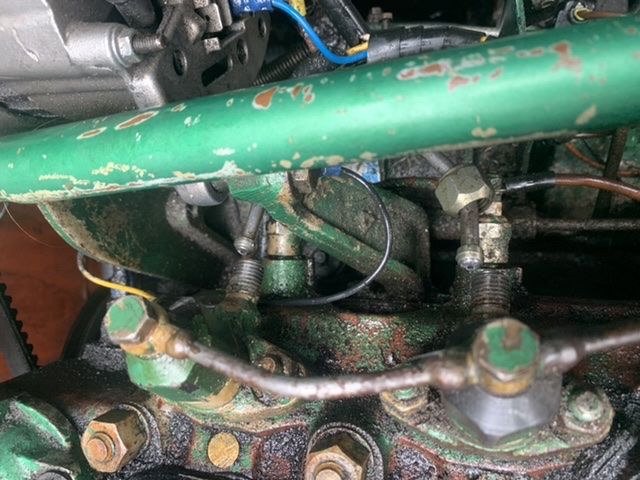

Can anybody tell me where I can get the top injector pipes or seal? Linking fuel! Cheers ps the top one has worn and it’s a Thornycroft 108 engine

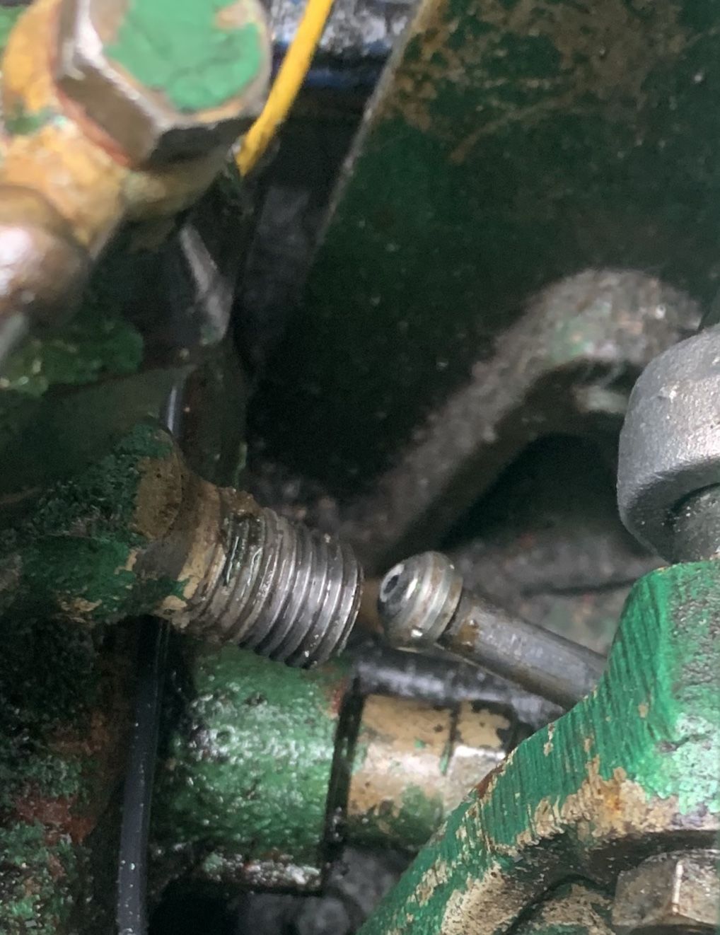

Thanks guys, great advice. Yes they where tight on the end one which is leaking. Yes it’s the top pipe as attached. Tried tape no luck with that and tried a copper washer. It does seem to slightly be out of line. Is the solder any good? How would you do that?

2 hours ago, Tracy D'arth said:

Very sound advice. With both ends of the pipe free with the nuts pulled back both ends should align perfectly with their respective nipples, if the pipe alignment is OK tighten both ends to 'finger tight' prior to final tightening.
Edit: Looking at the enlarged image of the pipe end seating it may already be a new pipe job.
