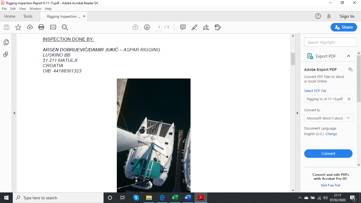

When we bought the Catamaran in Croatia (it was a £250k boat) we told the broker we did not want a survey, he insisted, I insisted, & in the end he paid for it to go over to Italy and be lifted out (nowhere in Croatia could lift it with 23 foot beam) and have as survey. He was not prepared to sell it and potentially sully his name by selling a 'bad-boat'.
The only fault found was a crack in the cross-trees which had already shown up whilst on its mooring when the broker arranged a rigging survey.
