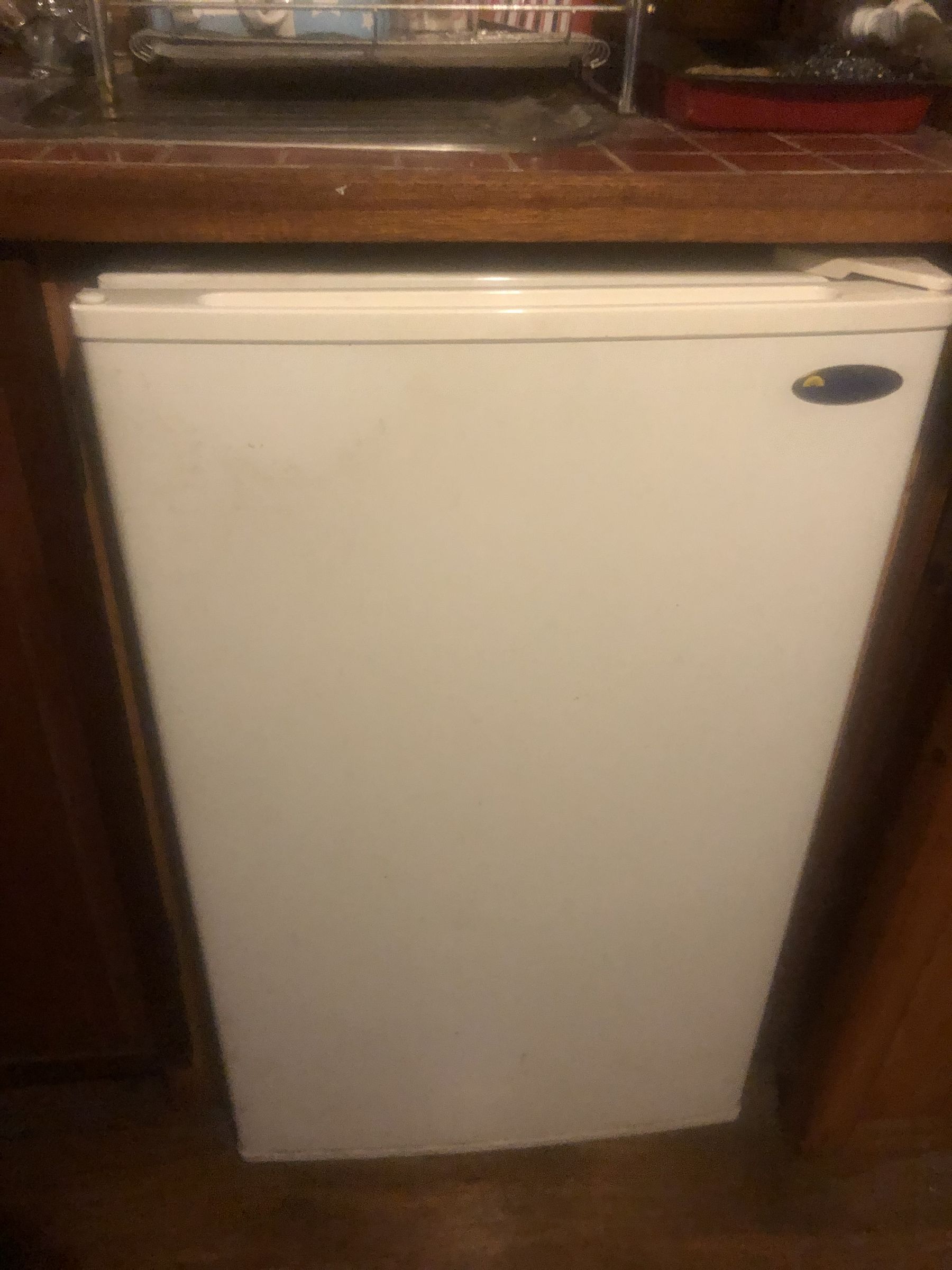

4 minutes ago, Mike the Boilerman said:
No visible label on it.
This one:
The label will be on the back next to the compressor ...  pull it out you lazy git :D
ETA: in fact, pull it out you lazy git and show us the dust on the fan blades!
Edited by TheBiscuits
Just looking at the specs for a Dometic small  cabinet fridge, power consumption is 175w average. Way way more then a similar fridge using the Danfoss 12/24 v compressor.
Why should I? It runs quiet as a mouse!
All I said was, it doesn't have a fan....
Or you are going deaf ...
