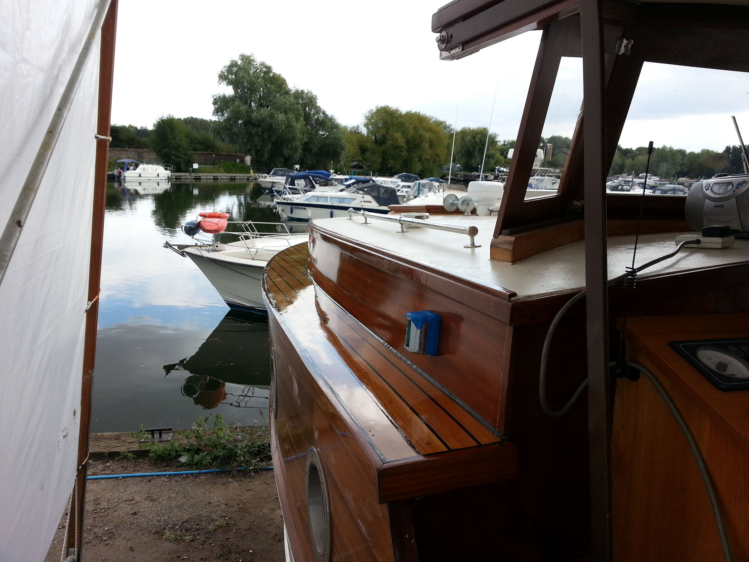

And accepted ?As undoubtably a man who likes gloss varnish -how about these oak decks. Many many coats of two pack..

Nope, but I have used LeTonkenois and that gives an excellent finish. Here it is on some mahogany (well, utile actually)
That is gorgeous. Well made. Lovely. Smashing. Super.
Well, I like it.
