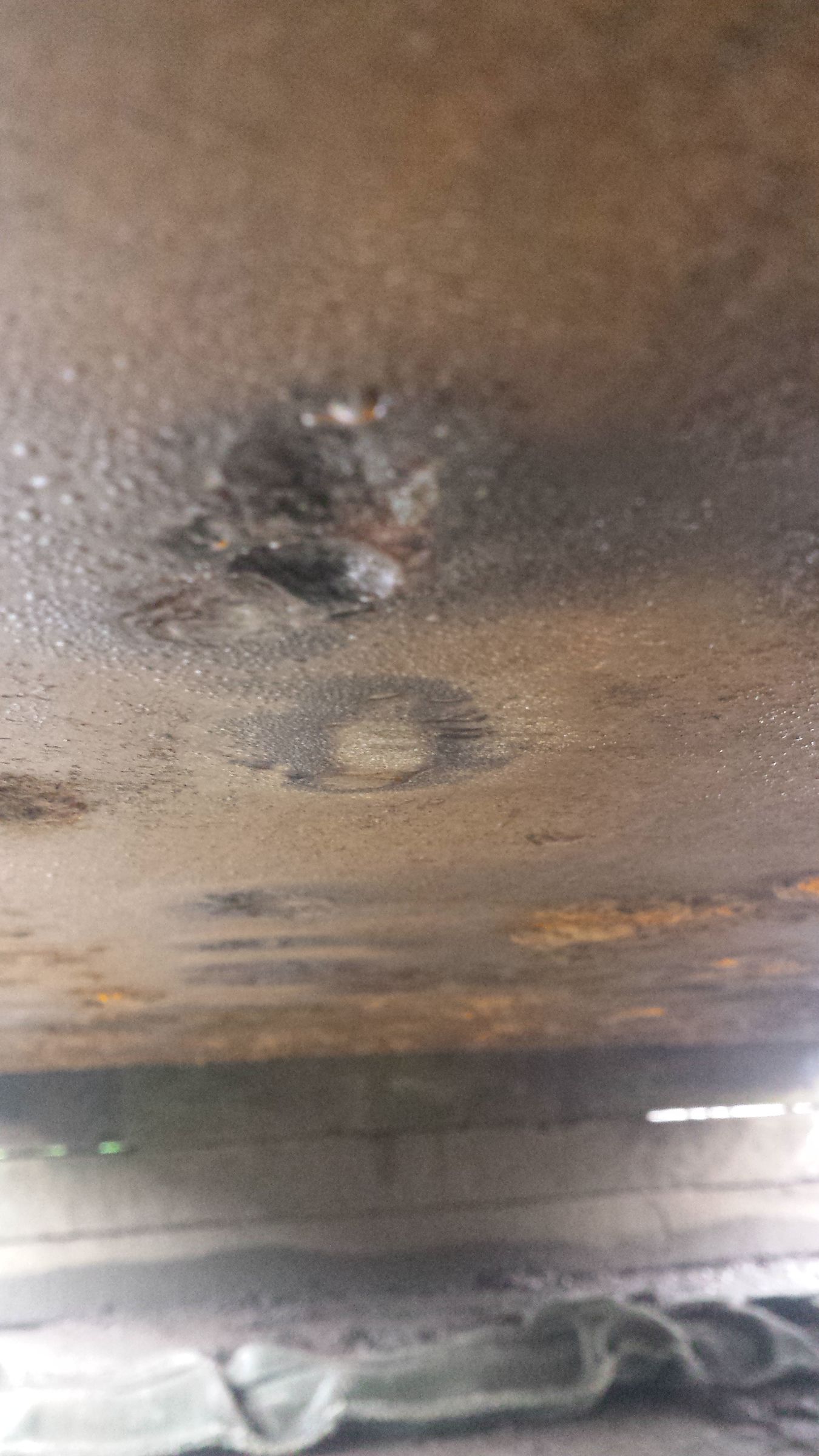

matty40s Posted February 22, 2019 Report Posted February 22, 2019 45 minutes ago, Sea Dog said: And how long does that take with 10mm steel exposed at one side only between 2-3 feet below the waterline? This is a 1994 boat with little or no pitting on the sides, the baseplate from the front angle to swim was covered in deep pits, 3 ,4,and 5mm being uncovered over a wide area within reach.....the rest looked just as bad.

Troyboy Posted February 22, 2019 Report Posted February 22, 2019 3 minutes ago, matty40s said: This is a 1994 boat with little or no pitting on the sides, the baseplate from the front angle to swim was covered in deep pits, 3 ,4,and 5mm being uncovered over a wide area within reach.....the rest looked just as bad. Thanks for that Matty I'm not sure if Sea Dog or Captain Pegg will now believe baseplates can rust through .
