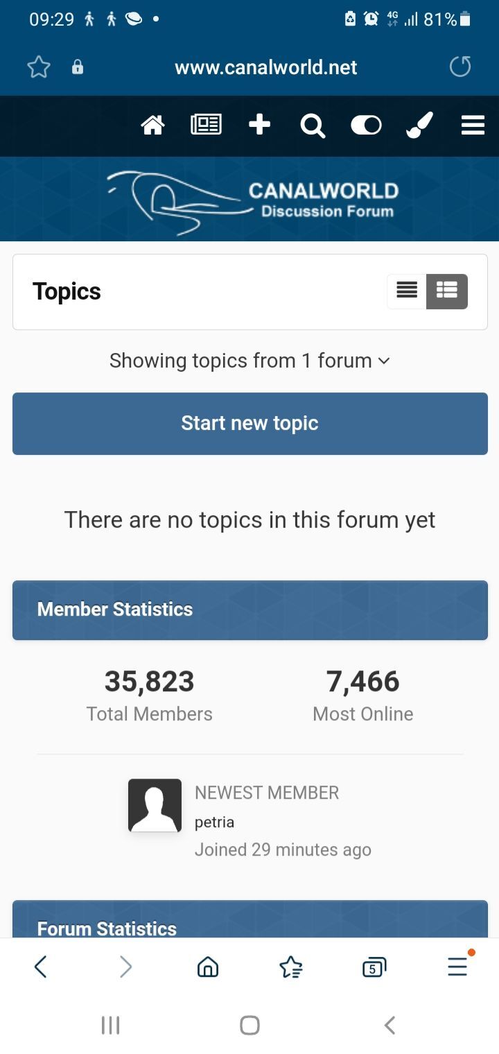

  19. As a leisure boater, running the engine most days I am on board, it doesn't make so much difference for me, but liveboards who have made the change to lithium generally view it as a huge improvement, despite the initial cost. "Keep it simple/no other changes" does really mean giving up the sort of power hungry appliances that land dwellers use without a second thought.
