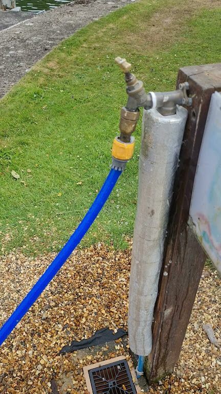

The blue hose is attached to to a tap with an anti back flow device ( this was EA's previous ''solution'' to complying with the 1999 water supply regs ) and is feeding my 1200 litre water tank which is four feet above ground level. the device has a 2 mm hole which feeds the hose and four 2 mm holes which discharge water due to back pressure. These devices were never designed for a hose longer than 60 cm. The link below should show it in operation. The pillar contains a small cistern which feeds the yellow hose via gravity and the wide beam is being filled by it. As this only provides a trickle of water it is taking an eternity and the boat crew resorted to filling small containers from another tap to try and speed up the process. If you lift the yellow hose up more than a foot or so the water ceases to flow. https://photos.google.com/photo/AF1QipM6lK-S_RbPBTwsdJal3BMoBh7KdGerGYY3kfWZ
EA's latest ''solution'' to a non problem, and if your filler is above ground level it won't work.
