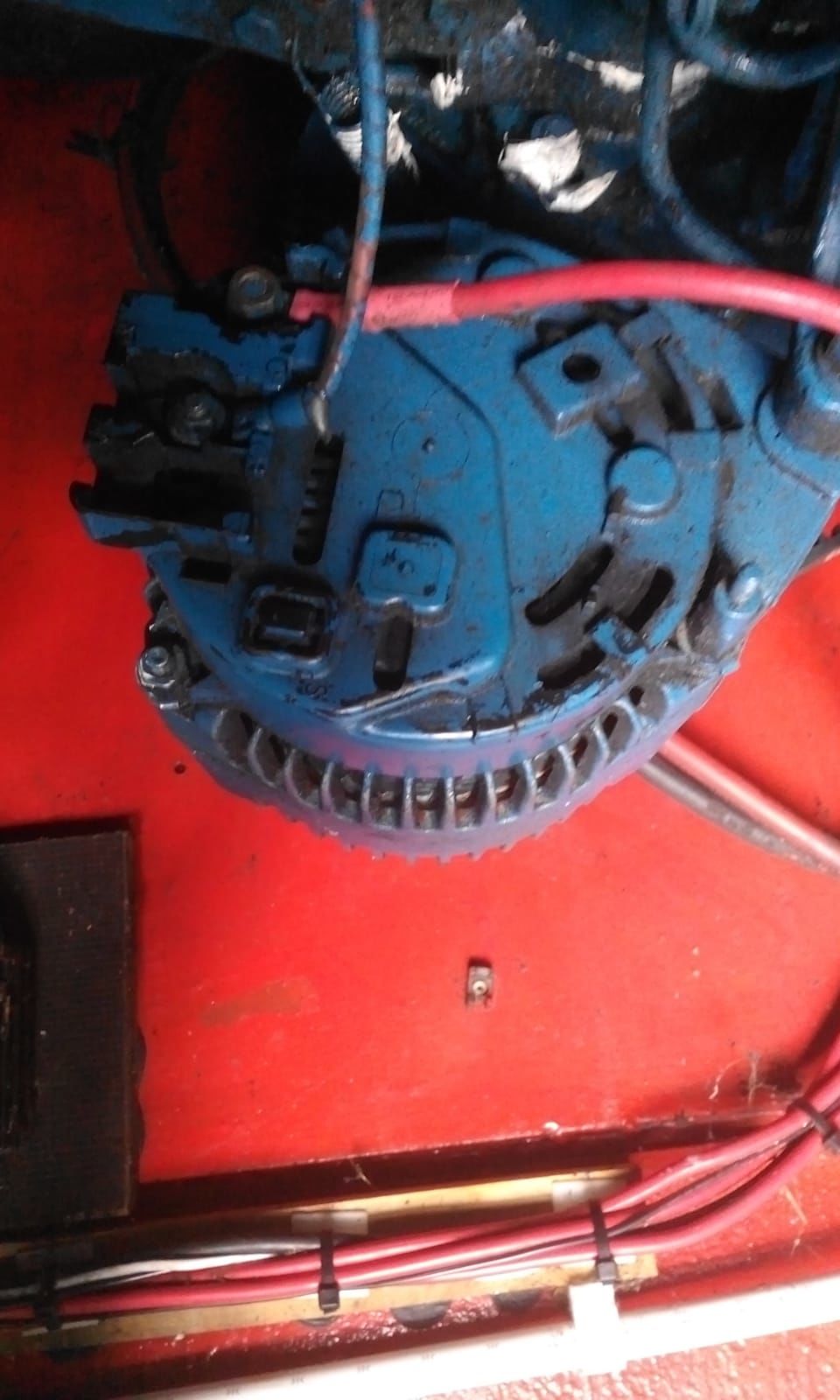

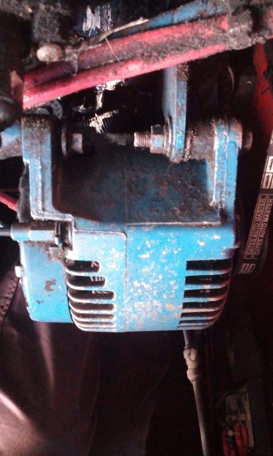

  6. Yeah a bit of everything lol My understanding is that if it is over filled it will boil it up as the water will have no room to expand. Any idea of what model this alternator is chaps ?
  7. From Aspley to shepley bridge through the broad canal and heavy calder flooding It never once over heated on me,the belt slipped on a day trip up the calder which i immediately tightened . You took it through the broad canal with no over heating Pete. The over heating started on the hnc. While you have the boards up get me a picture of the alternator front back and sides and send them through on wattsapp.

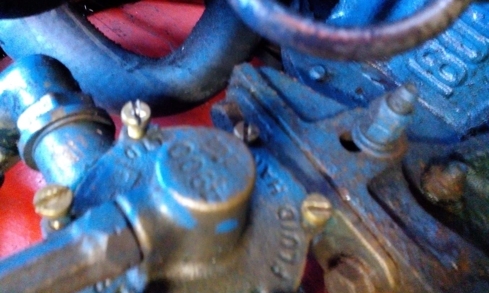

  10. It is actually an 1800 cc Thornycroft 1128 108
  11. Yeah looks like i will need to remove it to make sure i get the right item.The boats not in the best place for this at all. Can i bypass this with an electrical pump to get the boat moved or is that a no no? I have used the boat for two full days and it was sound,it must have been worn and unfortunately it has let go at the worst possible time.
