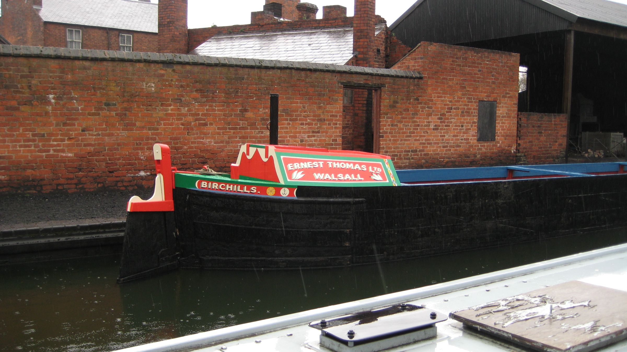

  1. Birchills (it took me a bit longer to find a photo) but a good illustration of the relatively small size of a day boat cabin. and not built till 1953.
