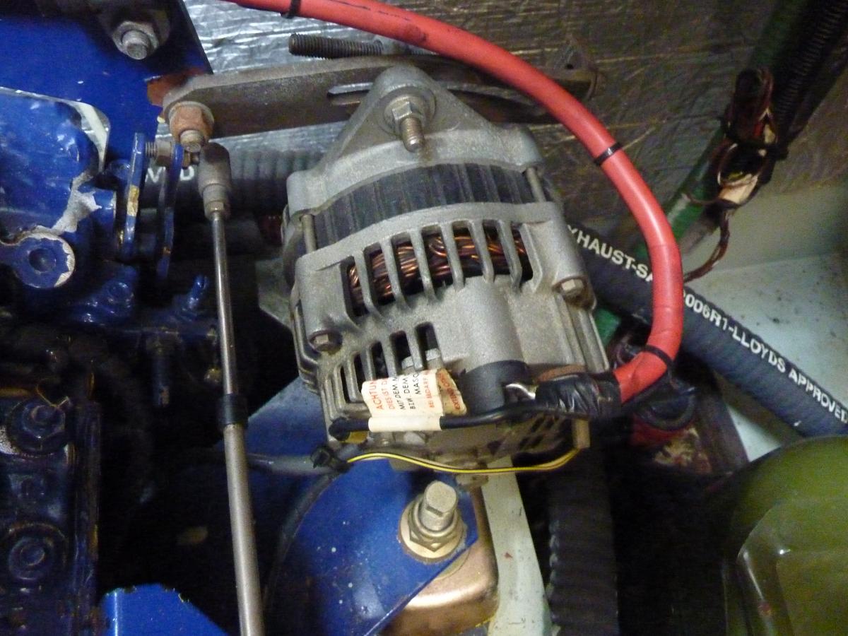

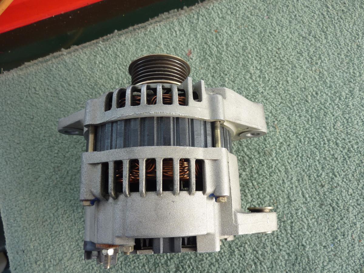

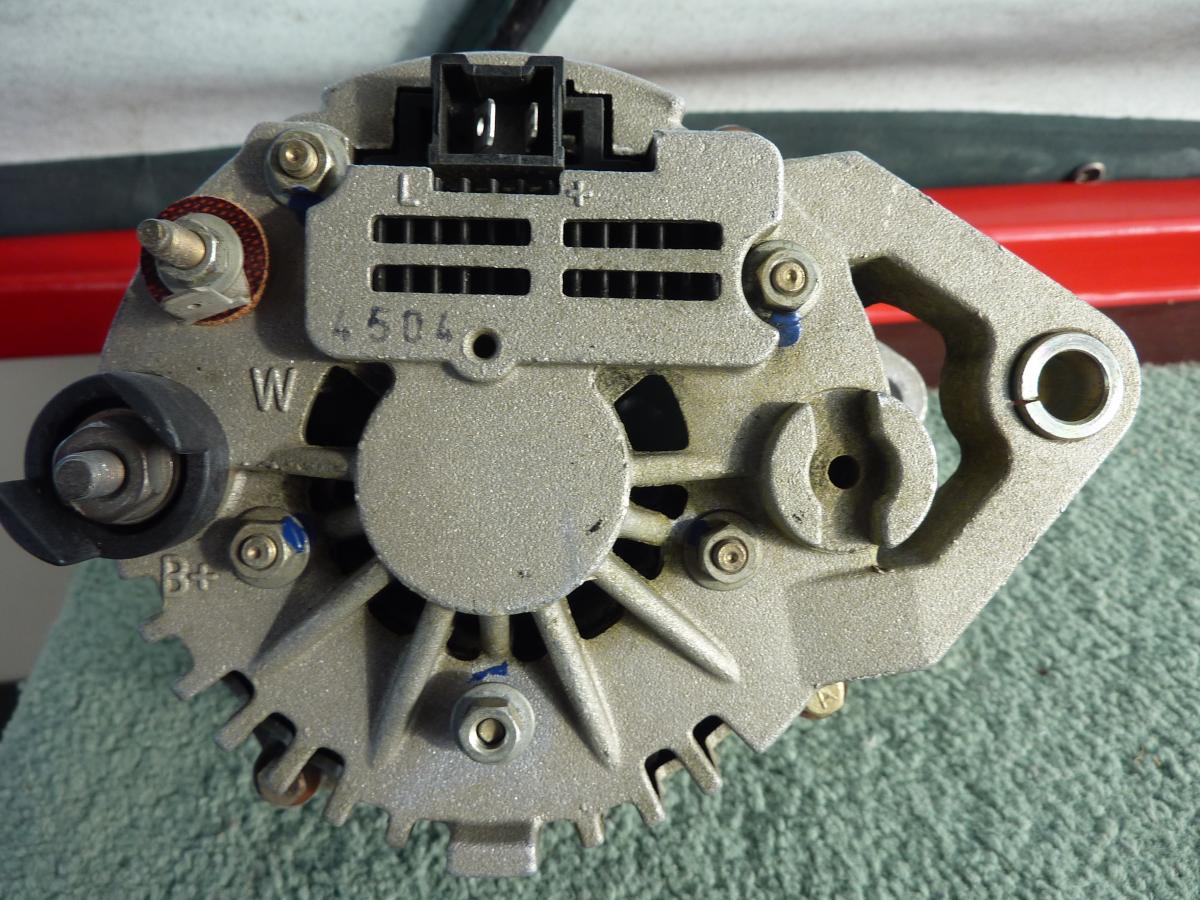

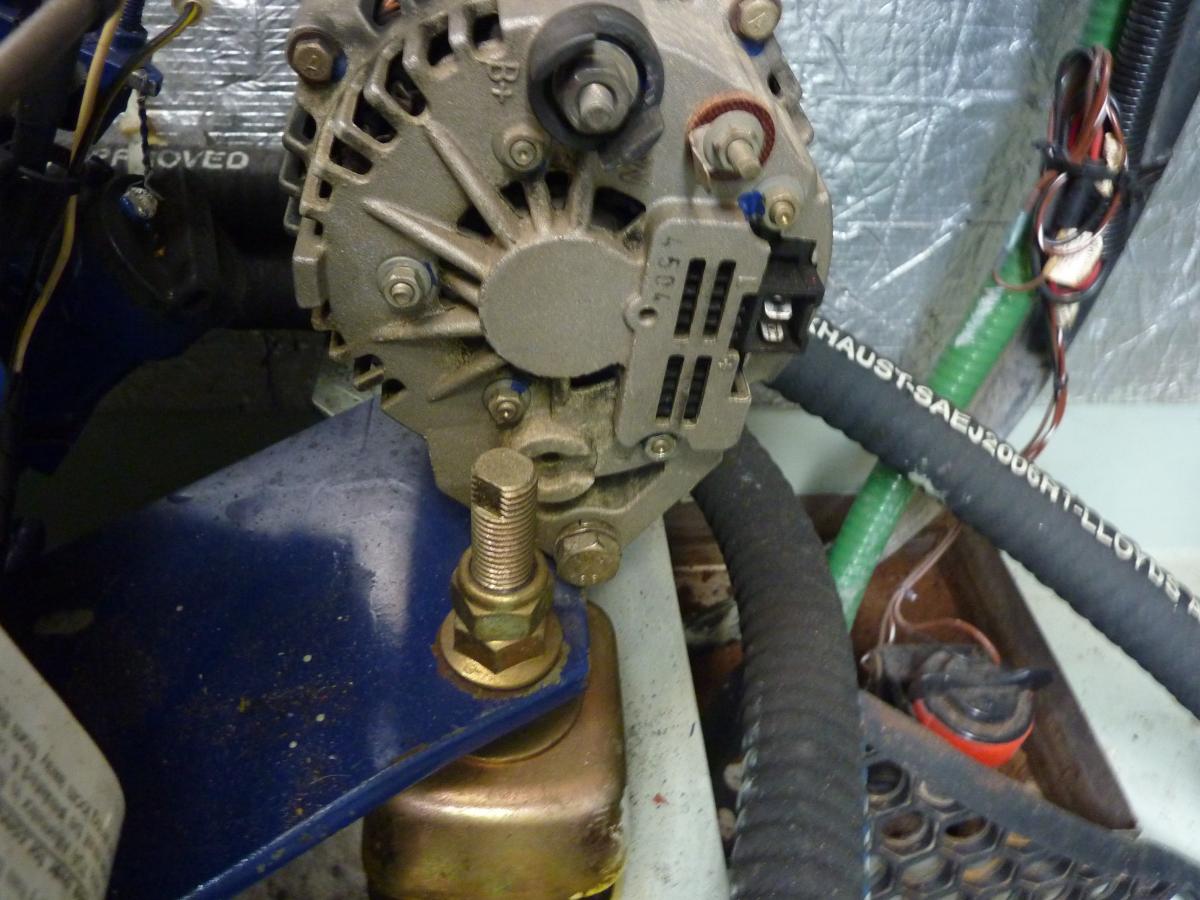

Help please. one of the two alternators (70amp &110amp) on my Izusu 42 engine is overcharging up to 15.3 volts causing the Alternator to Battery charger to trip out on "High input Voltage" . I have removed the 110 amp alternator and everything works ok with normal voltages. I want to change the regulator (or fit a new alternator) on this one but cannot find any manufacturer or model details on it to be able to source a new one. Could anyone help with identification or an alternative 110amp alternator that fits. The alternators came new with the engine 10 years and 36000 hours ago.
