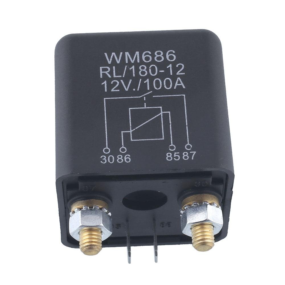

  10. Hello, I have 750w of solar panels going into a Victron system with 4x 110Ah batteries. I'm finding my batteries are fully charged by about 8.30 in the morning on sunny days. I'd like to use some of the remaining day's solar power to heat the water in my tank. That way when moored up for a few days out in the wilderness everything remains charged and water hot. The immersion heater in the tank is 1Kw and is 240v. I have a Victron MultiPlus that can more than cope with that. I'd like to use the switching facility in the Victron controller. When the batteries are full and happy I'd like the controller to switch a 12v relay which in turn would switch the 240v on to the immersion heater. If the batteries go below 85% the immersion relay turns off and the solar goes back to charging the batteries. Basically using the lost solar power to heat my water. My question is, can I use the 100A type 12v relays used in automotive industry? Like the one in the picture, or does anyone know of a DIN rail mounted version as we are talking of 240v and I would like it all to remain safe! Thanks Jono

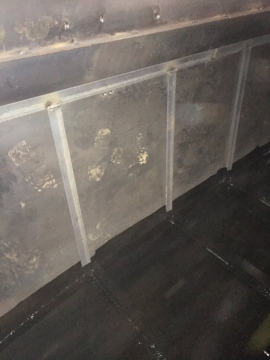

  12. That is exactly my worry too. "3x 6mm holes drilled as low as I dare" It's just my luck I'd go too far and create a nice feature fountain only for it to become a nice under-water boat exhibit! I know it's 10mm of solid steel to get through but I don't want to risk it. I think I may create inspection squares along one side of the flooring. It's all got to be lifted so I can remove ballast for things like cooker, multi fuel fire, shower weight etc. so I can saw off a corner of each before fitting it back down.

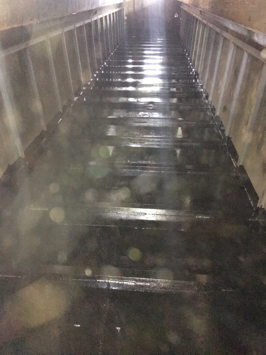

  13. No worries, I've just checked too and I don't have any Keelsons (after Googling what they were!). Not great pics but something I grabbed when I visited it being made. So would you all suggest I 'create' a route for water to travel from bow to stern? 3x 6mm holes drilled as low as I dare on each angle that's welded to the baseplate? One port, one starboard and one in the middle?

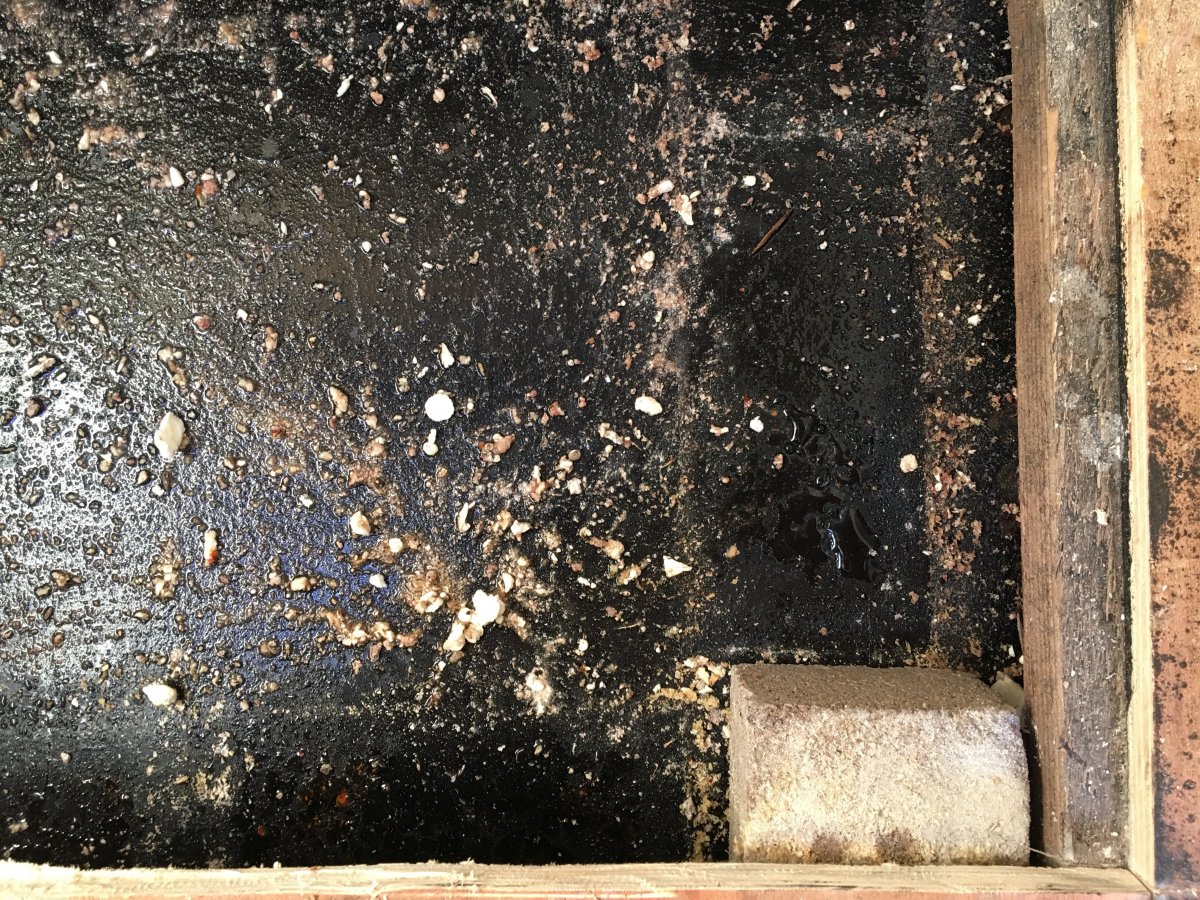

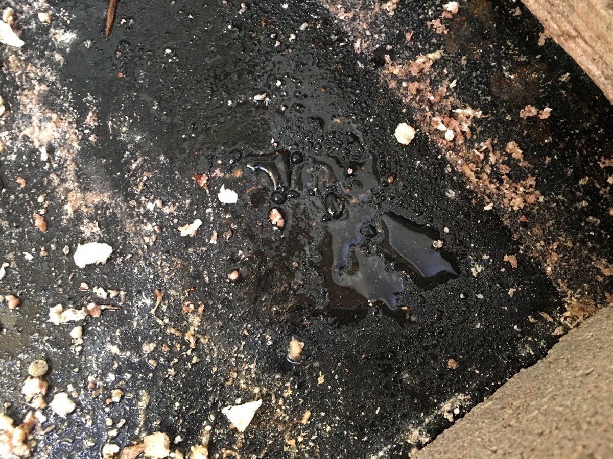

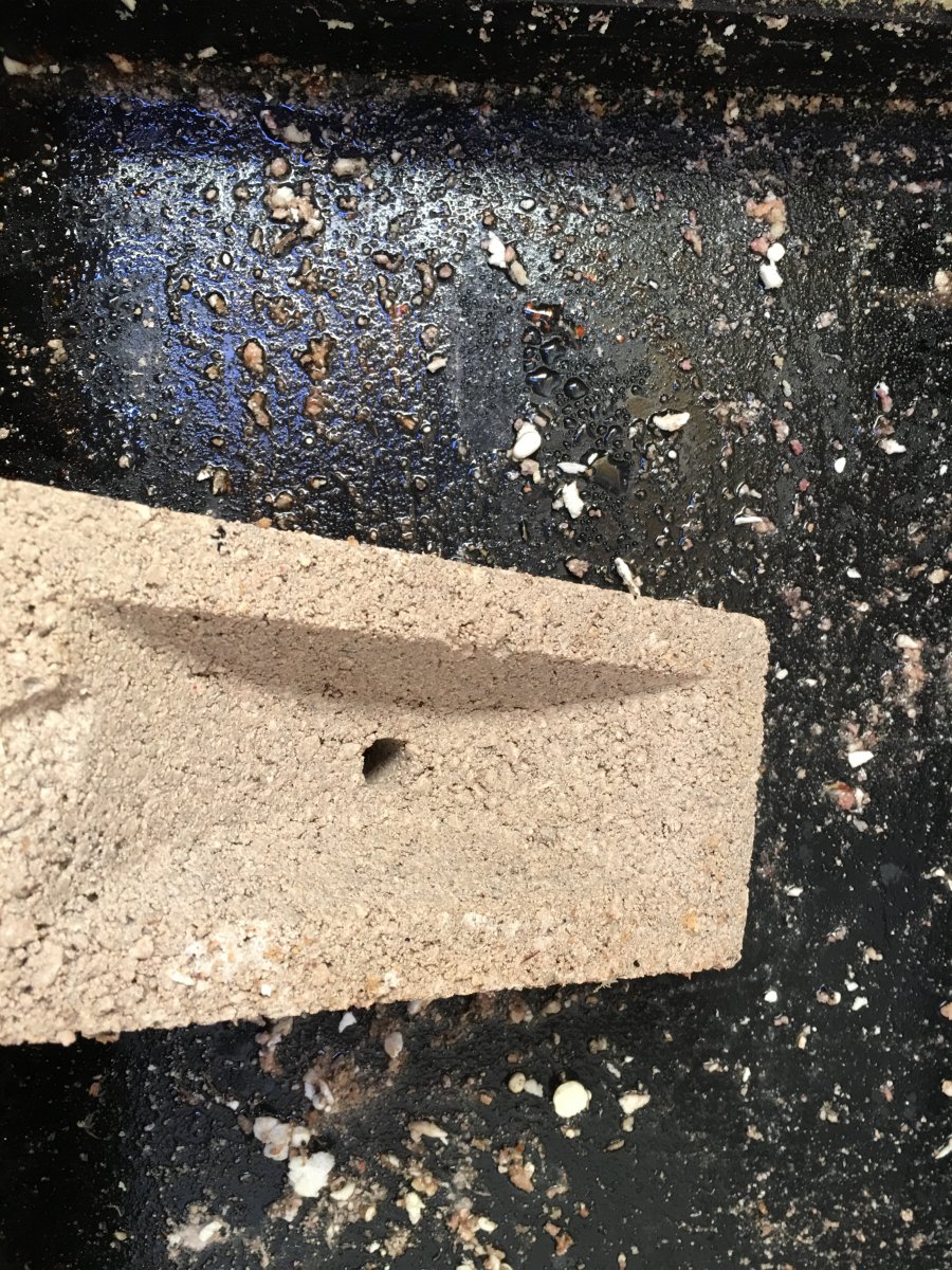

  14. What would you suggest I do? Ignore it or raise them up off the baseplate a little. I was in a builders merchant today and I can think of the ideal cheap alternative to raise the bricks off the baseplate but not too much so there is also air above too. Tile spacer crosses! The type you'd use to tile a floor, I think they go up to about 4mm. Cheap and 1000's of them! It would be a pain in the backside but if I need to do it it would be best.
