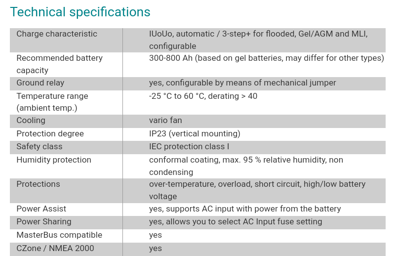

  1. On the CombiMaster product web page under specifications it states it has a ground relay. It also mentions this in the brochure.

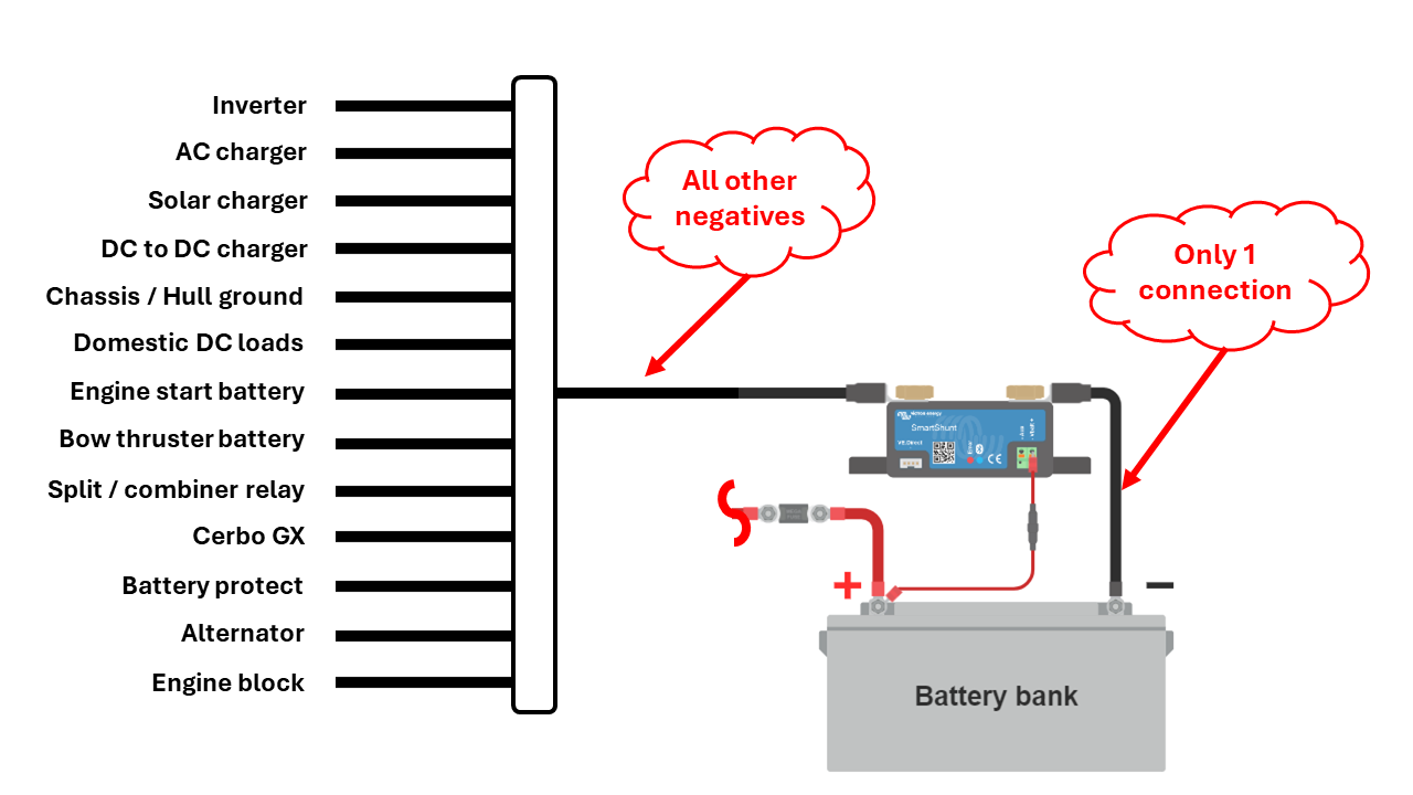

  12. How about this diagram from the Victron community to exemplify the wiring, but Nick has already answered.

  15. Pretty much seems OK to me. Changes I would make is add an isolator for the inverter, and you need a connection from -ve bus bar to hull ground point. You show a negative from the alternator, that is unusual, they normally have bodies connected to negative so you still need a connection from engine block to ground or -ve bus bar.
