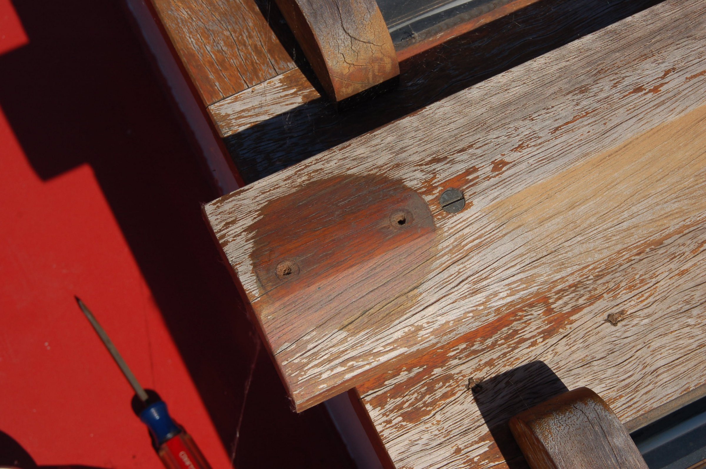

Have been giving our pigeon roof some love. This is what it looked like on Friday: Under the GPS the original colour of the varnish is revealed - this is about 4 years' difference: Sanded the top beam back to the bare iroko: We will be redoing this box and the wheelhouse this summer with Sikkens Cetol HLS Plus and Filter 7 Plus. This beam is the test piece and looking good: Lots more sanding and varnishing to be done - but it's been scorchingly hot and we daren't leave the roof open because of the dreaded mosquitoes. So this was the other project - 12x55mm hardwood strip, put together with 6mm dowels and jig to drill the holes: Varnished and then covered on the back in 1.5mm aluminium insect mesh, stretched out and staple gunned in place: A quick notch in the side and up it goes! Now we can leave the roof open... on one side at least until I make up the other one! -

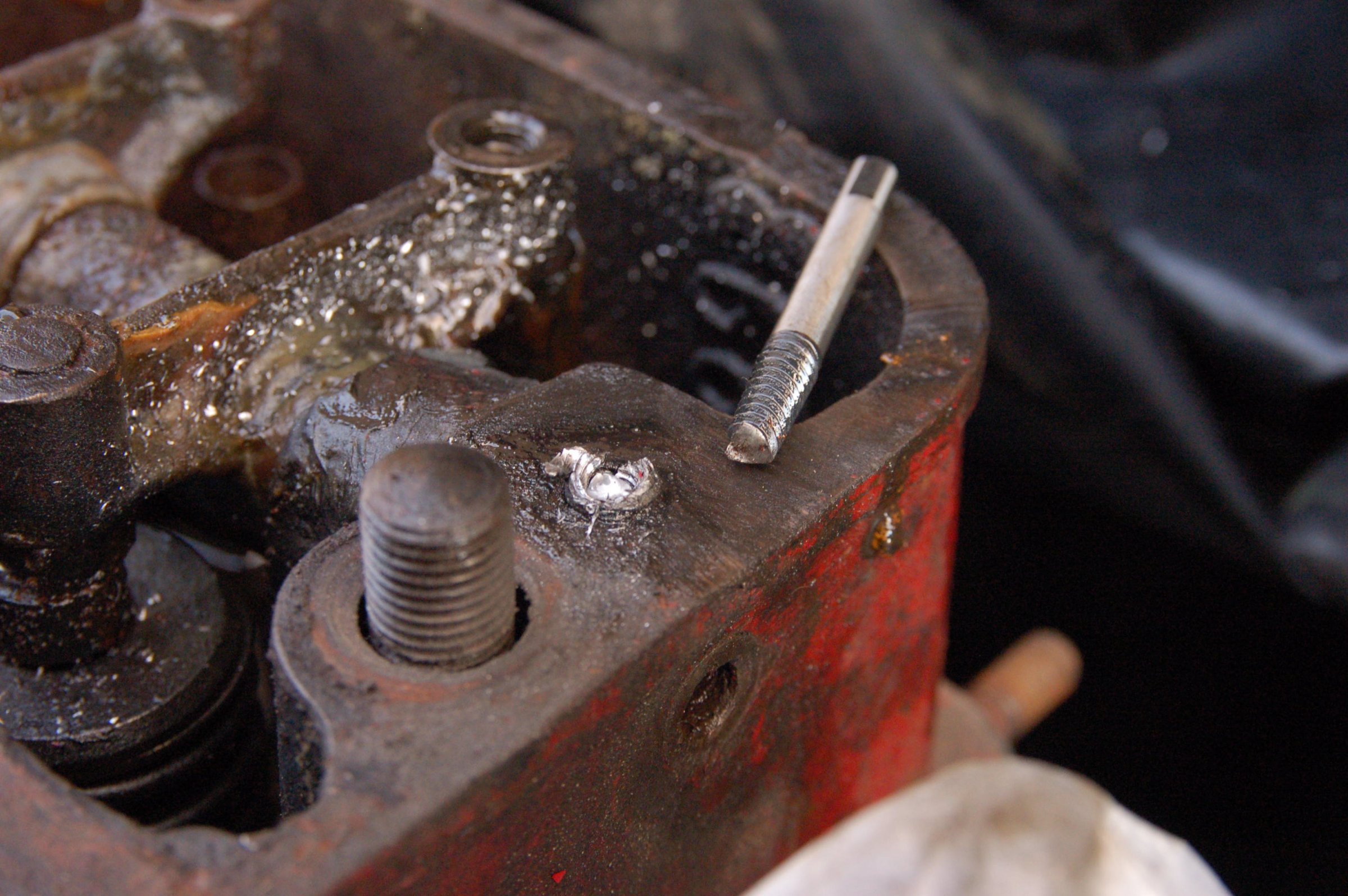

Once we've got that head off I will put it in the big drill press and drill out the remains. If I can do a neat job then all the better, but as BWM notes, only one retaining bolt is really needed, so if I mess up the thread it's not the end of the world - and could always tap to the next size up. The need to remove the rocker shafts to get the heads off really does seem like a bit of a design flaw on the JP. It's easy to get the shafts out once the heads are off! I actually wonder if it would be possible to create a tool that could get the hollow stud nuts off without removing the rockers. Anyway, we have plenty to do for now in cleaning up the bits we've already taken off and brought home.

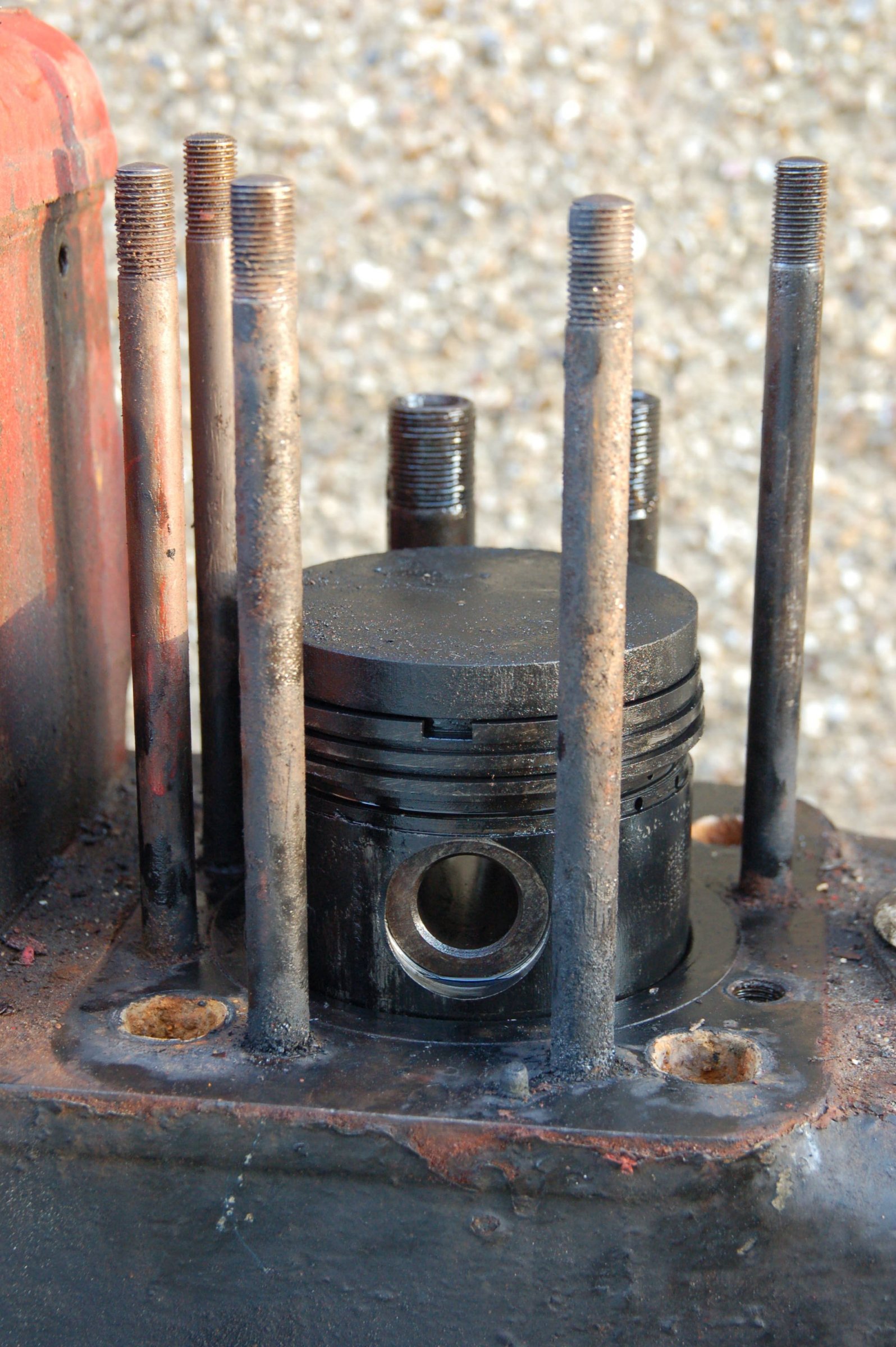

Well that was a bit of a flop. Is there such a thing as a "screw extractor extractor?" Despite not getting that out I did manage to tap that shaft enough to get it moving towards the next cylinder head, but coming back the other way I haven't been able to get it more than a couple of millimetres out of the head. Also tried to use it to push the one in the next head, but that's still thoroughly stuck too. No further with the gudgeon pin either - I will make up a puller.
Right - any good tips on getting that gudgeon pin out, and the remaining valve rocker shafts too? I'll be going back tomorrow or Weds for another bash at it. I sprayed in a load of penetrating oil at the weekend so maybe that'll help. One of the rocker shafts still has a retaining screw in place which the head has come off, so I'm going to have to drill out and extract that, but I don't know if that's actually what's stopping it. The other one has both screws out but still won't budge. I've taken the tappet screws out and turned the crank such that there's no force on the rockers. Just to further complicate things both shafts still have right-angle fittings screwed into the forward ends for the greasers, which can't be unscrewed because they hit a raised area on the sides of the heads. I don't want to abuse these and end up trashing the internal threads.

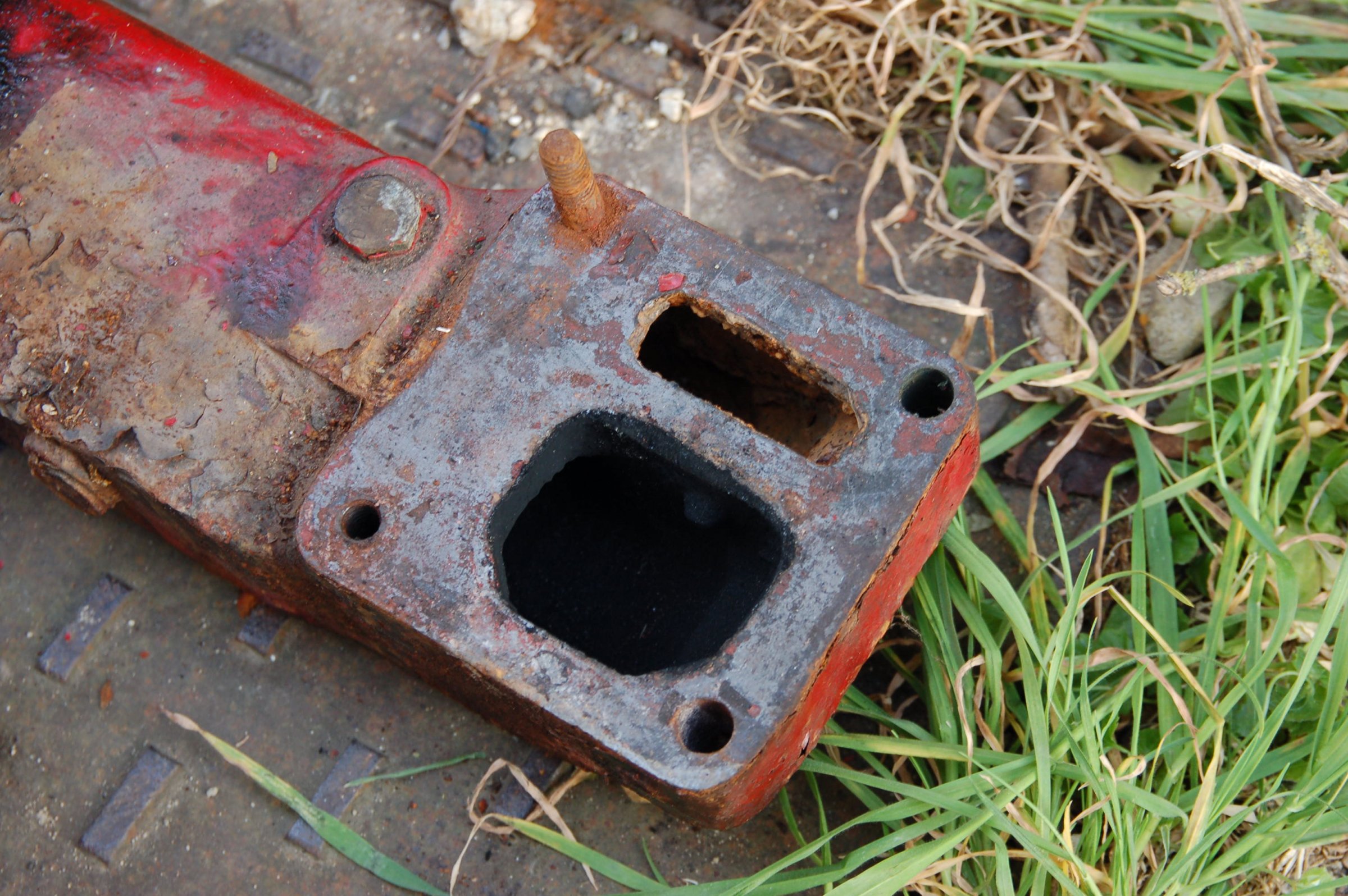

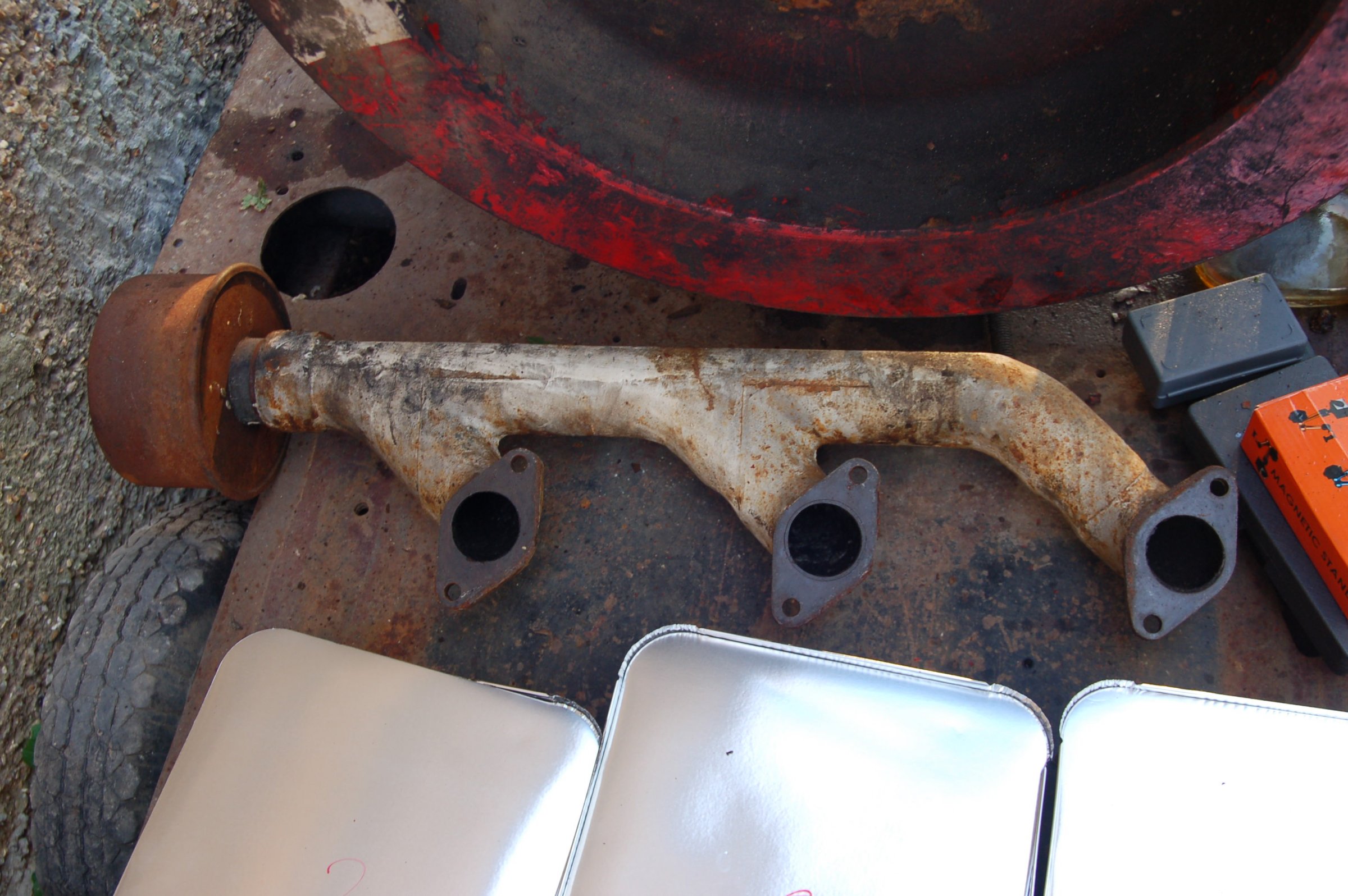

Okay, time for an update on this. We started stripping down engine #2 in earnest yesterday; have got the injectors out and fuel pump off which we will probably just send over to Peter Slater, manifolds etc off, one head off, and one big end opened up. We haven't been able to shift the rocker shafts on the other two heads yet, nor the gudgeon pin on the accessible piston. We will need to come back with superior force - suggestions welcome. This is the state of the bearing surfaces: The crank journal measures up at exactly 0.020" undersize. Same measurement horizontally, vertically and diagonally. I'm guessing it has been ground down to that, fitted with an 0.020" undersize shell and then seen negligible wear since. Again, it looks like we may have got very lucky with this bottom end. What I really don't understand is: if the bearing work was done not many hours ago, why did someone go to all that effort and not give the block a good general cleanup at the same time? There is thick layer of what looks like limescale around the port connecting over to the silencer, and dense mud and rust piled so deep in the block that water doesn't flow out with the drain tap opened, even with substantial poking. Feeling around with a screwdriver it seems inches deep in there. Few more photos of other removed bits - intake manifold: Silencer and exhaust manifold: We were pleased to find this troublesome bit in far better condition than our existing one on engine #1: Injectors - the one on the left is different to the other two, it has a sort of domed nut on the top that prevents the clamp plate being removed. Is this an earlier / later type? State of the nozzles: The removed head: Fuel pump: Piston (the bottom ring broke when it slipped back and hit the cylinder rim):
