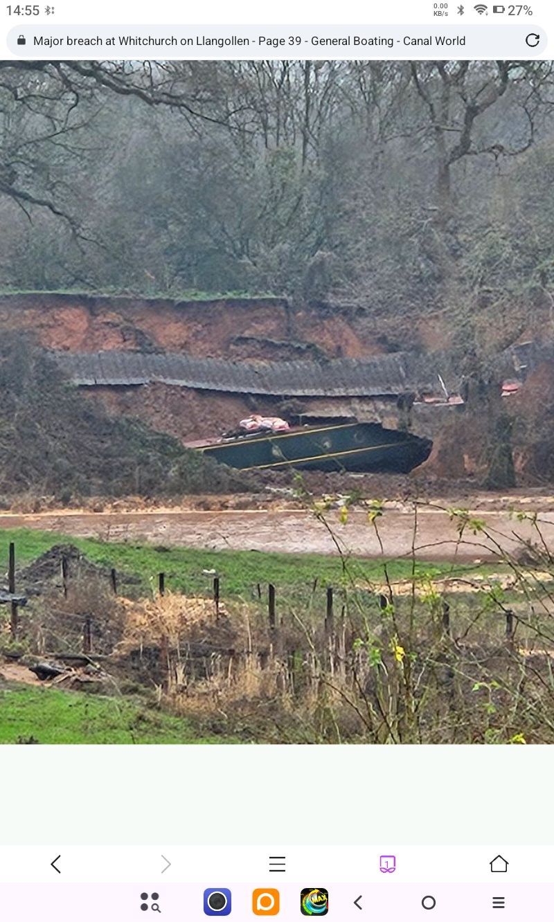

I never knew there were so many armchair experts. Ms Sharman does not want to speculate then she says this " Canal and River Trust chief operating officer Julie Sharman told the BBC this month that engineering teams were still investigating the cause of the failure. “Earth structures are quite complex, and there’s a number of thoughts as to what might be the cause, but I’d rather not speculate,” she said. “When you get a water path through an embankment it unravels as it goes and then it gets quite catastrophic as we can see here and the damage is significant.” That sounds exactly like the 'piping' effect described in an earlier post. Best not to speculate eh ! I think she knows what happened here. Slightly awkward for the Trust to acknowledge that there was a leak through the piling on the towpath which caused a known phenomenon which destroys embankments that anyone with an internet connection can find out about. The words 'water path through an embankment' are not ambiguous.
Recovering the Boats was high profile. There was even a crowdfunder for the owners which raised a hundred grand. Rebuilding the embankment is boring. If there was a crowdfunder for this it would raise a fraction of that if anything. It's just how it works. A spectacular failure gets attention so the management can spend it on expensive contractors "Looks we are sorting out this problem you can see that" Nobody else except a few enthusiasts cares about all the maintenance failures which cause these outcomes because it does not generate news stories. It's just how it is. Exactly the same thing happened on the Thames after the big floods in 2024. Orange contractor tugs and a 360 collecting debris from weirs. All very visible and important looking. Everyone could see something was being done. However they left the most critical hazard right until the end for convenience then failed to lift it on the planned day and it contributed to a fatal accident. I am quite interested about whether the water board will have an input. Over time the importance of canals for water transfer will become more obvious. Navigation will be a secondary function. Not newts but there are some protected burrowing animals. Careful eviction may be needed.

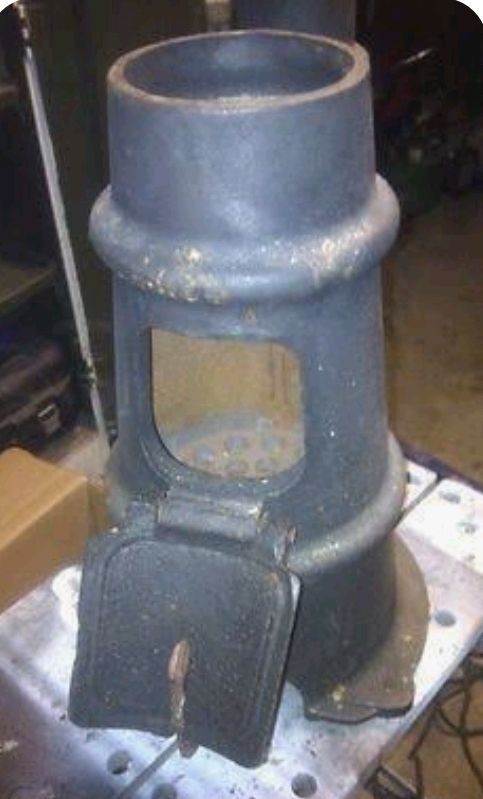

Although my custom made welded steel fire is ten times better I really like the old railway stoves. I think that top was made for a kettle like the one being discussed. So it does not fall off while train is moving. It is not a flat hot plate but I don't think it has a removable plate either. -
I'm surprised they are happy with the drones. To be fair they seem to be out of the way of the operational staff. Drone accidents are not unknown. I wonder if the other vessel is going to be done at night. A nice lighting tower is ready to be used about now.
Yes. And if it performing a structural role you definitely don't use the thin stuff. Different story on a level canal but up in the air it is obviously not a good plan. Apart from anything else it adds weight to the top. If those piles were 30ft long the collapse would have been almost impossible. I wonder who is in there Or is that the other end of the 'piping' tunnel. Burrowing animal. "always wanted to live there thank god the water has finally gone away this is where the family lived all those years ago"
30ft Larssen piles. The real deal. Often 12mm thick which is going to give it a very long useful life. These cadmiun or zinc plated Mickey mouse piles are 6mm thick if that and clearly not long enough. The type of thing which cowboy contractors sell to riverside house owners and bang in at the end of their gardens. This Mickey mouse rubbish has low structural strength and as is obvious from the pictures it just creates a weakness at the edge of the bank if fitted on an embankment. You can't hammer 8ft consumer grade thin wall piling into a major embankment it's just not appropriate. Unless the priority is to create a short term high public awareness walkable path.
If they are proper long thick type like Larssen piles that is probably alright. These ones are short and thin. So the rust out and also are not long enough to be structurally supportive. They are not at all long as can be seen from the pictures of the sheets on top of the narrowboat. Mickey mouse and I think @Gybe Ho had made a good observation such is that the primary reason for them being installed was for the footpath not the canal integrity. You can see from the size of the narrowboat that these things short sheet piles are rubbish.
