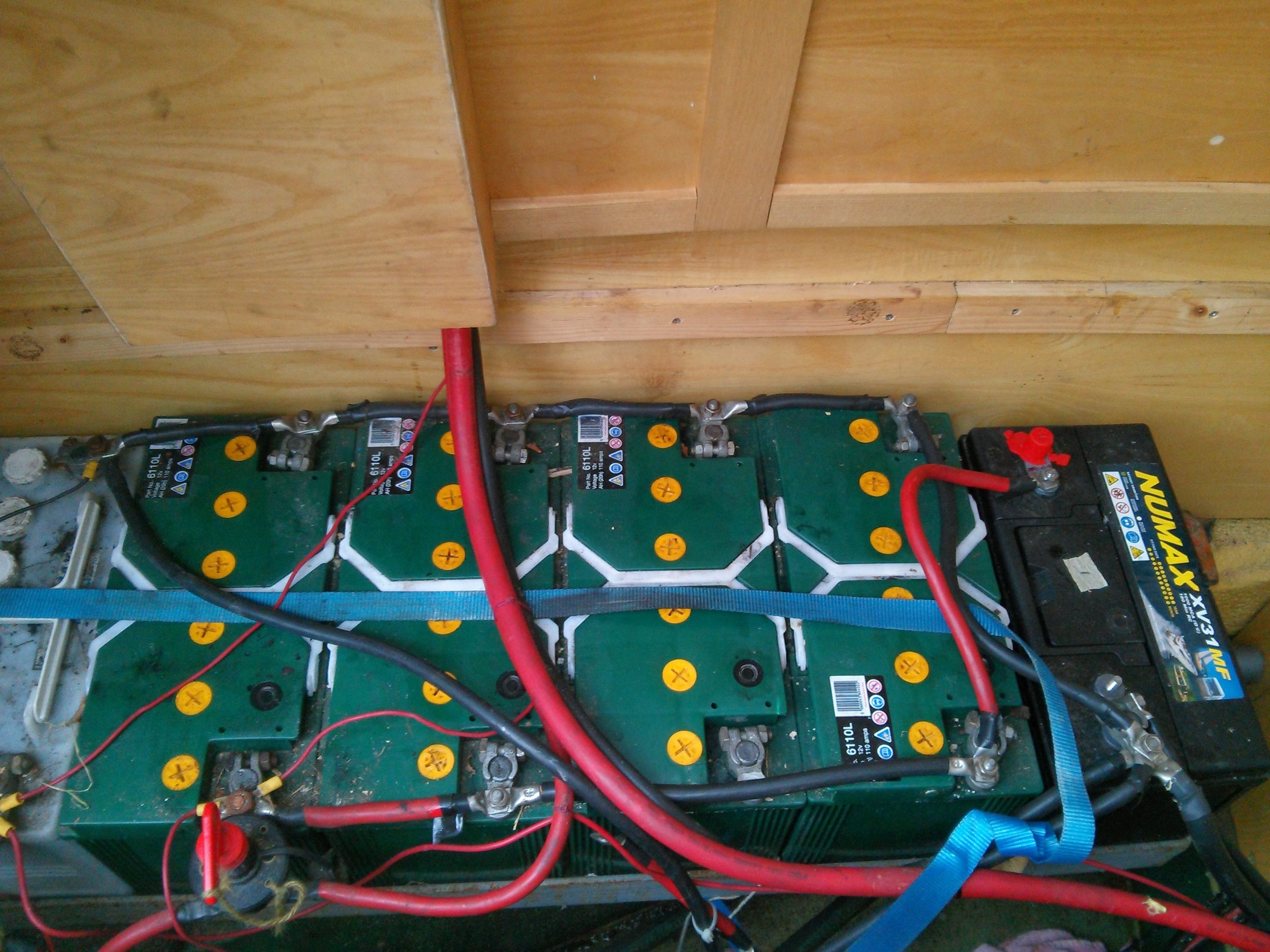

Usually on shore power, probably get out about 4-6 weeks per year. The batts in that pic were knackered, probably already on their way out when I bought the boat 4 years ago & helped by me to finish them off in the month it took me to get to my marina. (The white 1 is the starter battery & fine) Anyway I replaced the domestic bank with 3 cheapo leisure batteries (shore power usage went from £10pw to £5 pw), which I only found out earlier this year from the manufacturer are good for 85 cycles. Well they've lasted 4 years @ 4-6 weeks per year means I've managed to get about 120 cycles out of them. Doesnt include the multiple times I've forgotten to turn the shore power on & was therefore running off the inverter only with things that shouldnt be eg immersion heater microwave washing machine... Well disguised by the 660W of solar that I added. But they are totally shot now. I want at least 600Ah bank, my existing 330Ah isnt big enough. So buying 'cheapo' leisures again I was considering these https://advancedbatterysupplies.co.uk/product/abs-120ah-ampere/ now £100 each but were £120 last time I looked which would have been £600 for 5. So not so cheap. So after seeing this thread these http://solarwindturbinebatteries.co.uk/products-page/new-cells-ipzsepzshpsz-2v-cells/4-pzs-et460-2-volt-460ah-c5-506ah-c10-500ah-c20-565ah-c100-duplicate/ at £105 each for 2000 cycles 670Ah total £630 vs the 'cheapo' leisures for 500 cycles 600Ah total £600 (ok now £500) seems like a no brainer. Just waiting on an answer from them about charging them, I know my solar can do the required voltage, can be programmed up to 17V (660W solar 4 panels, 2 MPPT controllers 30A Tracer BN 3215) But my Mastervolt charger I think max is 14.4V.

Do batteries have to be under the floor? I have room for 5 standard leisure batteries. 330 x 172 x 242 mm. The floor sits just above the isolator. The dimensions of the 670Ah 2V cells from the 2nd place mentioned are 198 x 83 x 695 mm. If I was to put them in the existing tray (in the space of the 3 batteries on the right) they would be sticking up 368 mm above the floor. Now seeing as there is nothing in the way, can I just cut a hole in the floor & then build a wooden box around it?
