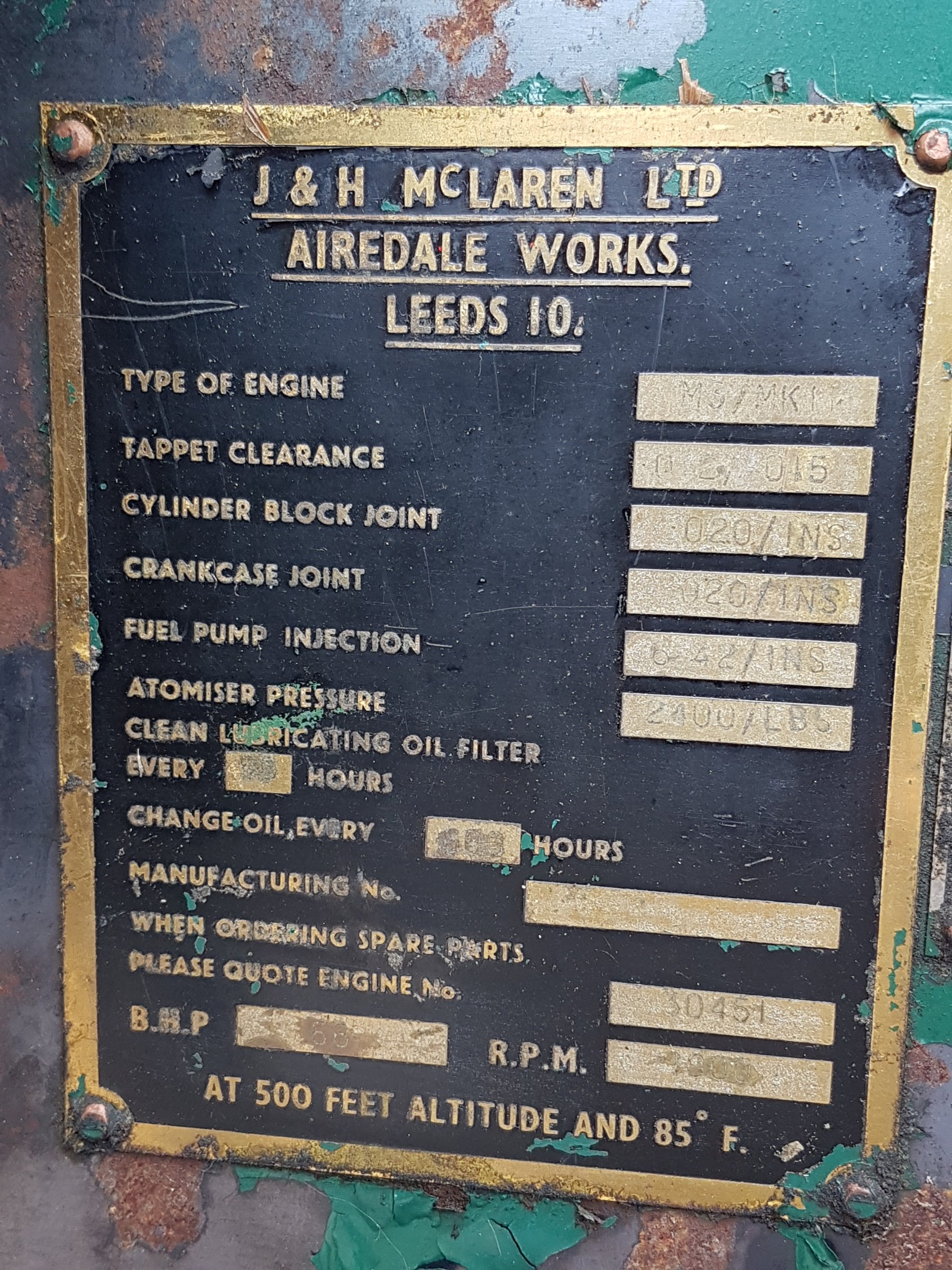

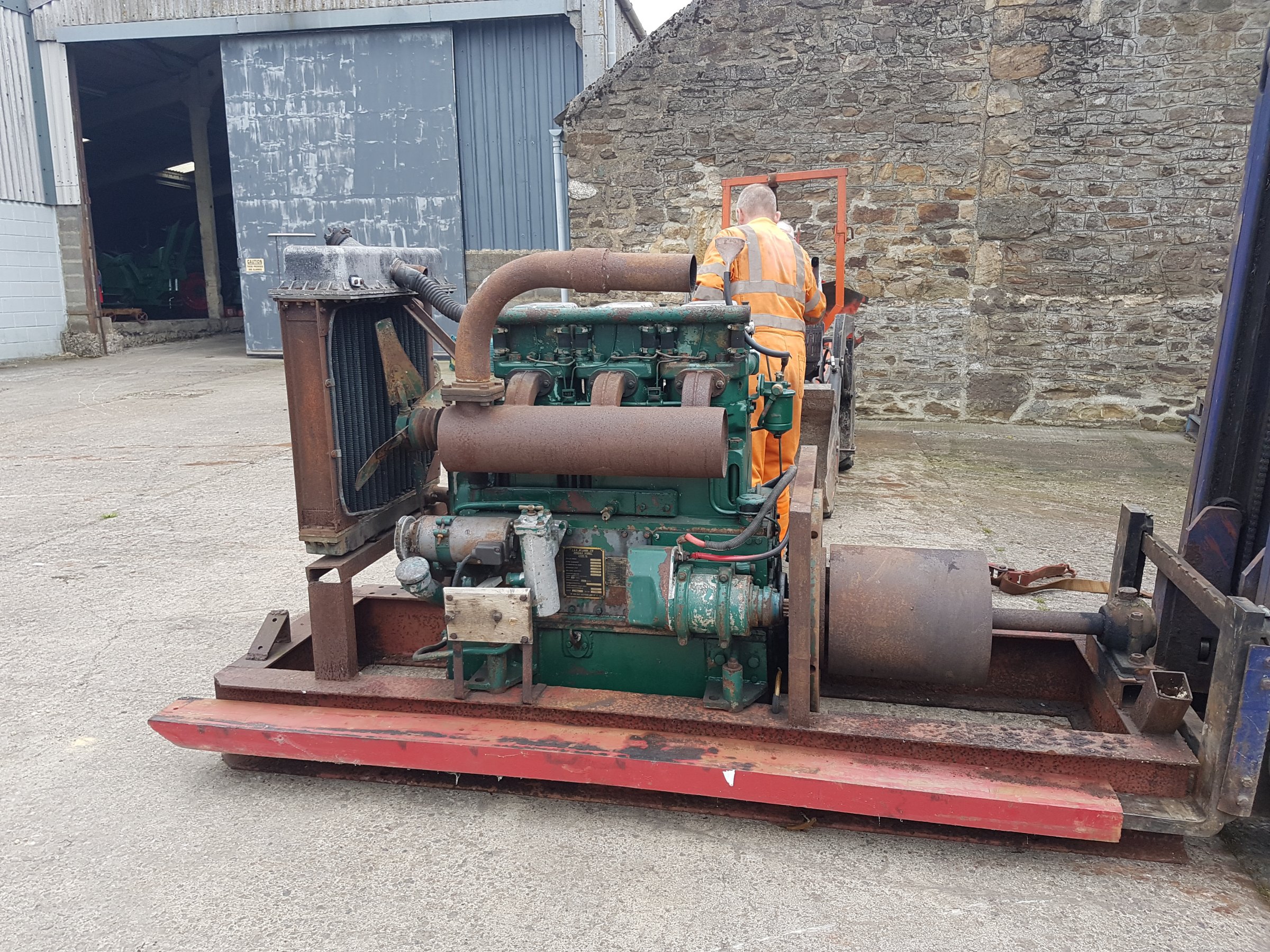

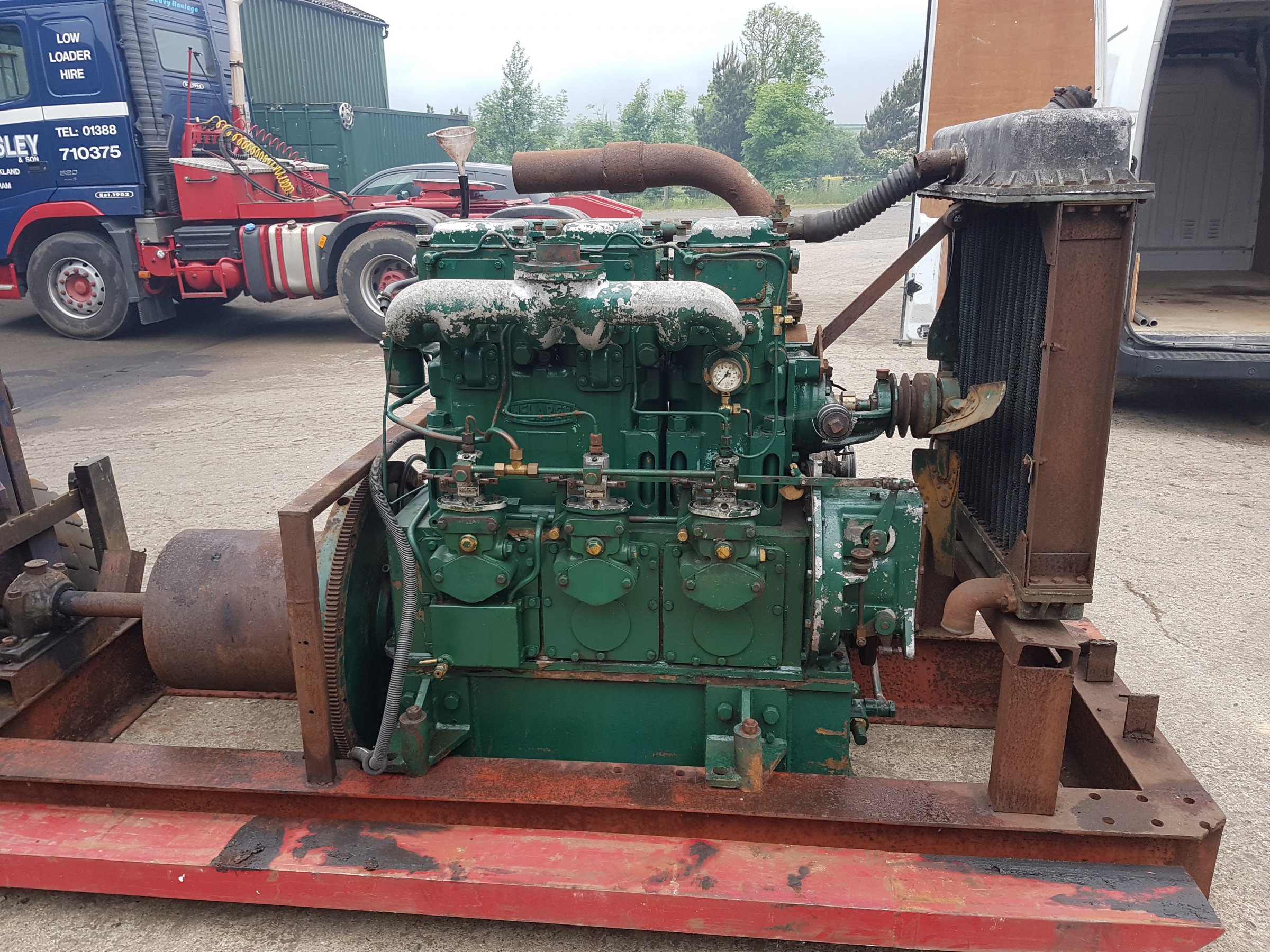

markalistair Posted July 18, 2018 Report Posted July 18, 2018 Good evening, I`m looking for any information about the Maclaren 3 cylinder M3 Mark 2 runs at 66bhp @ 1000rpm. I am trying to date the engine and what it was possibly used for.
steamraiser2 Posted July 18, 2018 Report Posted July 18, 2018 I used to look after a six cylinder one in a locomotive. Reckon it's around 1956/7. Yours is possibly a compressor motor . Seen them in gas plants too
markalistair Posted July 18, 2018 Author Report Posted July 18, 2018 Ok thanks. I have seen 4 cylinder as generators but not this 3. Hope to put in a narrow boat with a Gardner No2 cone drive gearbox.
Athy Posted July 19, 2018 Report Posted July 19, 2018 (edited) A web site called 'Skippy's Random Ramblings' shows a photo of what appears to be an exactly similar M3 Mk. 2 and states that it was built in 1952 and that it used to power a swing bridge on the Manchester Ship Canal. The firm ceased trading in 1959 so that's the latest it could be. McLaren's were, alongside Fowler and Marshall, one of the traction engine manufacturers who turned their hand to internal combustion engines, so perhaps it may have powered a road roller. They did dieselise some steam ploughing engines but these, being larger machines, had six-cylinder engines. Does it go? Edited July 19, 2018 by Athy
BEngo Posted July 19, 2018 Report Posted July 19, 2018 It currently looks to be set up to drive line shafting or agricultural macinery through a wide leather or canvas belt off the drum. I think McLaren were swallowed up by Petter- IIRC the PD series were officially Petter-McLaren engines. Have you tried the stationary engine sites for info? It is also likely that there will be some information and maybe a manual on the Internal Fire website. They also have the Petter Archive. N

markalistair Posted July 19, 2018 Author Report Posted July 19, 2018 Thanks for all the information and thoughts. J H Maclaren where a renowned steam engine manufacturing company and later went into diesel, even supplying Benz with the first diesel engine for a car. The engine runs very well. I tried to put a video on but too large will try to make smaller and try again

markalistair Posted August 20, 2020 Author Report Posted August 20, 2020 Hi like you I too have been away from the site, busy doing other projects. I have been to see this one at Ellesmere port last year, but unfortunately when I went it was not running do to a fault it had developed. I would be interested in a copy of the manual. You can contact me on 07767405680 Mark
