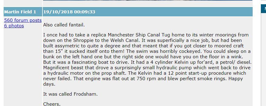

Hi Pat. No, but I have both stripped out all the internals and motored the boat on the shallow Basingstoke and I can say that it steers perfectly and I haven't noted any significant assymetry on the stern. It is quite a fast boat and I suspect the author was going to fast but we have lost a couple of cylinders since then! If you go out of the channel it does pull more to the side more than some others I have steered but I can't see any obvious reason for this - maybe it's to do with the steering position as you have a differnt viewpoint compared to a tiller and the rudder arrangement is slightly different with the fixed forward section.
Hi Mike, I wonder where the 'missing' cylinders got to, they must have been up to no good in the engine room to produce a J4. Possible reasons for pulling to one side  - prop walk, and the longer than average swim combined with the length of the rear deck overhang. The hydraulic hoses are Volvo and designed for the Volvo tipper trucks, they were provided by Uncle Paul who owned Reliance Tankers of Runcorn at the time and ran a fleet of trucks - the truck racing at Donington was great! Cheers, Pat. p.s. what is your new engine?
