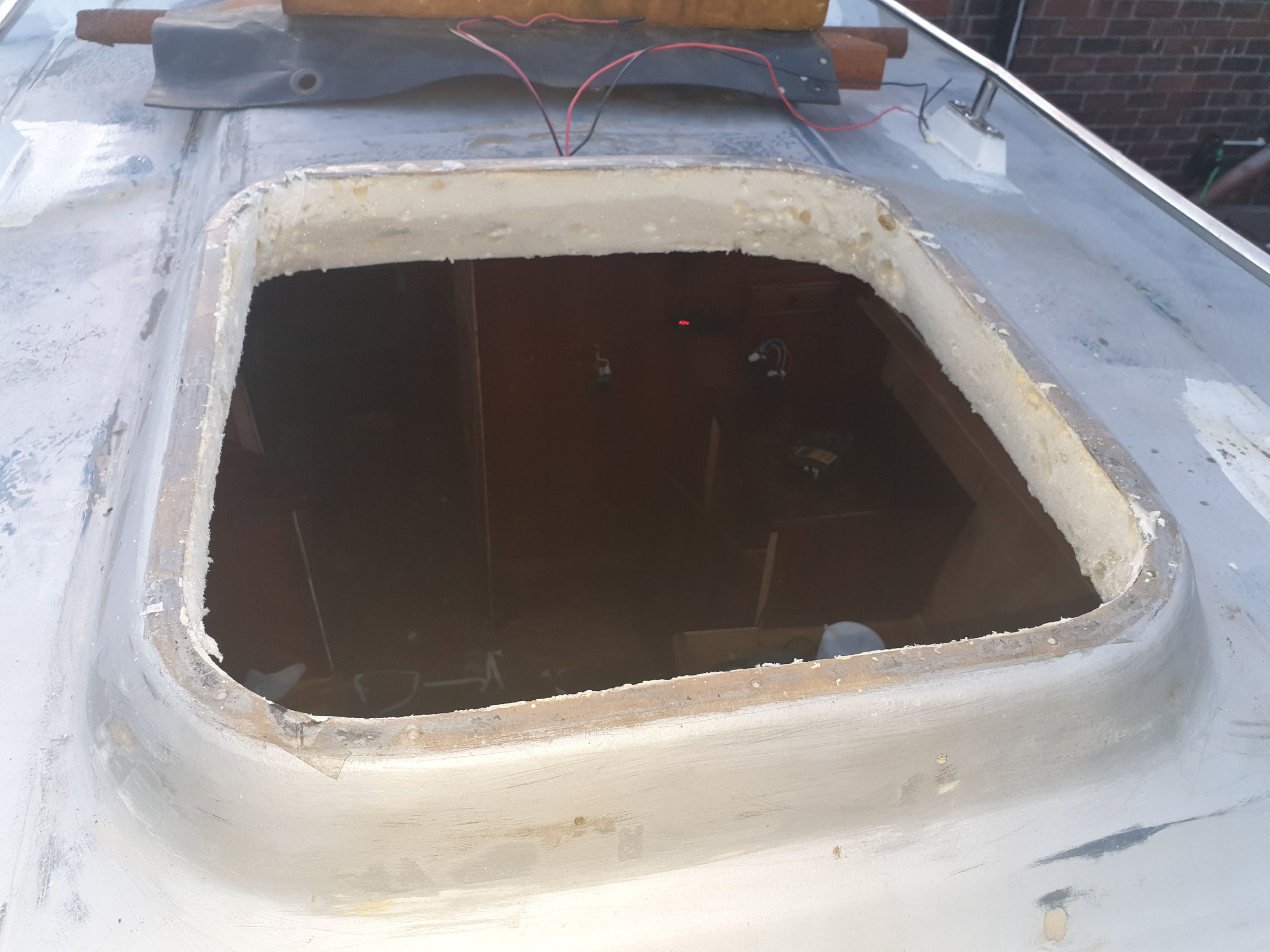

One job i just could not decide on was what to do with he hatch opening. This weekend i decided to just try this idea instead of trimming it with hardwood.
One thing i did wrong is forget to wet the inside of the tunnels that i made from polythene and masking tape to help it set, not easy though if i did to get water to stay on polythene. But it worked out just about as in the end i cut a few slashes in the polythene to let air get in.
I need to trim it more as just did it tonight when i got home to see if it had all set.  few large air pockets but no problem, this is with filling to much and not dampening the `mould`
Fill with expanding foam.
not to much as you can see i got carried away.
Trimmed back a little, need to do a lot more as the hatch bolt need access points and then laminating up.
