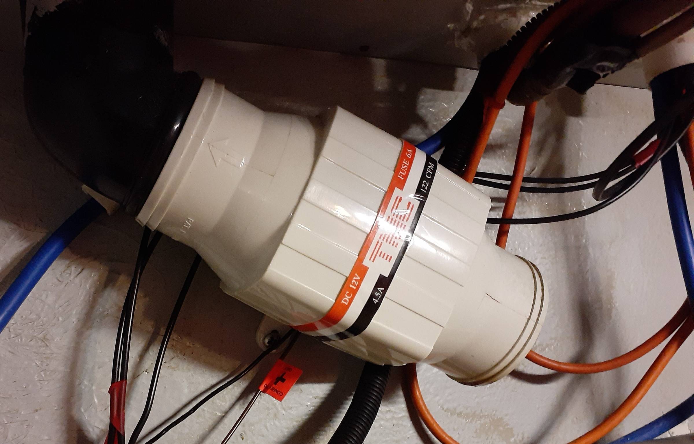

...........is it better to blow or suck

A 'proper' bilge blower (which I don't think you are talking aboutsucks the engine / fuel fumes out if the bilges and blows them down a pipe to the 'outside' before the engine is started.

39 minutes ago, Alan de Enfield said:
I was always told (urban legend?) that it was a bilge blower so the motor and fan were not working in fuel fumes - suck in clean air and clean the bilge rather than extract fuel (especially petrol) fumes past a brushed motor... With the potential for "Bang"
Well, going by mine (I have one over each engine) it 'sucks' the polluted air from the right hand side and blows it out and into the pipe connected  to the outside air (left hand side) and where it fits into the pipe you can see the arrow showing the direction of flow and how to install the 'blower'.
I did say "urban legend"? I can think of other reasons (brushless motors?) why all bets are off, never mind my wild guess's!
