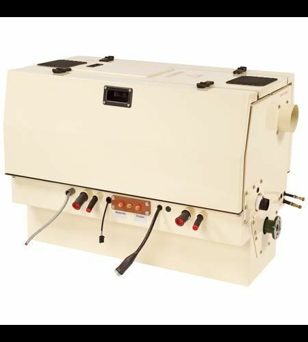

Anyone with a Beta "SuperSilent" acoustic engine enclosure on here?
I've a Beta50S on order and am planning the layout of pipes and cables.
I need to run the calorifier feed and return in flexible heater hose running forward to the main dividing bulkhead, then at 90 degrees along the bulkhead, back aft and then round into the calorifier coil.   Hoping to do those runs in continuous lengths obviously - and hoping therefore that those bends (if made gentle not in a way to collapse the hose) is okay.
And then with regard supporting the hose - is the casing of the acoustic enclosure suitable to affix some supporting rails to into which those hoses can be clipped/tied, tight up against the body of the enclosure?
The alternative is to have some external supports potentially welded in - either coming up off the baseplate to create a sort of shelf or such like.
Be really grateful of any pictures anyone has of their set up using the acoustic housing and routing and support of hoses and cables
On mine all hoses and cables run through the bottom panel.
I'm sure the enclosure would support some clips/light brackets but I'd be hesitant to attach stuff to the outside of it because it would all have to be dismounted to get the sides of the enclosure off, which you'd need to do when servicing.

Here's the a picture of the setup of mine from the side. As you can see all the hoses and cables come out below the left side panel.

Not saying its the right or wrong way but if I was doing the job I wouldn't attach anything to the housing. Personally I would make some sort of support rail and attach to engine beds. Then all pipework could be clipped to this.
If it's a similar enclosure to my Beta Genset then the only bit that's not removable is a 70mm strip at the bottom of each side. I would go with Steve and mount them off the enclosure.
Good stuff - I can put in a support rail that comes off the engine bearers and runs parallel to the housing.
