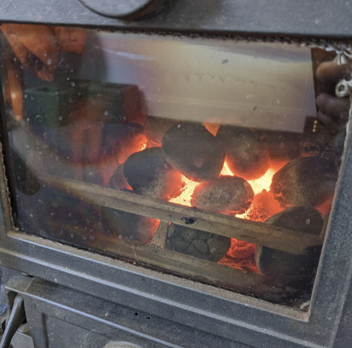

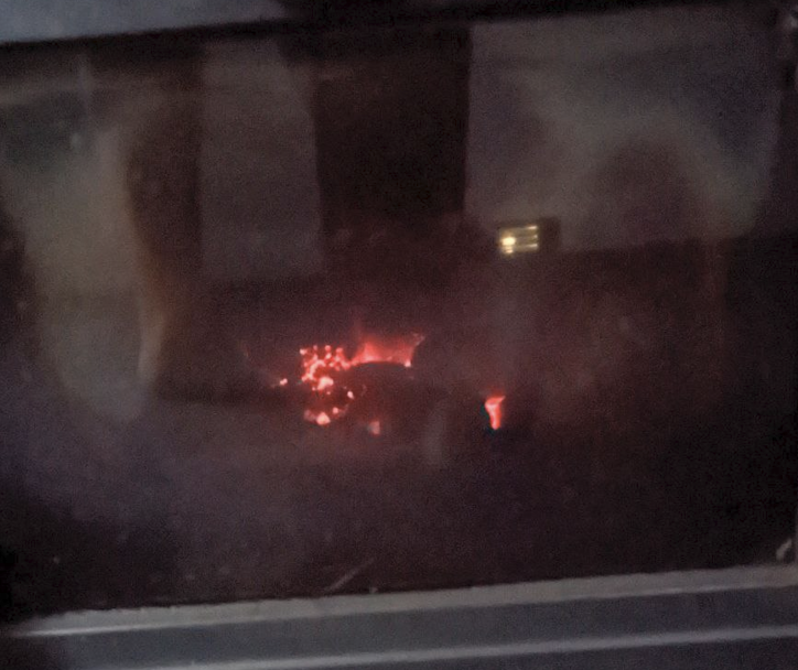

I've attached a picture of the coals 8 hours after it was banked up - hard to get a good photo but it had hot coals, I didn't see if I could coerce it into going again as I wanted to clean the backboiler. Second photo is the stove today with the vent fully open, wondering if that is as expected.
I am starting to think my expectations/thought process was incorrect with the stove? It seems to me I was expecting a "lively" fire like the open fires I was raised around. Is it perhaps that I need to get a thermal mass of quite a lot of hot coals that just sit and radiate heat? If that is the case, perhaps (being thrown off by this bluespot thing?) I have been pushing it too far and the backboiler has been getting too hot? It seems to be making very little noise now.
Second photo looks like it is burning quite fast and after an hour or so like this, the stove itself will be getting pretty hot and heating the boat very effectively.
