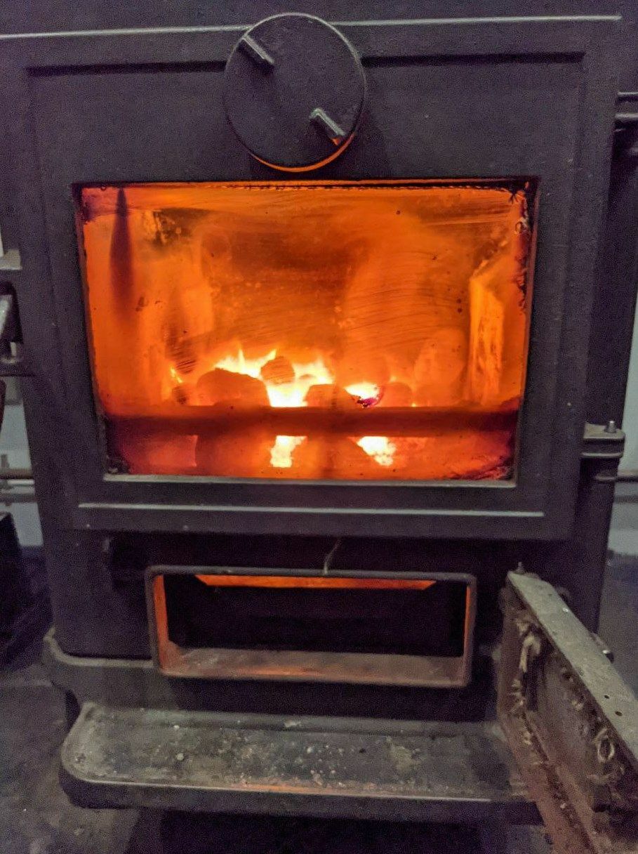

Now that the weather is turning chillier, I am using my stove (Morso Squirrel) properly for the first time. It's generally going okay! I had a few questions that I can't seem to find the answers to, if anyone would be so kind as to help me out...
I find that the only way I can get the temps to a decent level is to open the lower door. Closing it with the airvent fully open dampens the fire down a lot. If I want some decent heat from the fire I have to constantly open and close the door. I have cleaned the stove out (there was a lot of ash around the ash tray). I'm assuming this is perhaps down to something I'm doing wrong?

If burning smokeless, a squirrel should go nicely with the bottom vent opened no more that one turn.
If burning wood. Keep the bottom vent closed and open the top vent open to suit.
A quick blast by opening the bottom door to get it going may be required, but not regularly.
Keep the ash pan level below the bottom of the grate so you don't choke it.

Loading a squirrel fully with smokeless and leaving only the bottom vent open no more than one turn should allow it to run for more than 24 hours.
You may find you need to adjust the air intake depending on the strength of the wind. The stronger the wind, the less air it will require.

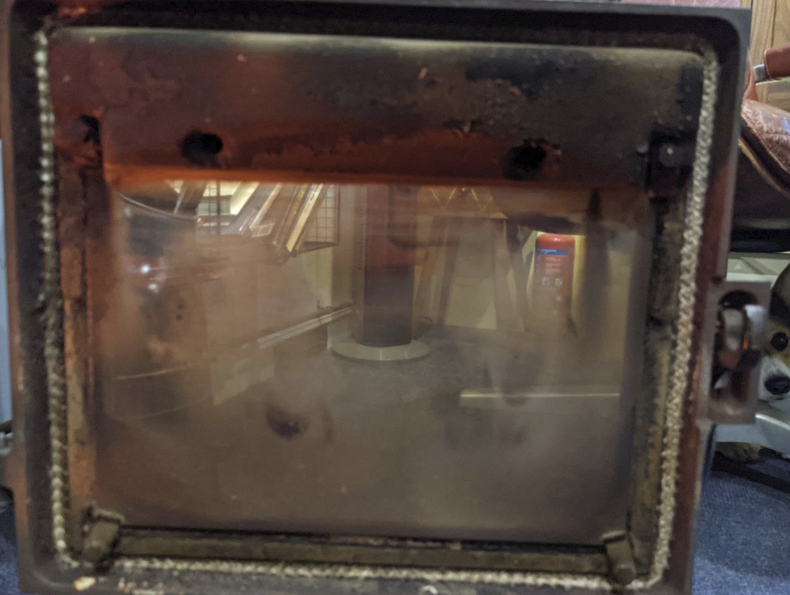

I believe the door seals correctly (although the fire resistant rope on the bottom door has come away a bit, I poked it back in - perhaps it needs replacing). Glass looks okay to me too, I'll include a picture. I had a safety cert done with the survey so I would hope any stove concerns would have been highlighted.

Looks like you haven't much fuel in there.
Fine if you want clean glass but it is very over rated.
Never clean our glass, and leave top vent closed unless burning wood.
Good luck if it's your first winter aboard.
I usually have a bit more in there, but perhaps I do need to load it up a bit more generally

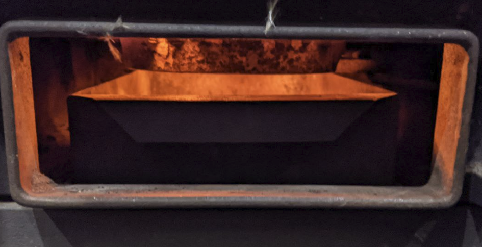

Another thing is how long are you waiting? That photo with it glowing red ought to have the temp inside the boat well up on the 30C  range after a couple of hours. My own Squirrel would keep the boat toasty warm with just a deep red glow but the whole stove takes a couple of hours or more to warm up properly once lit.
If my stove was glowing orange like that I'd bank it up nice and high with more coal and fully close off the bottom air vent then open it about one full turn. Then it would keep the boat comfortably warm and need no more attention for about 24 hours.
It's been a few hours, but I have the hatches and doors open because I like the warm/cold air combo. It was less of a question of the temp of the boat but more control over how vigorous the stove seems to be burning. But I thought there might be a bit of technique problem, I will try loading the coals up when its hot and closing it down and see how it goes. I suspect the backboiler thing might be at play too.

Apparently the later Squirrel stoves come with 2 plates installed above the door. One of which is removed when installing in a boat. Apparently both are left in when installed in a house. If you do a search on here you will find out more hopefully
Will look into it, thanks
