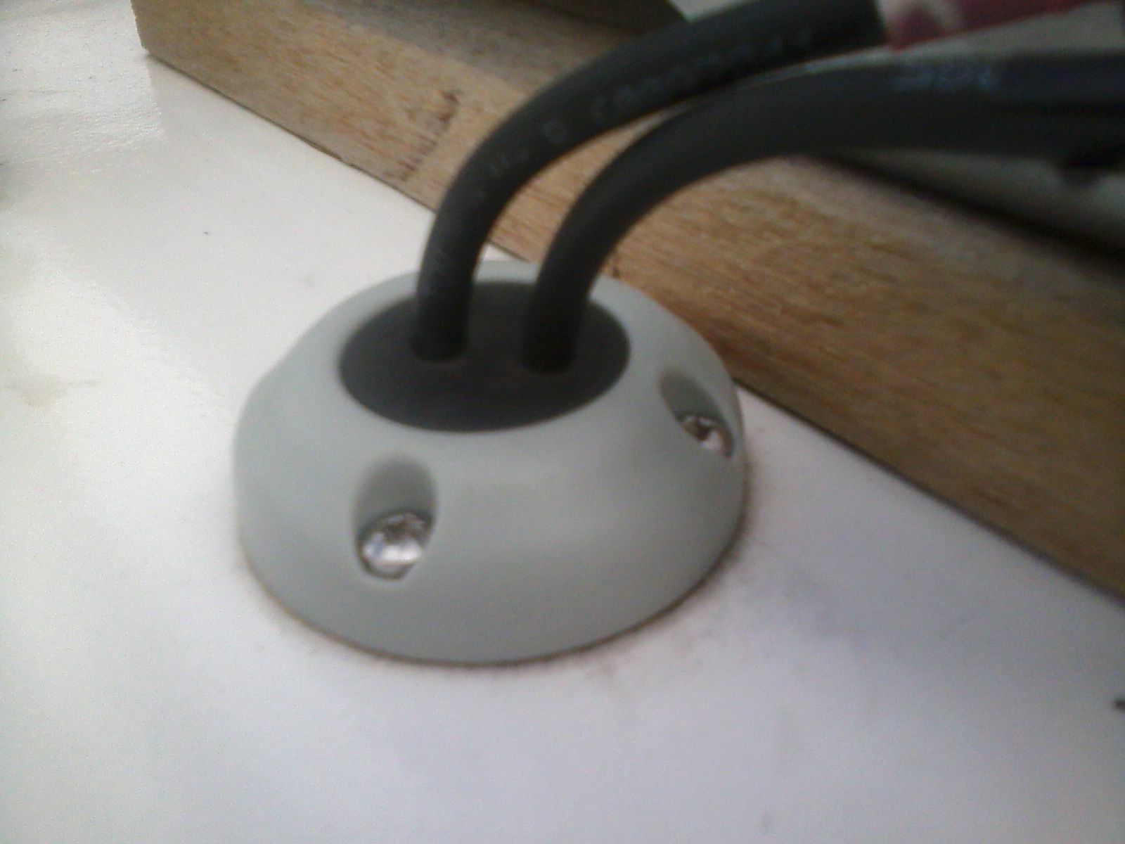

Mine goes in through the hole +w(ith a waterproof gland) where the old radio aerial was just under the panels at the front. Then down the cable tray in the roof lining to the controller. So it's tidy and pretty much invisible. I hate crap lying on the roof 😱
My solar supplier provided a gland box thing which I used to take the cables inside and behind the panelling to the gunnels and then to the controller.
I borrowed a set of electrician's telescopic rods that they use to pull cable through between floors etc. Panels at front of boat, cables fed through a roof gland and then pulled them to the rear of boat using the rods inside the roof void. I had to drill a hole through the rear steel bulkhead to get the rods in and the cable out into the back cabin. But quite a tidy result.
