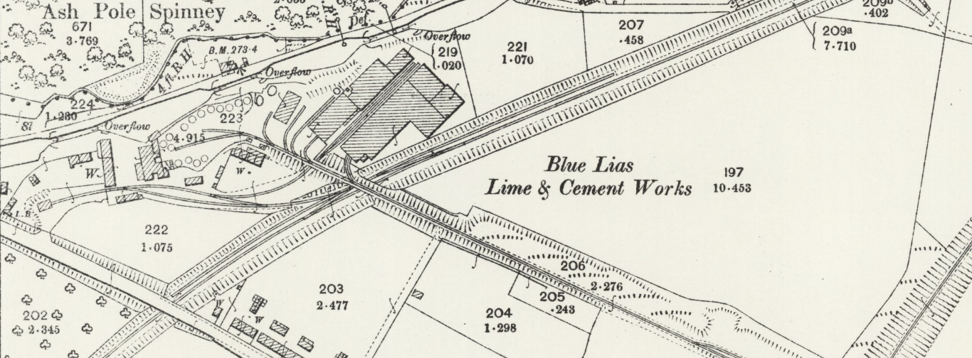

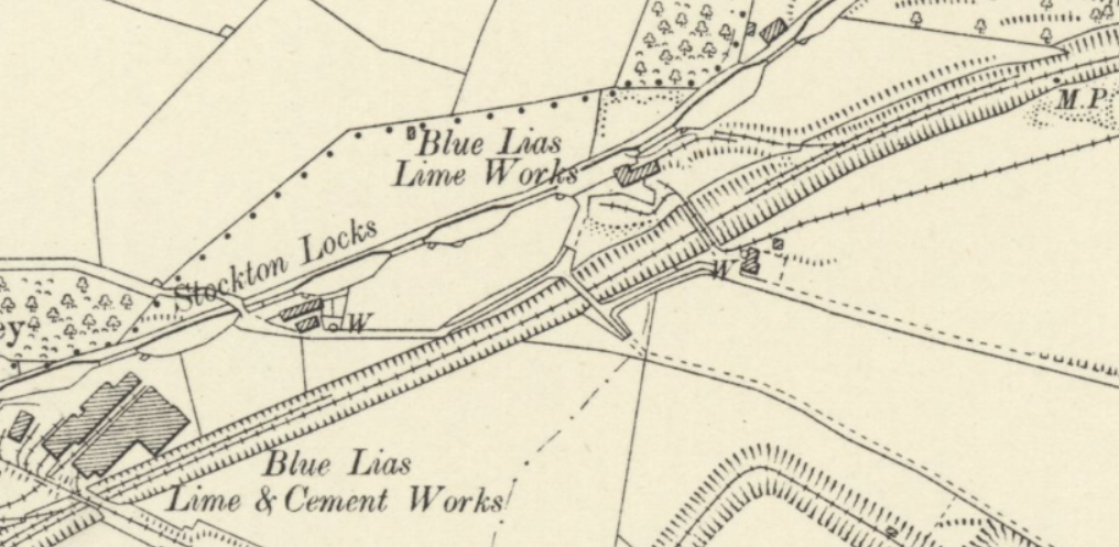

Heartland Posted January 11, 2022 Report Posted January 11, 2022 Can anybody remember the offside group of limekilns placed beside the locks which were part of the Blue Lias Limeworks. They were north of the Bridge beside the Blue Lias Public House. The 1904 Ordnance shows the kilns as a group of circles by the canal served by a tramway. 1 1
Ray T Posted January 11, 2022 Report Posted January 11, 2022 (edited) @Heartland Not very clear but these photo's were taken in February 2021. Locks 10-11. Also the lime works at locks 5-6 Edited January 11, 2022 by Ray T 1
ditchcrawler Posted January 11, 2022 Report Posted January 11, 2022 From View map: Warwickshire XXXIV.SE (includes: Birdingbury; Leamington Hastings; Long Itchingt... - Ordnance Survey Six-inch England and Wales, 1842-1952 (nls.uk)
davidg Posted January 11, 2022 Report Posted January 11, 2022 (edited) The ones by the Blue Lias bridge were Greaves, Bull & Lakin. If I can find it I have a pre-widening photo of the bottom lock taken off the bridge which shows the kilns. And now I've found my notes the works up the flight in Ray's photo was Griffin's. I can't find the reference at the moment but the railway siding at Griffin's was used to tranship some of the output of Napton brickworks from boat to rail for onward transport. Edited January 11, 2022 by davidg

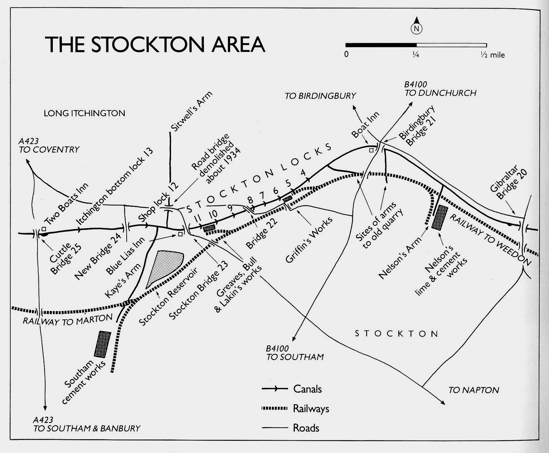

Heartland Posted January 17, 2022 Author Report Posted January 17, 2022 Alan Faulkners map as published in Warwick Canals shows the related limeworks and thier ownership 1
